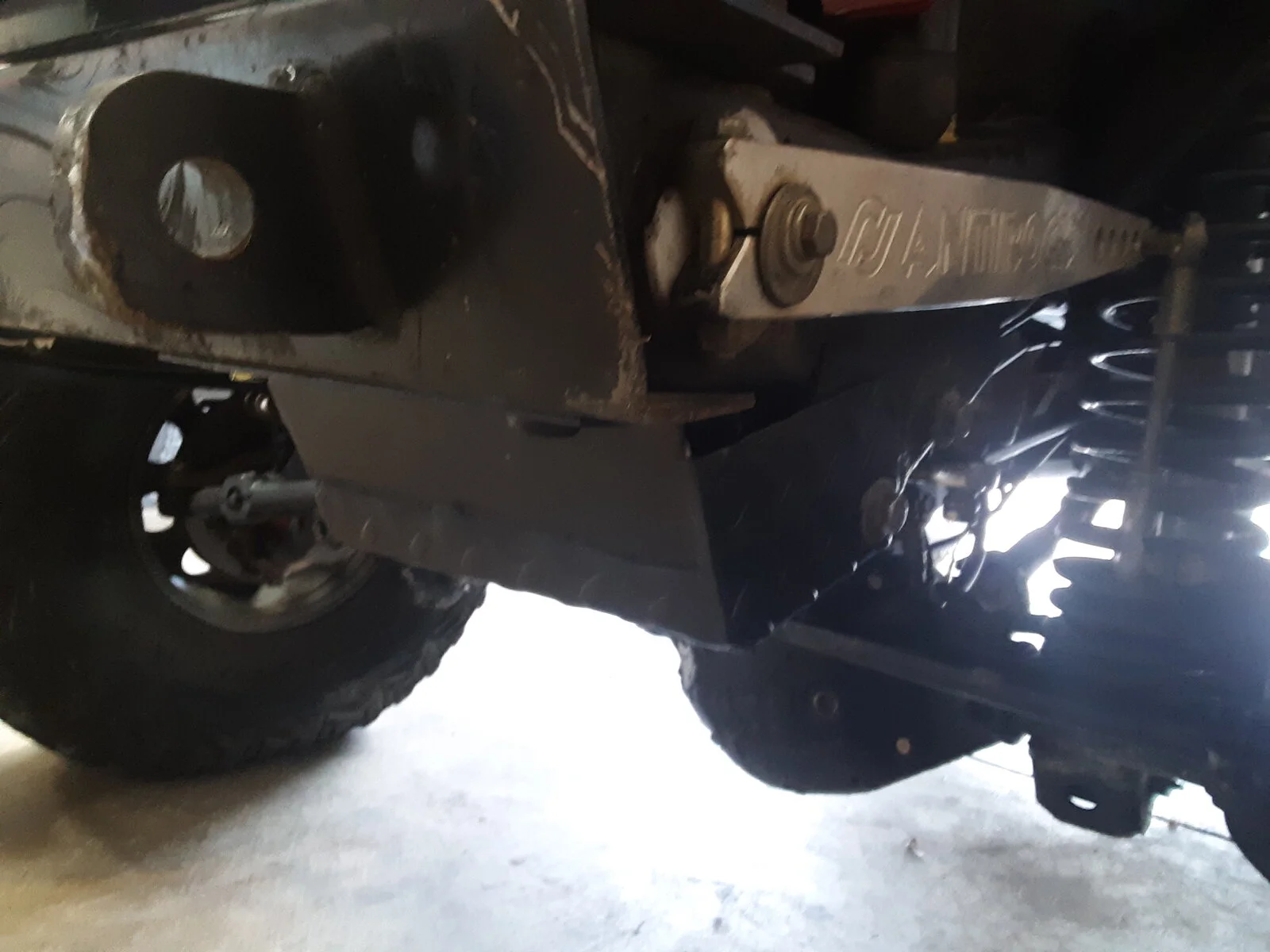

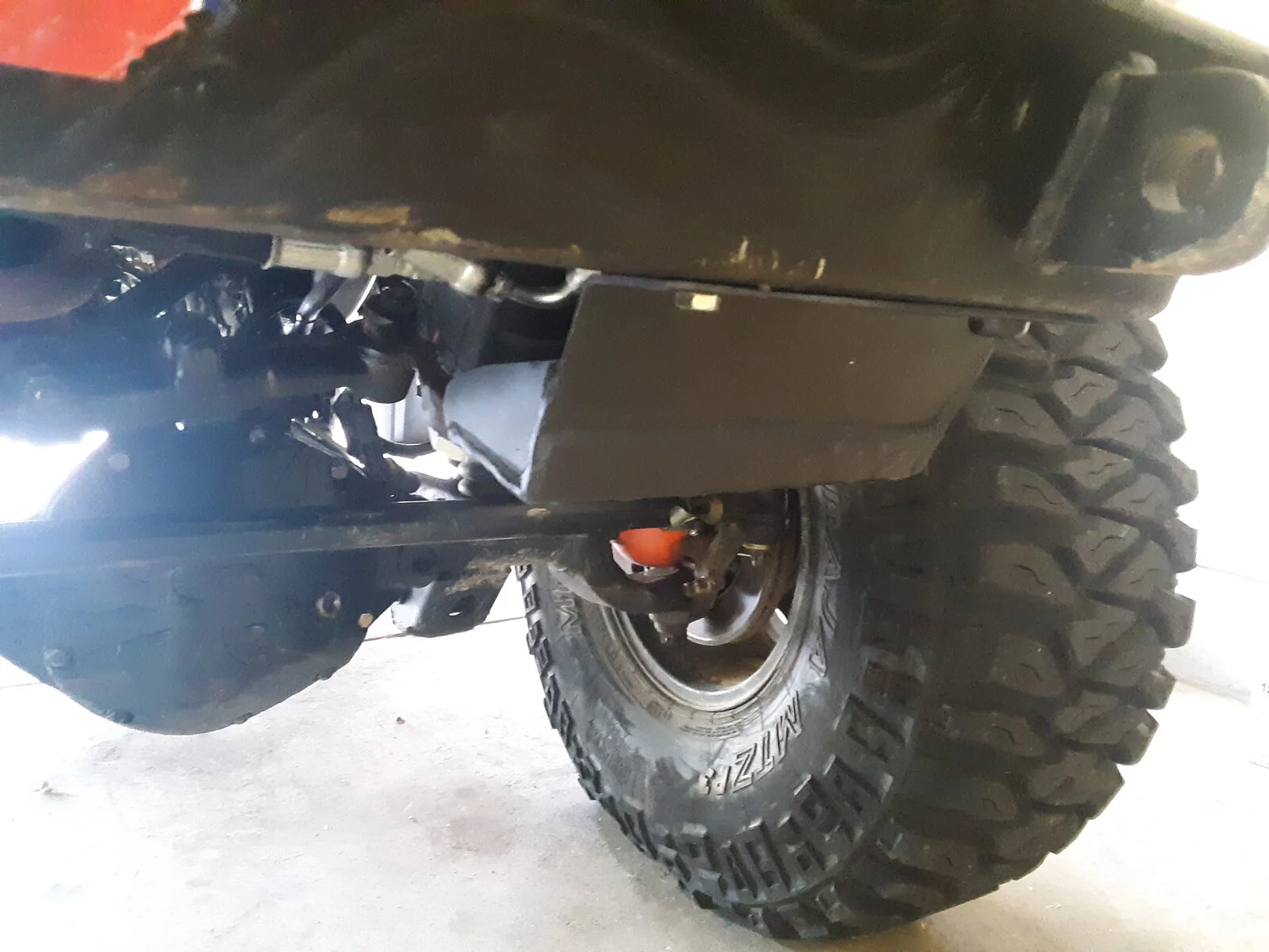

My steering box has taken a few good hits in the past, so I fabbed up a skid out of some scrap I had laying around. I never liked the idea of having a skid hanging down but I got it as tight as I could against the box with a little gap to allow some deflection without making contact. We will see how it goes in the rocks.

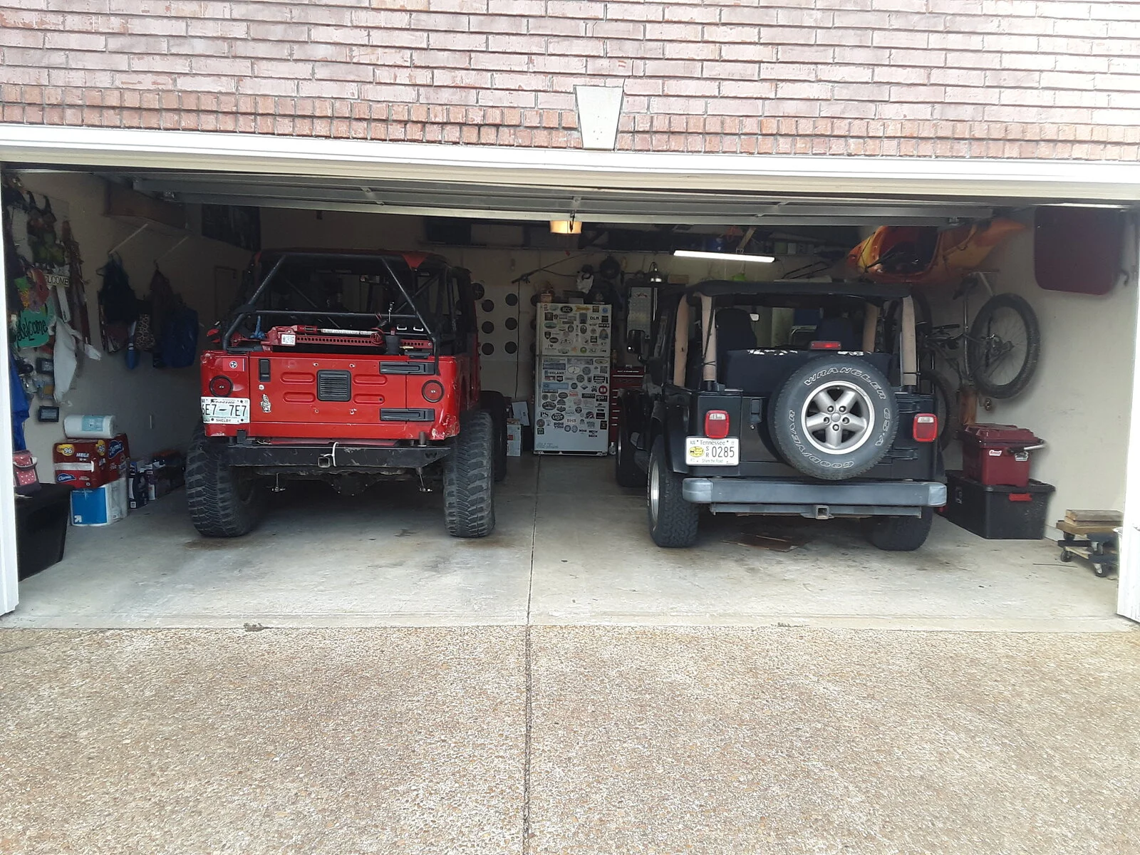

Wife wasn't home so I pulled my jeep into the garage to do a few things before loading it onto trailer. When I was walking back up driveway I noted that both TJs were side by side in same garage (probably for first time).
Pretty sure if I had two TJs to put in the garage, I'd never have to worry about my wife parking in there again...

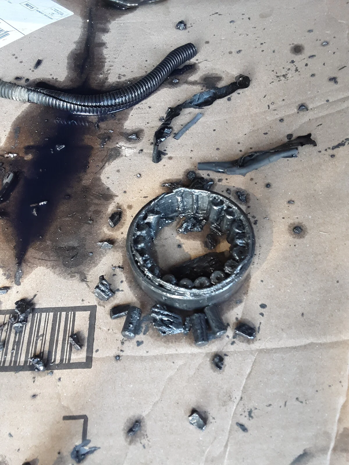

Unfortunately, the broken shaft did a good bit of damage to the locker and the carrier bearing. Fortunately, I was able to get the carrier out and get the broken shaft piece out and worst case if Eaton doesn't have the locker cap available, I should be able to clean it up and still get a bearing to press on. The cap bolts that hold the locker cap on, also had backed out again and were damaged.

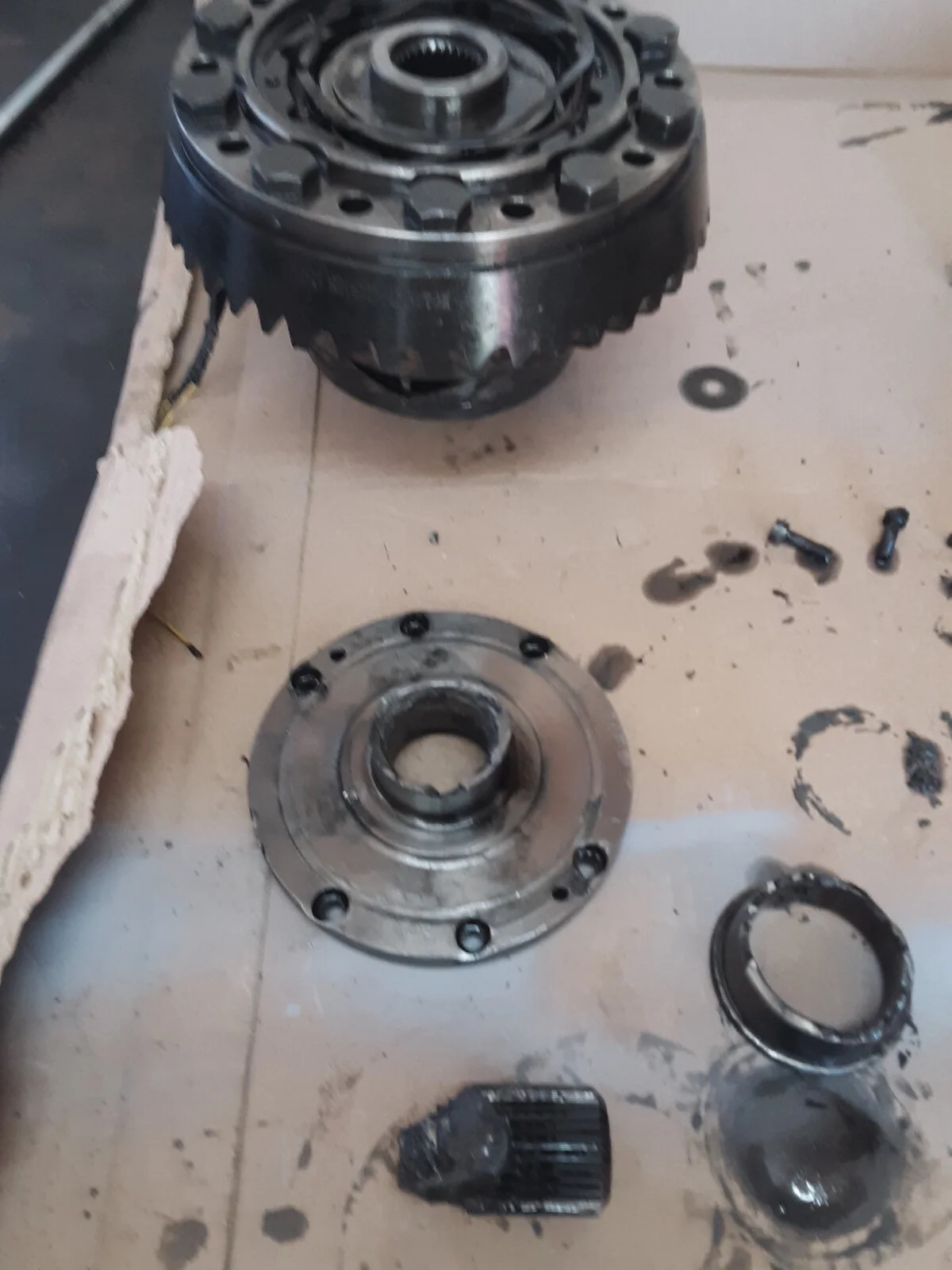

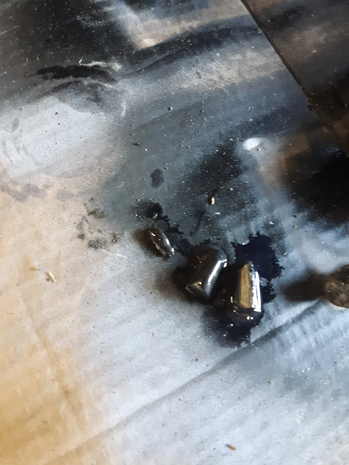

Both shafts were still connected so I know the shafts weren't broken and when I opened up the diff cover I found two big pieces of metal (teeth) stuck to the magnet (luckily). I actually had to remove the magnetic plug to get the pieces out.
Further inspection and it had to be from the spiders in the locker (it is a stock rubicon locker). So I removed the carrier and the ring gear and sure enough the spiders were damaged. unfortunately, there is no longer parts available for the stock rubicon locker so I guess i am going to have to go either elocker or possibly a grizzly or detroit.

Both shafts were still connected so I know the shafts were broken and when I opened up the diff cover I found two big pieces of metal (teeth) stuck to the magnet (luckily). I actually had to remove the magnetic plug to get the pieces out.
