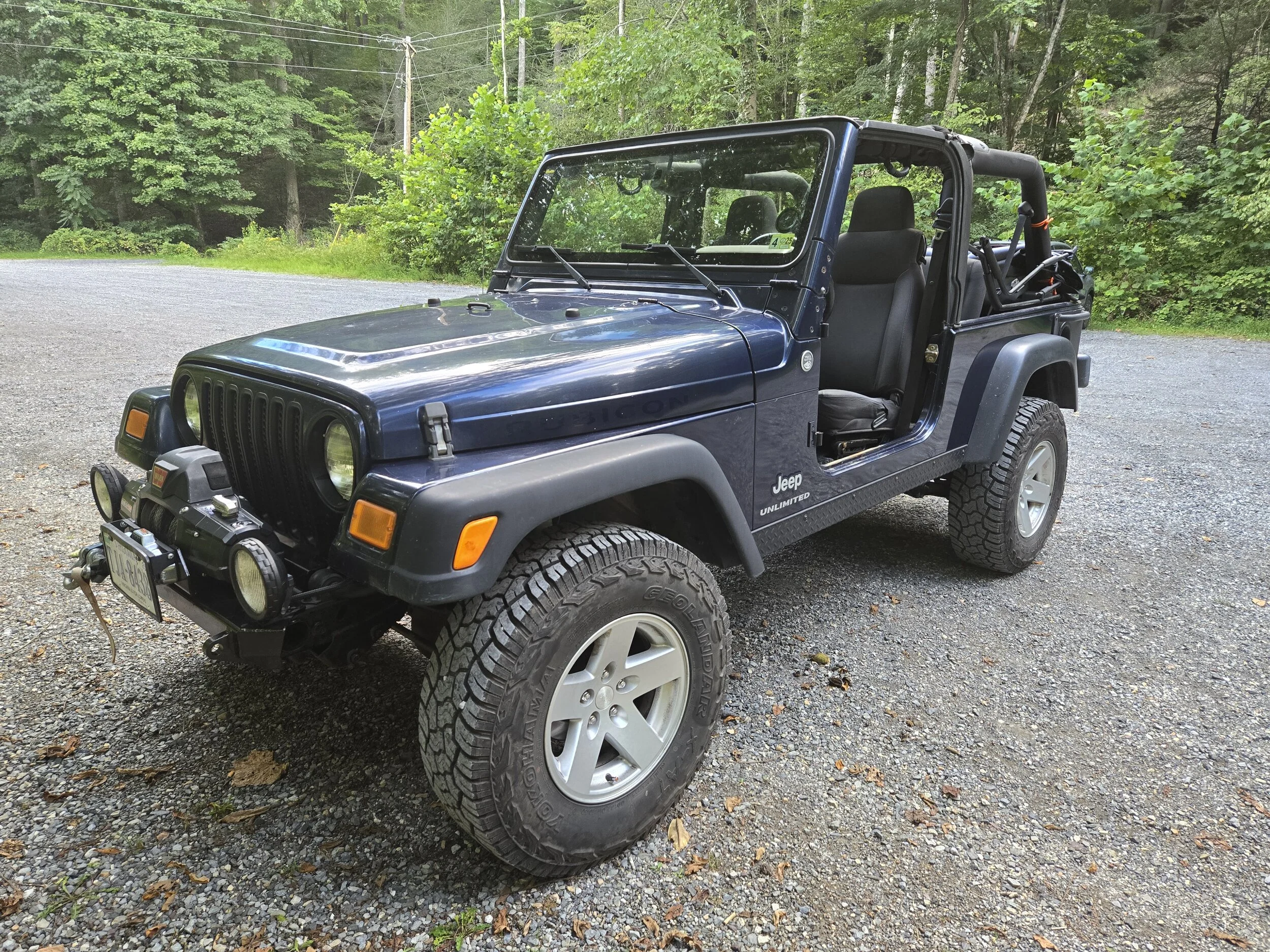

I've always wanted a Jeep. As a kid it was ogling CJs and old Willys Jeeps and craving the freedom and wind in my hair that came with them. I've owned a few different 4WDs over the years including a 1998 XJ, a 1984 K5 Blazer, and currently a 2007 Xterra but an open top Jeep has never panned out for me.
As my kids have gotten older, they prefer to stay home for my adventures so the constant need to seat 5 has all but gone away. My pickup is usually chosen for family trips thanks to the room and cargo capacity so I recently told my wife that it was time for us to get a Jeep. She didn't even hesitate to say "go for it" and as luck would have it, this popped up on FB 2 days later.
My goal is a formidable DD and wheeler. The story I've always told was a long arm kit and 35s and have a do-anything Jeep so I've got a lot of studying to do to accomplish that.

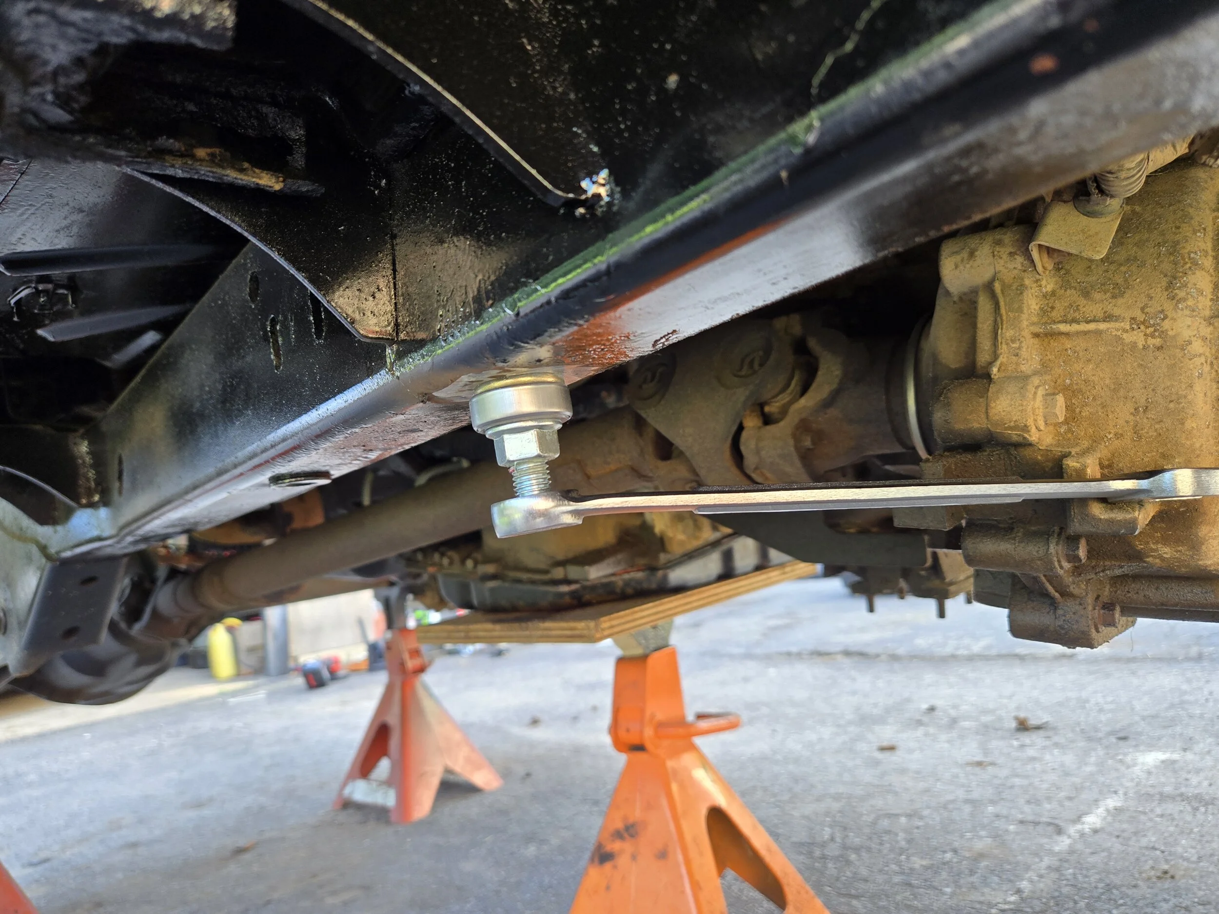

Before quitting for the night, I wanted to get the worn out heim off the track bar. I couldn't get the jam nut loose so I decided to pull it off. Well, things went downhill fast when the head snapped off the bolt on the axle end. Then out came the Sawzall and a constant 20min of my knuckles being beaten against the ground began.
Finally, with the bar out, I attempted to loosen the nut again and only succeeded in rounding the flats off. Disgusted, I called it quits for the night. Now I'm trying to decide if it's worth it to rebuild this old RE bar or buy a new JKS bar with serviceable joint.

Managed to get the old RE track bar torn down. I ordered a replacement heim and jam nut for it and I'm going to get a set of bushings after work. It's not a great bar but it'll let me get it back on the road for now till I decide what direction I'm going to take with the Jeep.

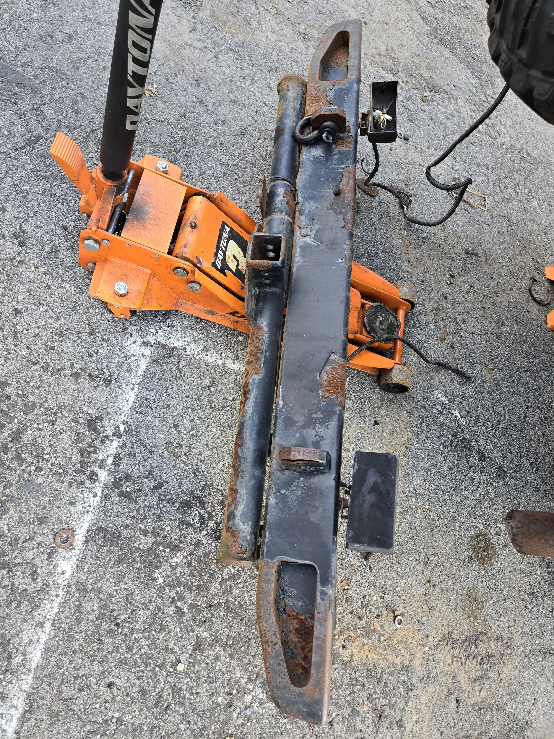

This evening after work I set to getting the rusty old rear bumper off. The two bolts on the side of the frame had to be cut because the flag nuts were just spinning inside the frame.
The two bolts on the back of the frame were missing as well and the two bolts up through the bottom were seized.
I borrowed a Venom induction heater from a friend and after heating up the stuck bolts, a breaker bar easily freed them enough for my Milwaukee impact to zip them out.
Any idea what bumper this is/was?

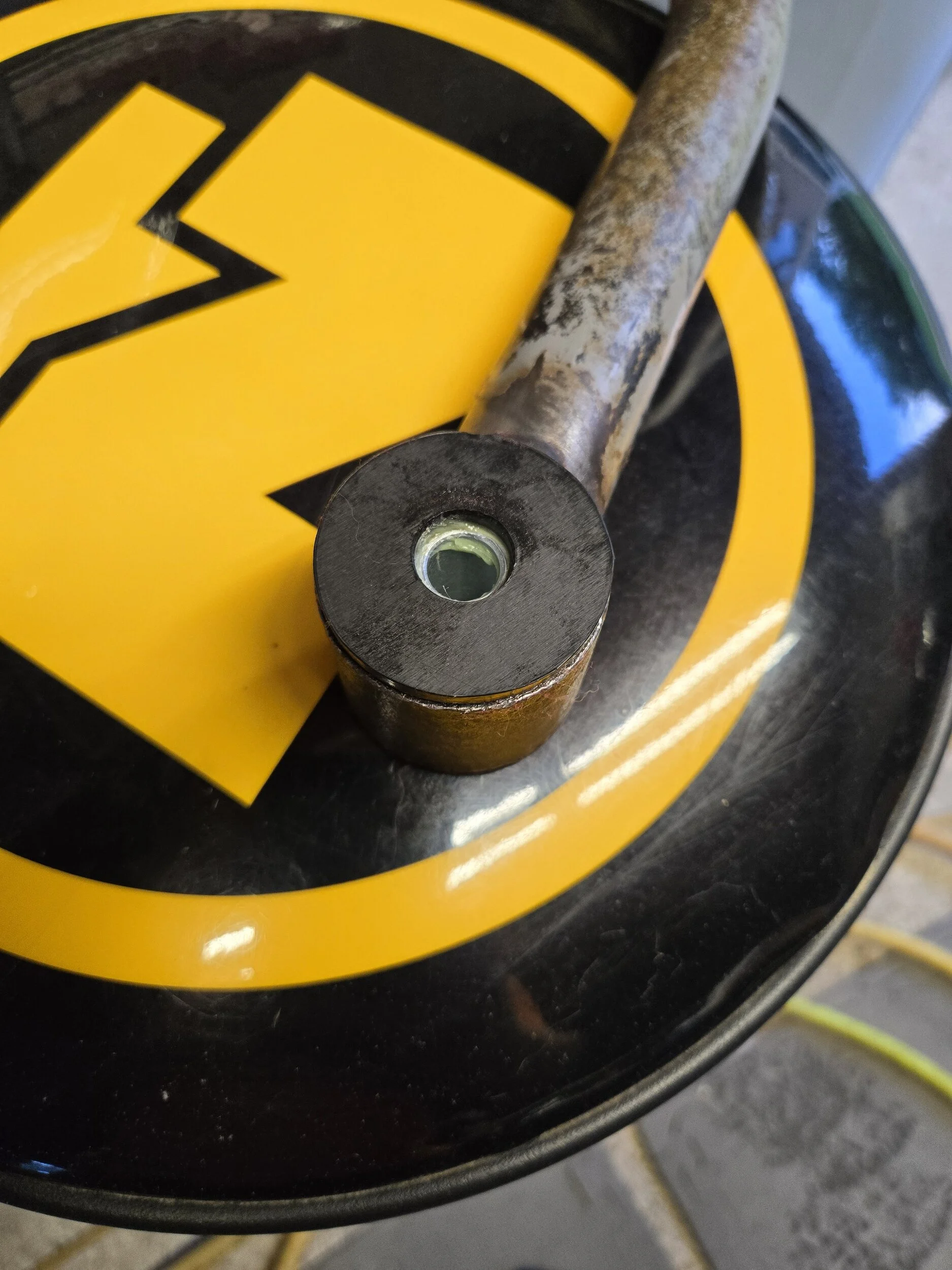

Used my buddy's press to push the new OE style bushings into the Rubicon Express track bar. We had to push both bushing halves into the bar then press the sleeve in. The OE bushing is larger than what the RE bar requires so it's pretty tight in there. There shouldn't be much movement.
I'll use a socket to center the sleeve and sand down the bushings to the width to fit the bracket before I install it.

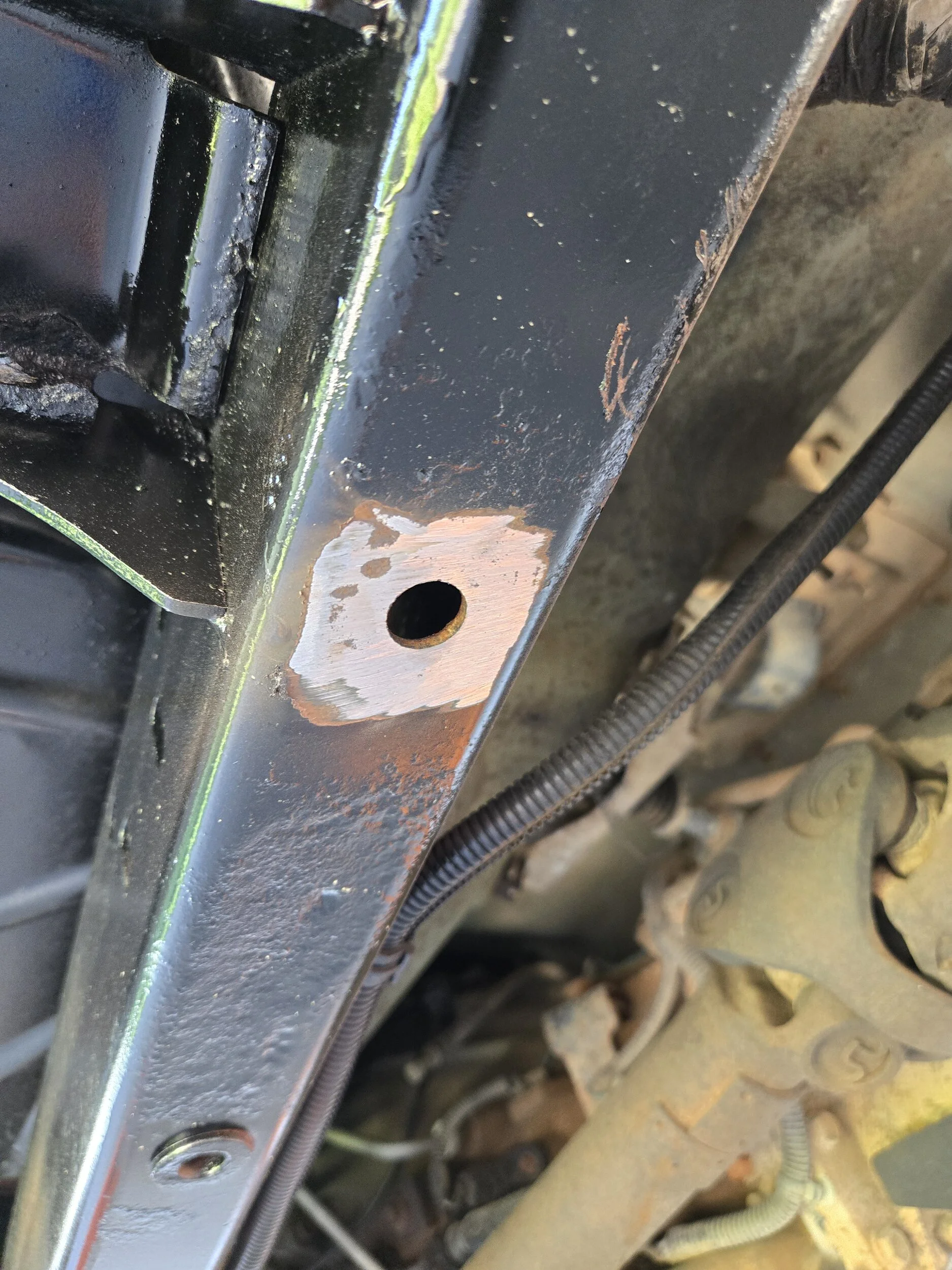

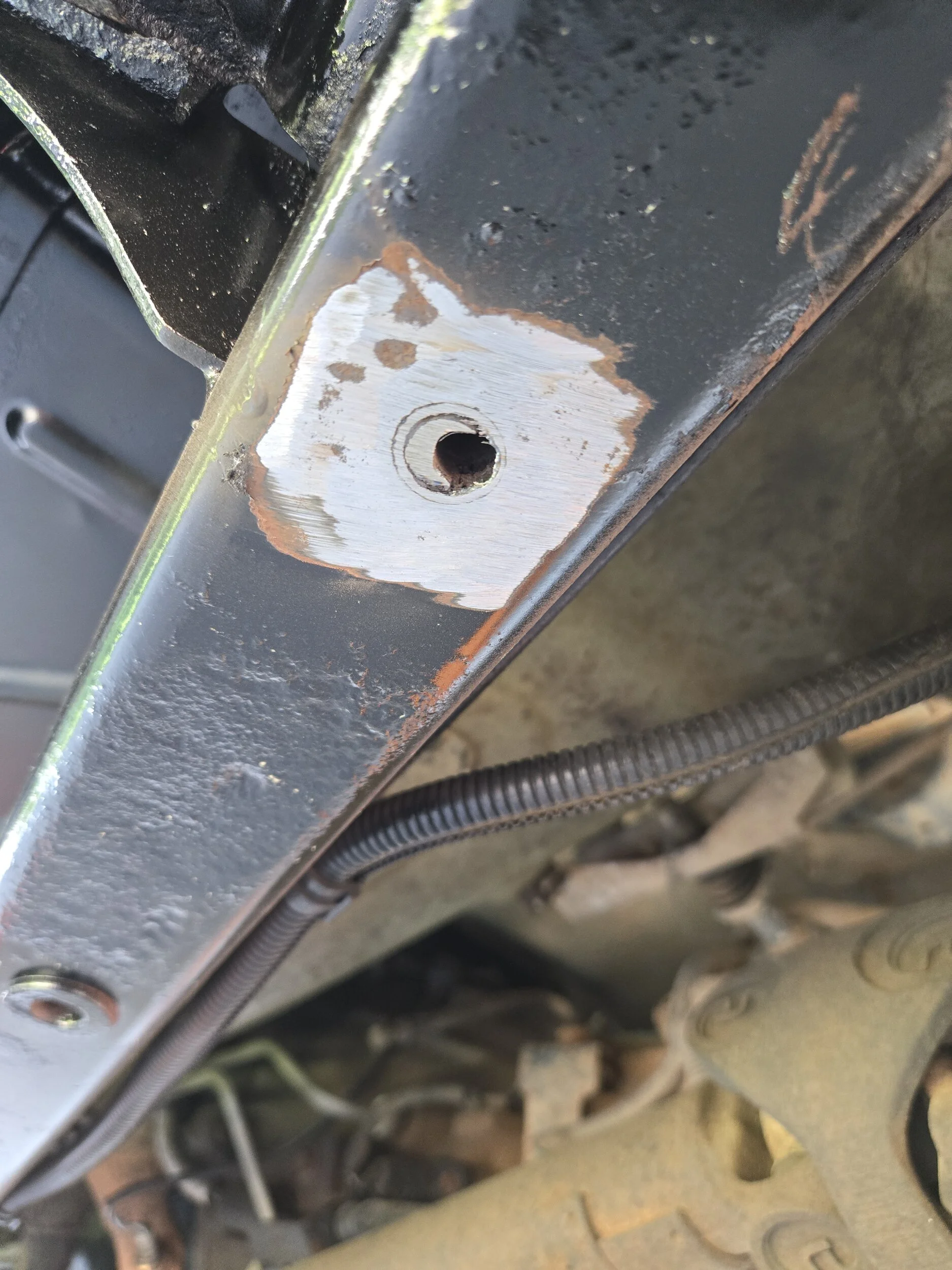

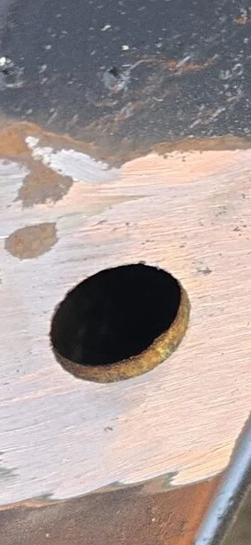

A pretty day off work to relax? We can't have that nite can we. Just finished pressure washing under the rear of the tub and front fender wells. They should be ready for a heavy coat of Rustoleum as soon as it's all dry.
Remembered to put my swimming trunks on before dragging out the pressure washer this time.
Reactions: FarFire70
Have you scoped the inside of the frame? Looks like there is a layer of rust delamination at the top of the hole.
There's some rust in there and I'm not completely sure what to do to remedy it.
My first thought is what we did on the farm for all our equipment. Mix 50/50 kerosene and used motor oil and coat it with a pump sprayer regularly.
Clean all the debris out of the frame, plug the holes in the bottom of the frame, fill frame rails with Ospho or Rustoleum Rust Dissolver and let set for a couple days and then drain, and lastly fill with fluid film or cavity wax. Rinse and repeat the fluid film or cavity wax yearly.
Any suggestions for effectively cleaning out the frame?
