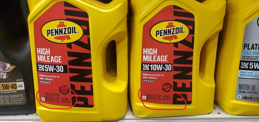

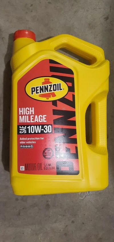

FYI, this is the Pennzoil delivered today from Amazon. Conventional, not a blend.
This is on a shelf of a local store. Also not a blend.
Gonna give Pennzoil a try. I've tried several HM oils & I'd say Valvoline was pretty good, Castrol leaked a bit more, Napa has been decent & I'll probably get flack but so far Fram HM oil seemed to slow the RMS leak the best.
