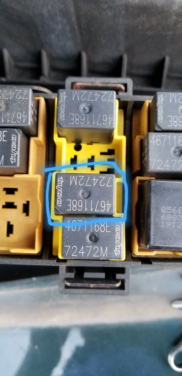

I don't know if you figured this out yet but I have been digging for a while because I get the Bank 1 sensor 2 (P0141, Bank 2 (P0161 ?) sensor 2 Heater CEL from time to time and from what I have found ( at least for the 2003 ) is that the relay may have gone bad ( I found a reference to this for a Jeep GC somewhere else on the interwebs so I cannot take full credit) . I actually just replaced both of the rear sensors thanks to this thread and replaced the relay ( with NAPA Part number AR606 - $14.49- ) as well. See pictures below. I also traced the wires to see if I saw any visible damage but I didn't see anything.
The relay was in the fuse box under the hood next to the battery. Maybe you will get lucky and the 2004 is similar.
I haven't had a chance to see if this has worked for me yet but because the jeep is no longer my DD but I hope this helps you or someone else in the future!

Thanks for the info, I'll try that. since it is still throwing the code every few times I drive it.
I just drove my jeep today started and it 4 or 5 times. Twice when it would have been cold enough to throw the code in the past. So far so good. I hope it works for you ..
Thanks for the update. I hope it stays that way!
