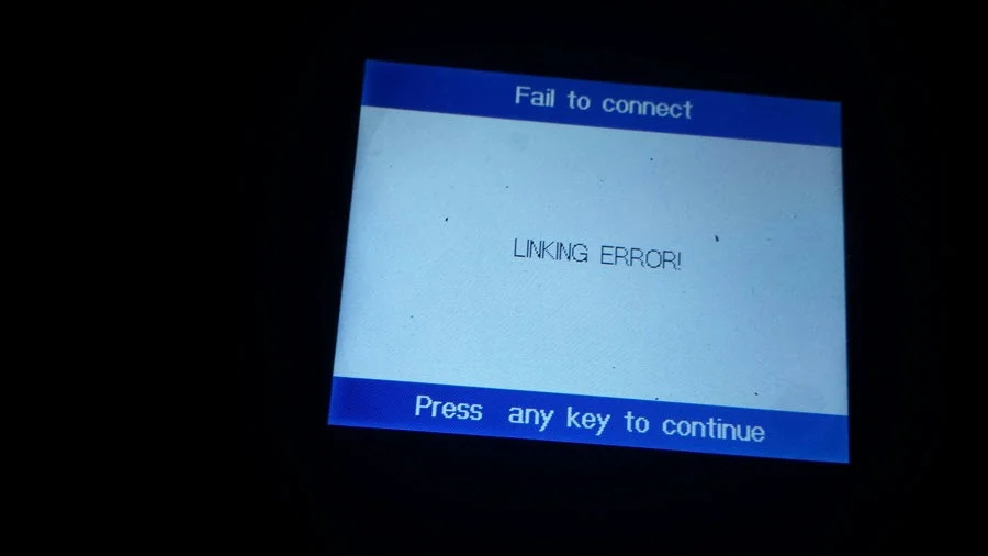

My Jeep runs for a few minutes, then stumbles & quits running. When it does, all the warning dash lights come on, the gauges read zero, and my code scanner reports a link error. I often get several codes reporting such at throttle position sensor, crankshaft & camshaft sensors, idle air control, misfire, & bus failure communication errors. But I keep getting all four O2 sensors after clearing all the codes.
I have a 2005 Jeep Wrangler Rubicon with a 4.0 & manual trans. It has 90k miles on it and I replaced the upper two O2 sensors five years ago (with the correct NGK/NTK brand sensors) and I have put about 10k miles on it in the last five years.
I am leaning towards a bad PCM, but the repetitive O2 sensor codes is making me wonder if it could be the O2 sensors? I don't know if I should replace the PCM at the cost of $400 or place a $100 bet on four O2 sensors?

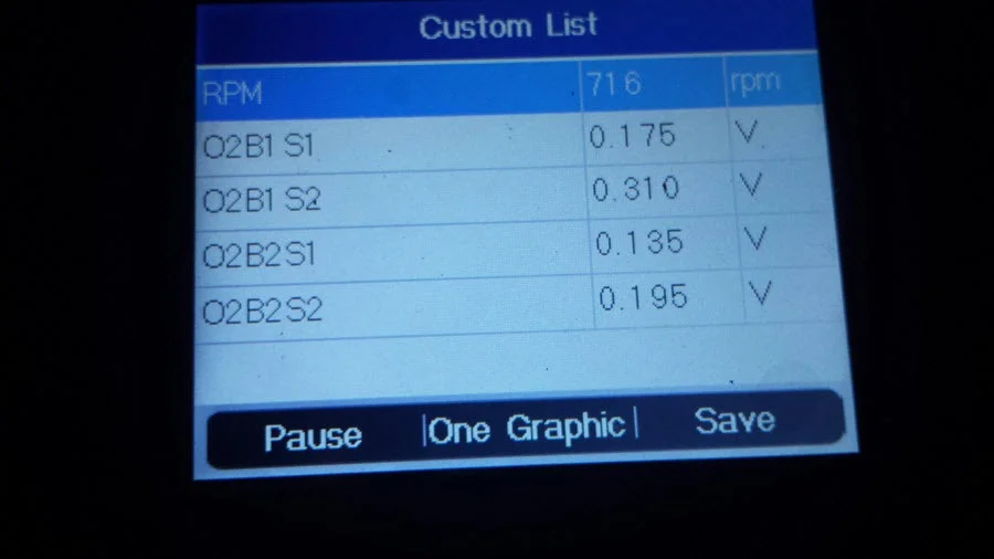

Update - I replaced both the crank & cam sensors
I still get all four O2 sensors reporting as bad. Specifically, I get P0031, 37, 51, & 57. This is the heater circuit low for all four O2 sensors. Is there a fuse somewhere or something else that would prevent the O2s from heating up? I could see one or two O2s being defective and failing to heat. But something else is else causing all four not to heat up. I get these codes soon after the engine starts.

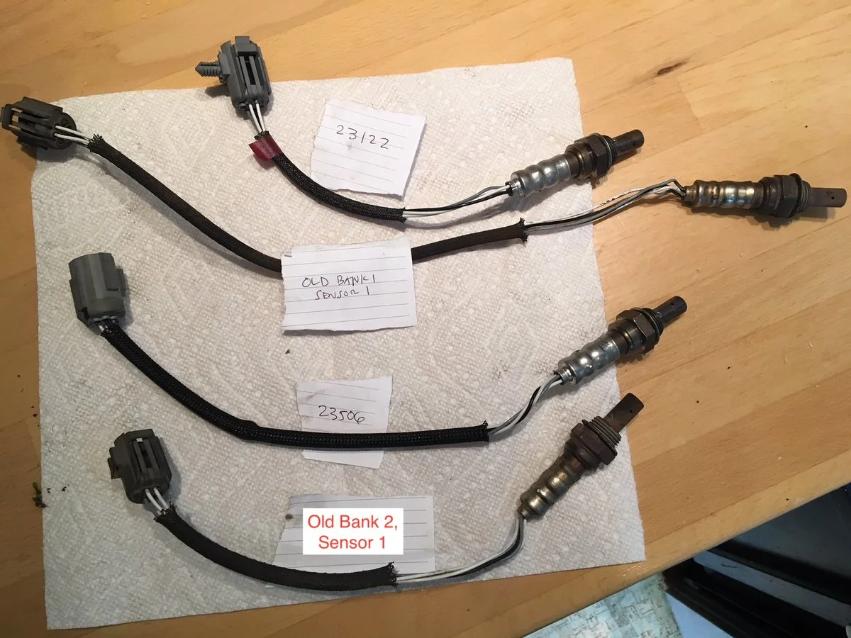

please confirm: in the above drawing which way is the front of the jeep. I had assumed the front was the left side of the drawing. I'm in the middle of replacing the two upstream sensors for 6-cylinder 2000 Sahara. I have the NGK 23122 and NGK 23506. I thought the 23122 was for the front sensor (Bank 1) but the wires for the two sensors are different lengths. it appears they are only long enough if I switch them. this may be my answer but I'd appreciate independent confirmation.

To illustrate the issue, here's a photo of the 23122 and 23506 sensors next to the existing ones I'm trying to replace. I
probably need another 6"-8" of wire to make the 23122 to work.

Where did you buy them? I'm wondering if someone, at sometime, got them mixed up at into the wrong boxes. Were they sealed when got them?

update: I spoke to a service rep at NGK/NTK. He clarified that 23122 is for engines that comply with federal emission standards. Those engines apparently have only two sensors (one upstream and one downstream). Since mine has four sensors (two upstream and two downstream) that tells him that mine complies with California emissions. He confirmed that 23506 is the correct upstream rear sensor (Bank 2, Sensor 1) but told me that 23099 is the matching sensor for Bank 1, Sensor 1 (upstream, front). 23122 (the one I purchased) is 10" long (measured from the gasket) and 23099 is 18" long which is about what I thought I needed to reach the connector. I'll provide an update when the new sensor shows up and hopefully be able to report that it went in without difficulty.

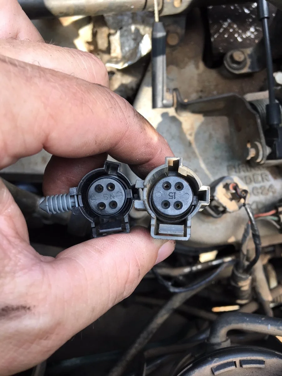

update: went to install the NTK 23099 oxygen sensor today and, though the length is right, the wiring connector doesn't match up. In the photo below, the old sensor is on the right and the 23099 is on the left. The nubbin on top is at the 12 o'clock position on the old one but it's at the 1 o'clock position on the new sensor. NTK customer service is closed on the weekends so I'll call them monday and hopefully figure out which sensor I need.

That doesn't make any sense then. It sounds like you'll either have to extend the wires, or NGK has the wrong part number in their system.

one more thing: before ordering 23151 I tried 23506. NGK told me it is indicated for California emissions and is 14" long but the wiring connector didn't match up as shown in the photo I posted previously. that one could work for you, depending on your model year.
