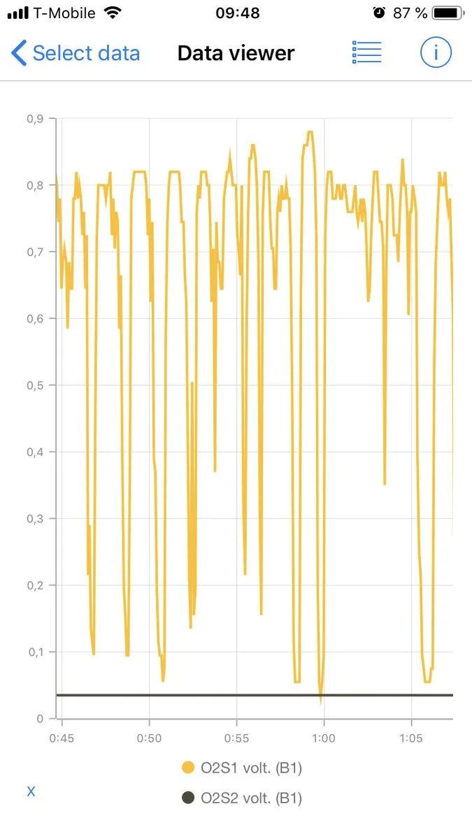

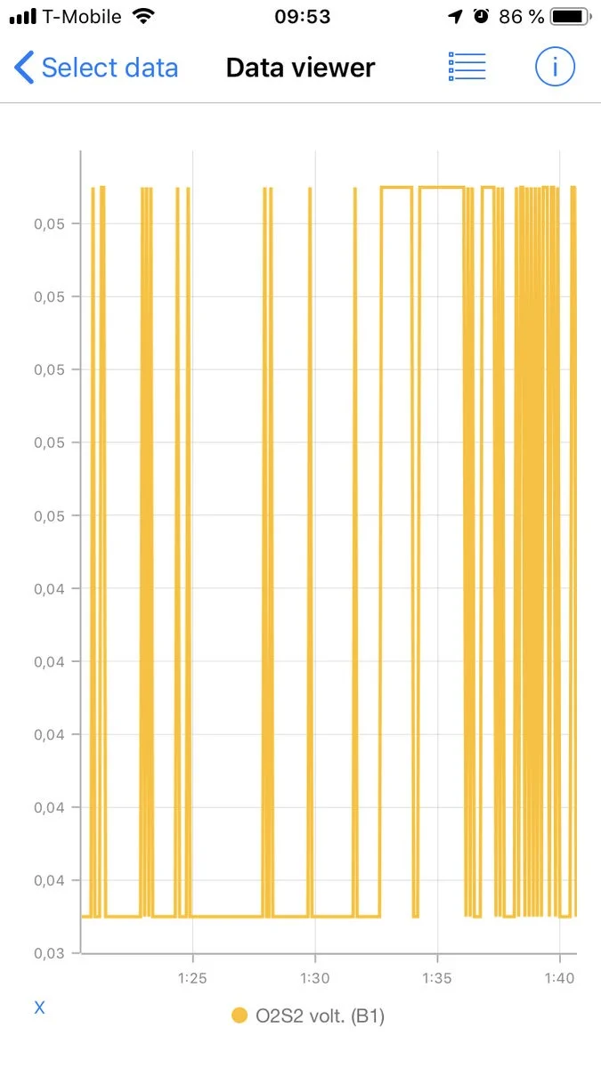

Thank you for this thread! I'm new on the forum, last week I got my first Wrangler, a 06 X. Just a couple of days in I got the P0133 and found this thread. I ordered the recommended O2 sensor and a OBDII reader for my iPhone. I changed the Bank 1 Sensor 1, reset MIL. About a day later the MIL turned on again and I started doing more research in the Car Scanner app and I found this, see attached images. O2 sensor 1 bank 1 (yellow) vs 02 sensor 2 bank 1 (brown). Second images is only of the Sensor 2 bank 1. To me it looks like the S2B1 only around a range of 0.4V-0,5V but somehow I still get the P0133. Is it in fact this sensor that has to be changed? Can someone please confirm my theory? Thank you!

I will also add that it's a bad idea to change one O2 sensor and not the others. You should change ALL of the O2 sensors at once. They are a general wear-and-tear maintenance item that need to be replaced around every 80k miles or so, regardless of whether they are throwing check engine lights or not.
What I am seeing here is that you replace one O2 sensor and now it's reading good, meanwhile the other ones are performing poorly, as they need to be replaced.

Thank you Chris! Yep, it was a NRK sensor. Sounds good, I'll replace all the others as well.
No problem! I'm almost 100% certain that will fix your issues. You'll probably notice your Jeep runs better too, and possibly even gets better fuel economy (if that's even possible from a Jeep :ROFLMAO: ).
