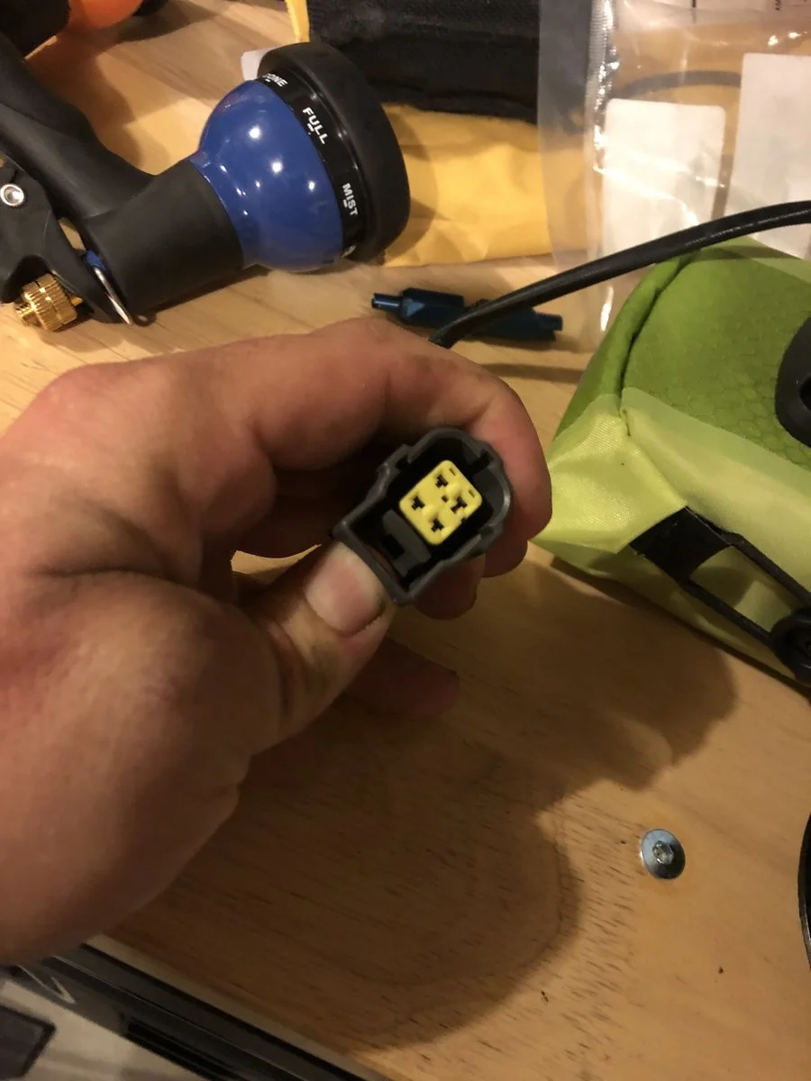

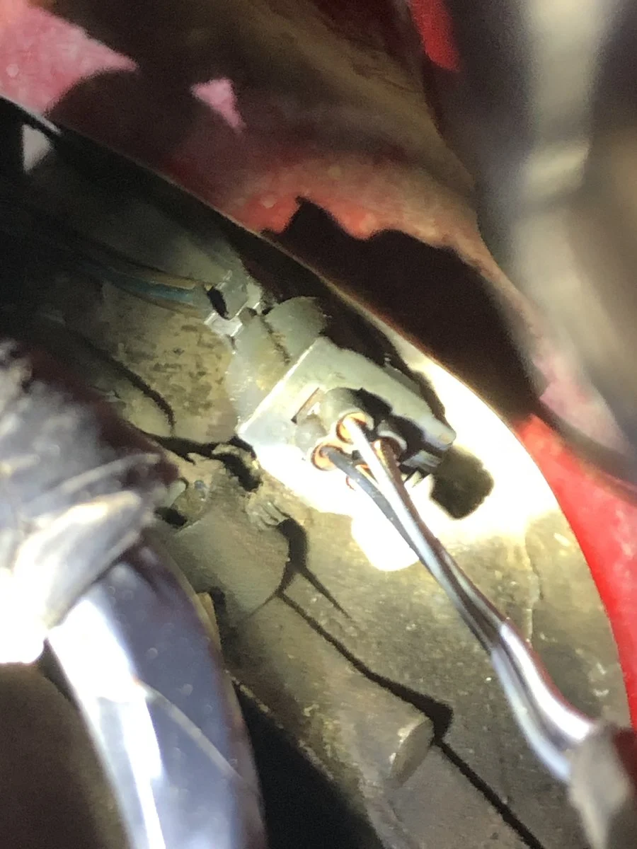

@Chris, save me. I cannot unclip the bank 2/sensor 2 plug. It is driving me insane. I’ve been out there 1.5 hours trying to unplug it. Sensor came out fine, just the plug. It’s in the transmission tunnel. I THINK I know how to unplug it, just press-push-pull. Like on the new one.
No luck. Any suggestions? Anyone?

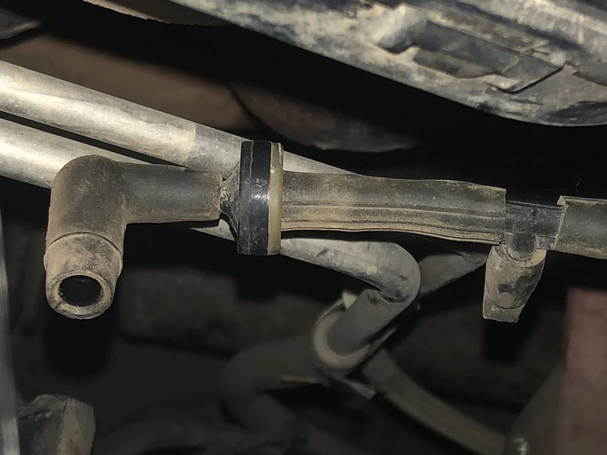

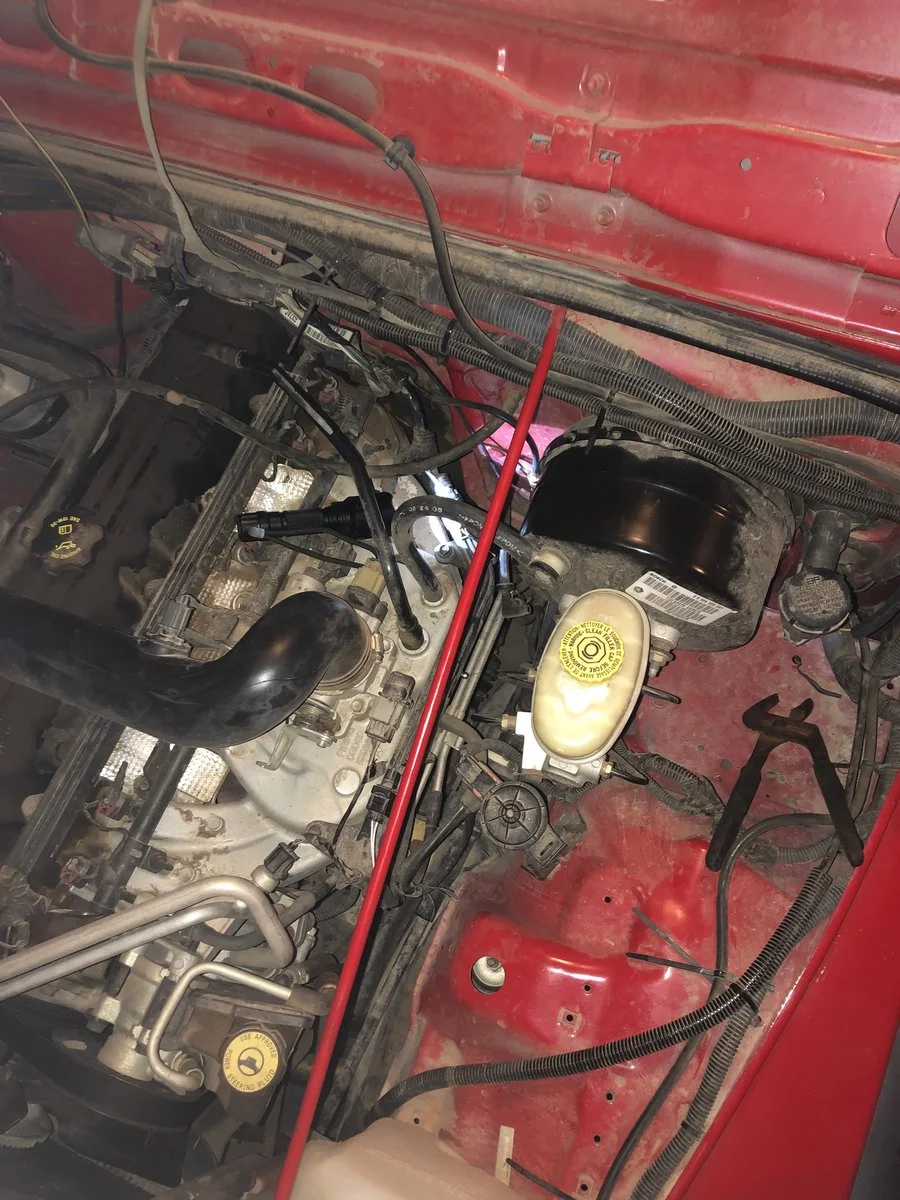

In the process I unplugged this. Can’t find where it plugs back in now. Anyone know?
I’m working in this area of the engine bay.
That's exactly how you unplug it, unfortunately those connectors can be a son of a bitch when they've been exposed to the elements and never removed before.

Well crap! There’s almost no way to get your hand in there. Did you see the rest of my post? I unplugged something else while trying to unplug the O2 sensor plug and don’t know where it goes now. Got tired of looking
I missed that part, I'm not sure where that goes. @toximus or @jjvw knows I'll bet.
That's a vacuum line likely from the intake manifold.

Ok, found where the vacuum line plugged back in. O2 sensor plug still giving me fits. What a bear!
Try cleaning the connector with electrical contact cleaner (because it's safe for the plastic and seals).
Sometimes grit works it's way into the connector. It'll mess them up slightly, but you might need to use pliers to get enough grip on them.
Another option is to pull a fender for easier access to that spot.
I had channel locks on one side and pliers on other several times to no avail. My next idea is to cut that tab off with some wire cutters. I literally can’t push it down. The channel locks seemed to move it down some, but any other method of pressing is futile. I felt stupid even posting this but any idea is worth trying
