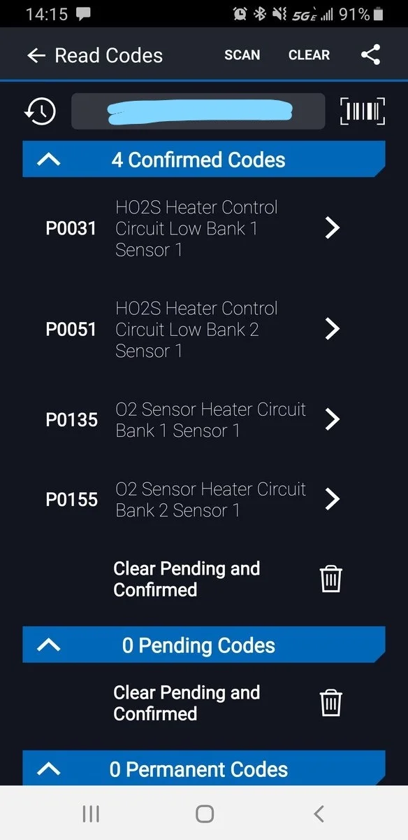

Any idea how to test the O2 sensors? I mean via voltage/OHMs? Getting these codes after I chased down a misfire in another thread. I've seen that you can remove it and test with an OHM meter while heating it up with a blow torch. I wouldn't know what wires were senders, so.....

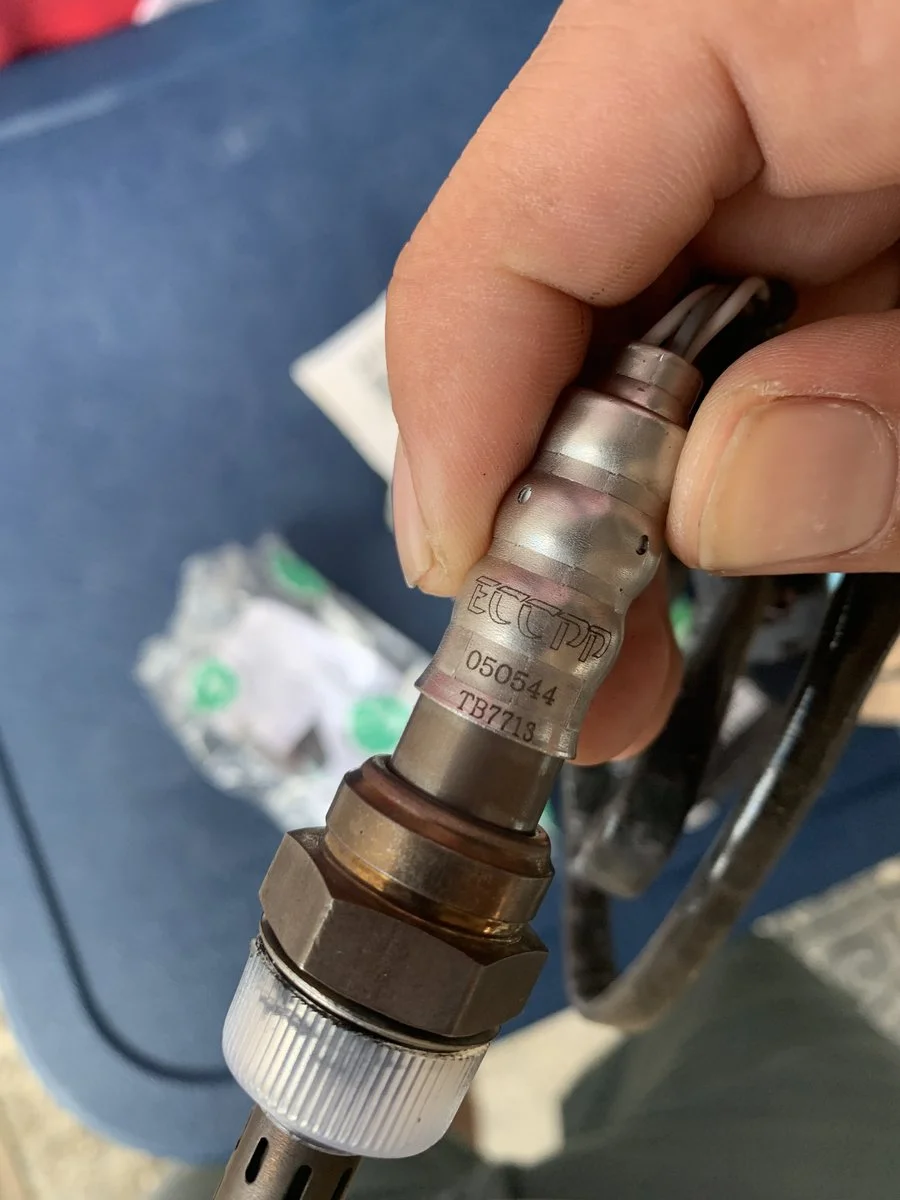

Just a heads up for you guys replacing your sensors, even though the box states the correct sensor outside the box double check inside that it is in fact NGK/NTK.
Ordered a complete set on Amazon and one of them (it was sealed and all) had a logo on the 02 that I didn’t recognize. Found out it was an ECCPP Sensor instead 🙄
I know there is a relay for the downstream O2 sensors. Is there one for the upstream? I don't see any listed in the relay box but there are heaters on them so I imagine there should be. Want to check just in case to try to track my upstream O2 sensor heater issues.
FYI per the FSM it's the ASD relay.
