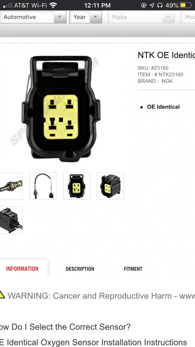

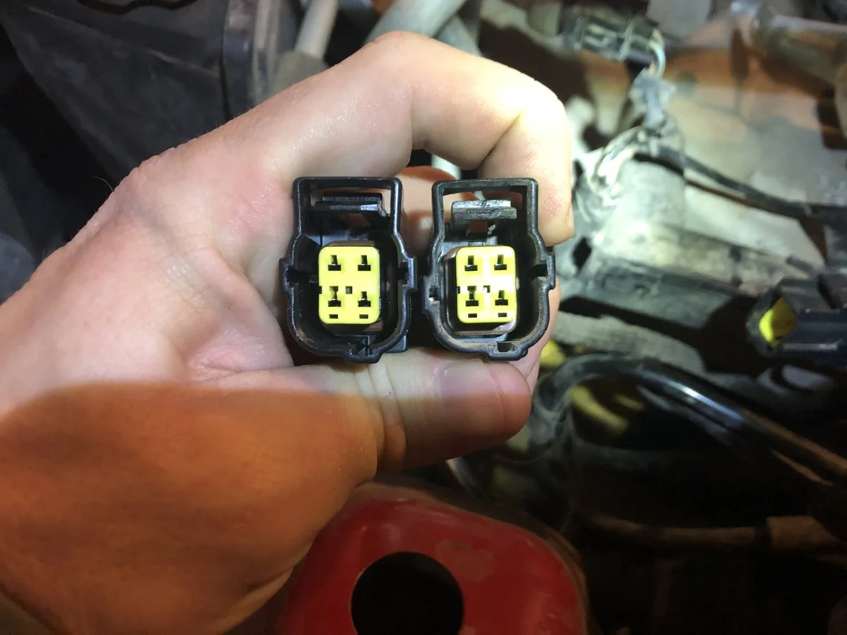

@Chris, not sure what’s going on here. I bought the B2S1 NTK linked to in original post for a 2005 TJ. Part No. 23160. It is the same one in the NGK website as well. But the harness connects slightly different. See pics below:
Note on the left side of each connector the c channel is lower in the original than on the replacement. Because if this they won’t slide together
Image below is from the NGK website. It’s just like the one I ordered above, but won’t fit.
Wow, that's really, really odd. I never had this issue when I did mine.
While I don't know why this is, you know what I would do? Take the connector from your old one and reuse it on the new one.
If you have these types of wiring tools, it's a piece of cake to swap connectors:
https://www.amazon.com/dp/B082FDGVD9/?tag=wranglerorg-20
I know, you’ve had ‘05’s. This is a mystery to me. It made me think either the part no was wrong or something happened in the OEM manufacturing of my rig (which would be so odd).
I may look further into this before cutting the wires and using the old harness
No need to cut the wires if you use those tools I posted the link to.
But yes, if you look into it further, I'd be curious to hear what you find.

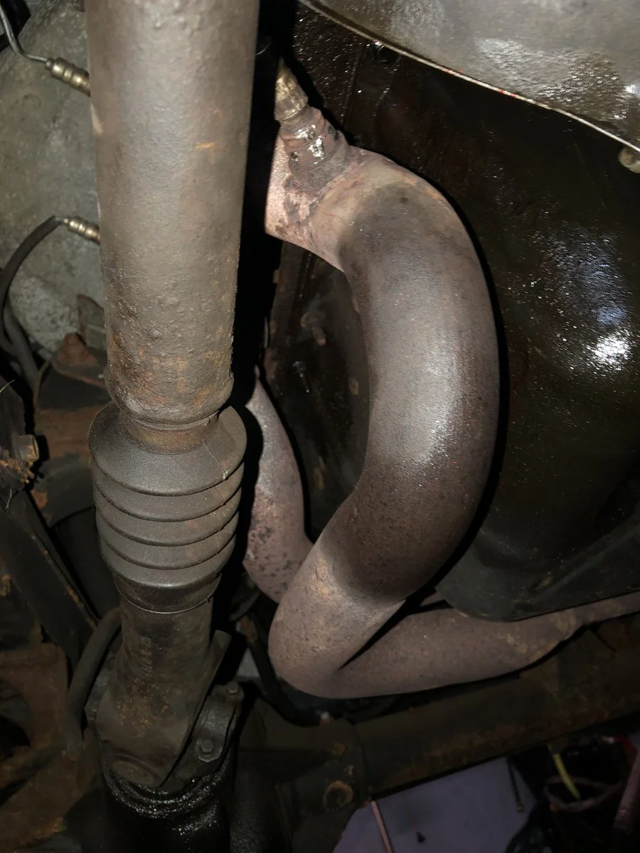

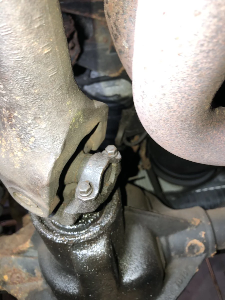

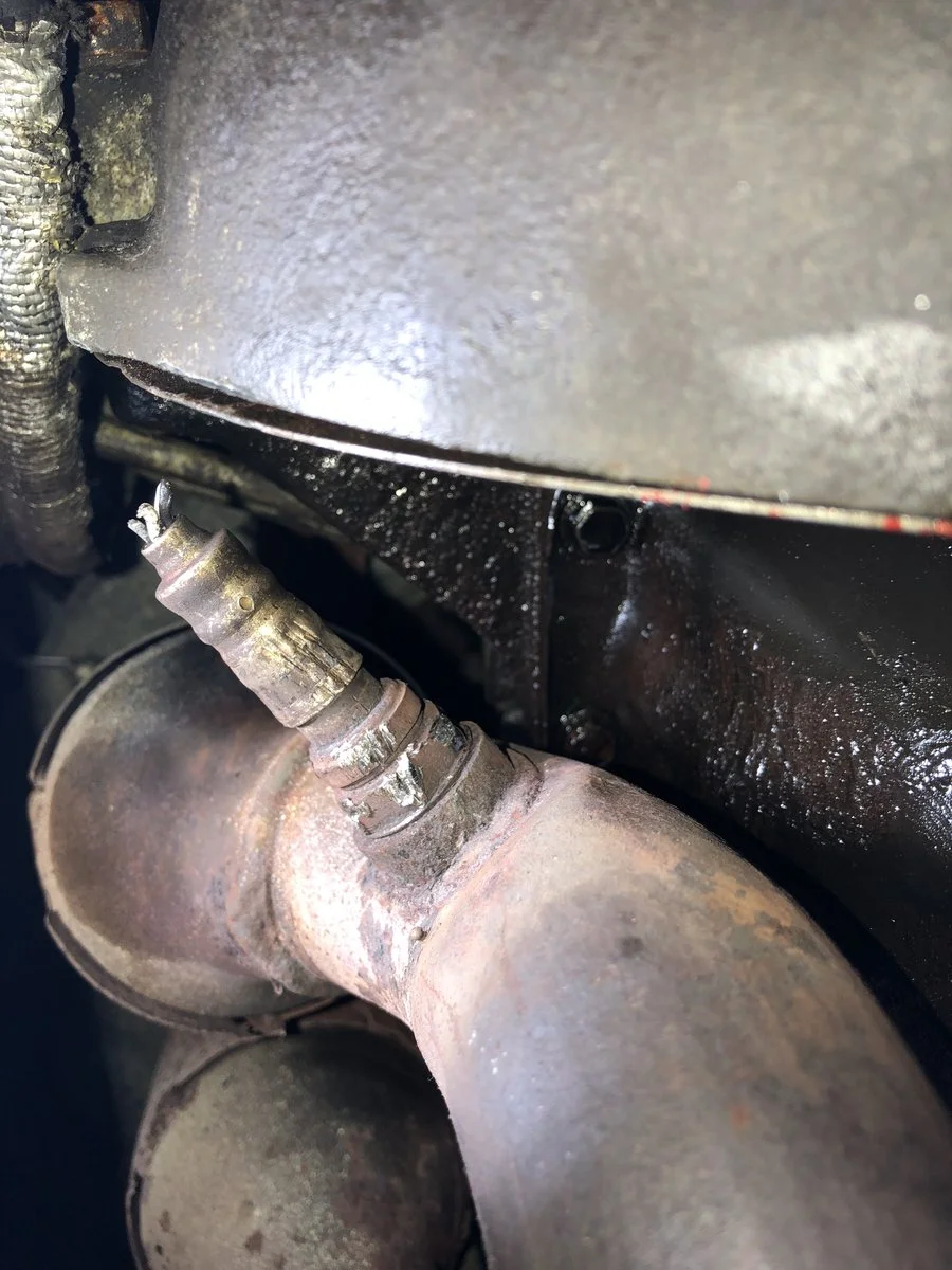

Hey. Struggling to get downstream rear sensor out. 2001 4.0 116k. Throwing P0158. I have the new sensors but the old one won’t budge. I’ve got both inline and offset O2 sockets. Tried heat (propane) and days of PB blaster. At this point the sensor is rounded off so I can try about anything, but my question is this:
has anybody disconnected the front driveshaft to have better access to the sensor? I feel like I could move it out of the way and get better leverage around the sensor. Or am I asking for trouble? Should I go get a MAP torch?
