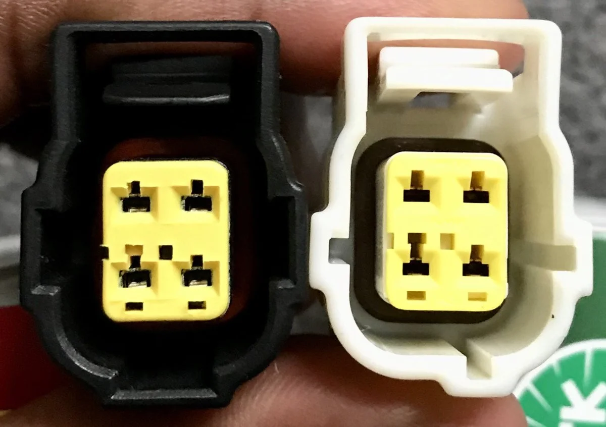

My right hand drive 2002 4.0 Sahara had the P0138 code.
The black one is from Crown: 56029049AA
White is the NTK: 23142

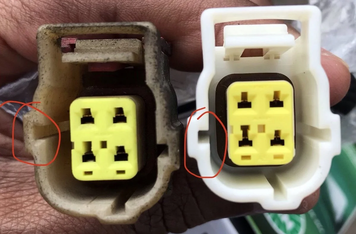

I ended up putting the crown one in as the tab on the side of the stock one did not match the NTK

New NGK o2 Sensor plug does not match.
Hey there,
before writing new post, I am gonna try to tag onto this one.
I am restoring my TJ and in the process of replacing the exhaust system, I am replacing all 4 O2 sensors.
I stumbled over Chris post about NGK and went to buy the ones from NGK.
I have a 2000 Tj (4.0) with calif emission system and it turns out my new Bank1 Sensor1, NGK Sensor has a black PLUG. The receiver however is Grey.... which does make sense because it appears that the pre CAT are suppose to be grey and post CAT black.
I called NGK and they couldn't really contribute to my problem. They persist, the one I got is the one that goes in there. The o2 sensor that was in there before was 56041212 AE, which according to them does not belong in there. Doing a lot research on this I realize the color is sometimes black, sometimes grey. Crayz... As posted earlier on this thread....crown even provides one plug that covers all options.
Does it matter? are the upstream sensors all the same?
At this point I am planning to replace the plug from my new NGK sensor to a grey one... although I have not been able to 100% confirm if that will work.
