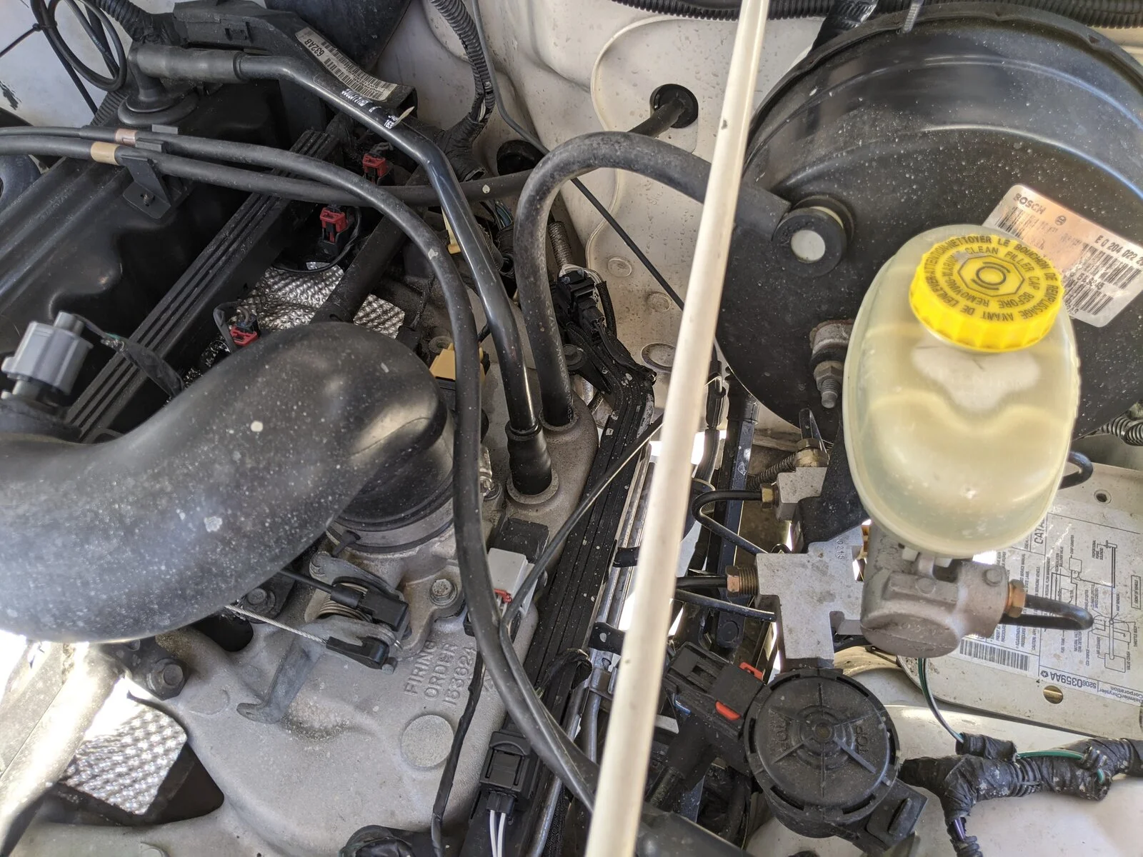

I know this is a strange request but could somebody with an 05/06 (or TJ with the 2 Cat, 4 O2 sensor system) send me a picture of where the the quick connect electrical connector is located for bank 2 sensor 1?
I just replaced my core plugs and after putting everything back together I cannot find the connector from the ECU. On my wire harness I think there looks to be loose tape in the spot I believe the connector should be originating from.
Thanks in advance for any help.

Red is bank 1 and green is bank 2.

The other one that might be getting you is cyl 3-6 after cat. It’s on top of the trans, can’t see it just have to believe.

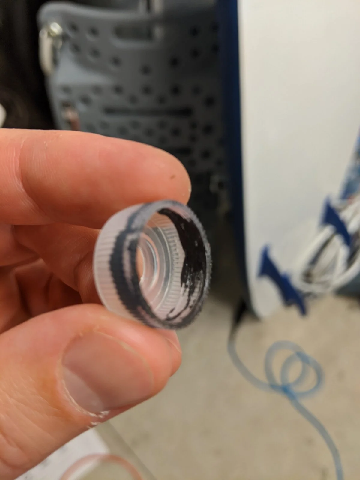

The NTK sensors I just installed did have a small amount. Here's the thread cap from one with some still on there.
