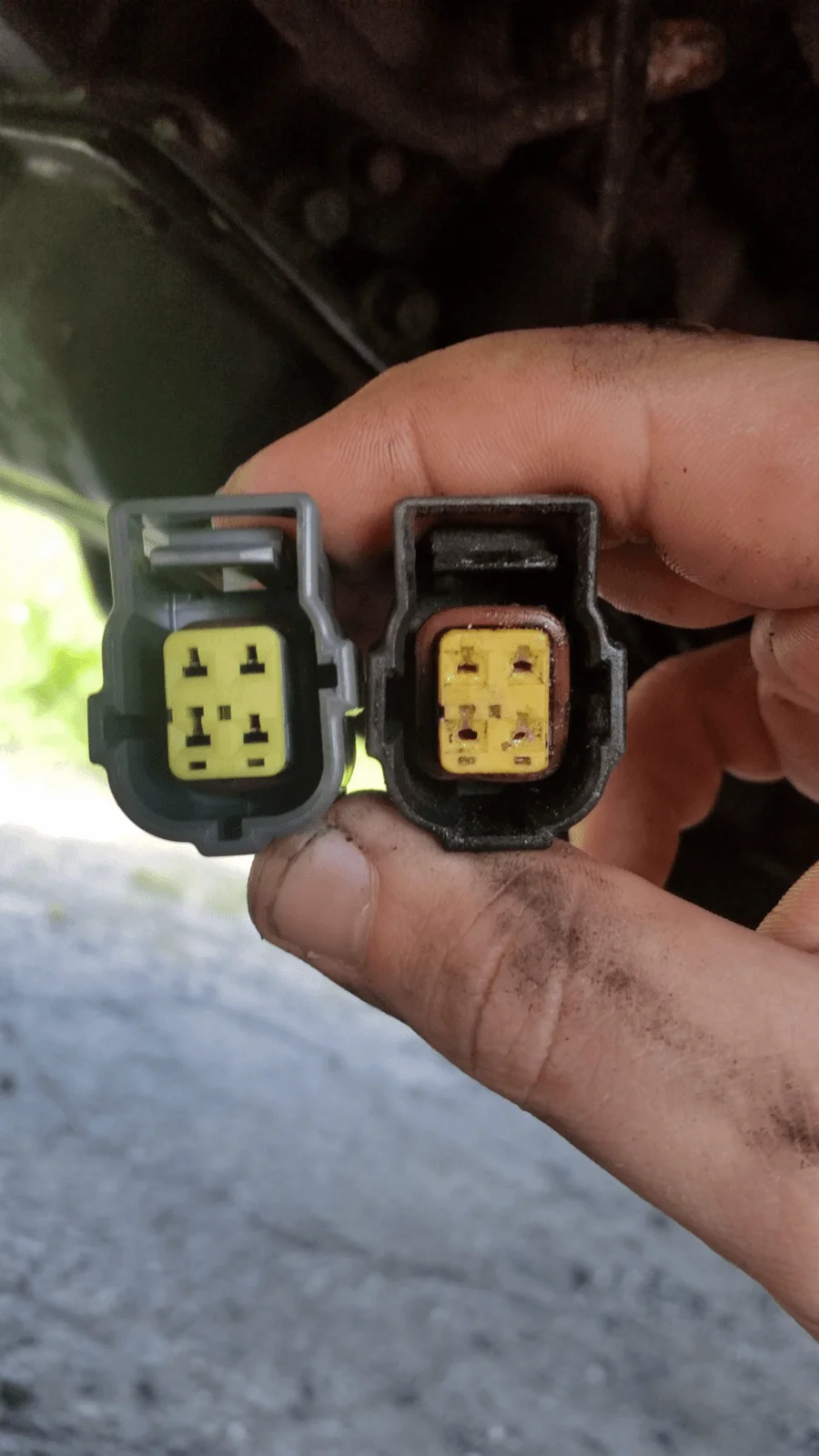

Well I received it today and it's not right, the plug is definitely different. In the picture, the plug on the left is from sensor #23158 and the one on the right is my current sensor plug
Has anyone else had this problem? Someone mentioned cutting and soldering the old plug on the new sensor but I'm not really comfortable with that
Does anyone recognize the sensor plug on the right?

This may not help much, but the one on the left is what I just took out of my 2003 4L and has Mopar # 5604049 on it.

So I did confirm with NTK that this is the right sensor and the right part. (Just to make sure a different sensor didn't end up in a box that said #23158)

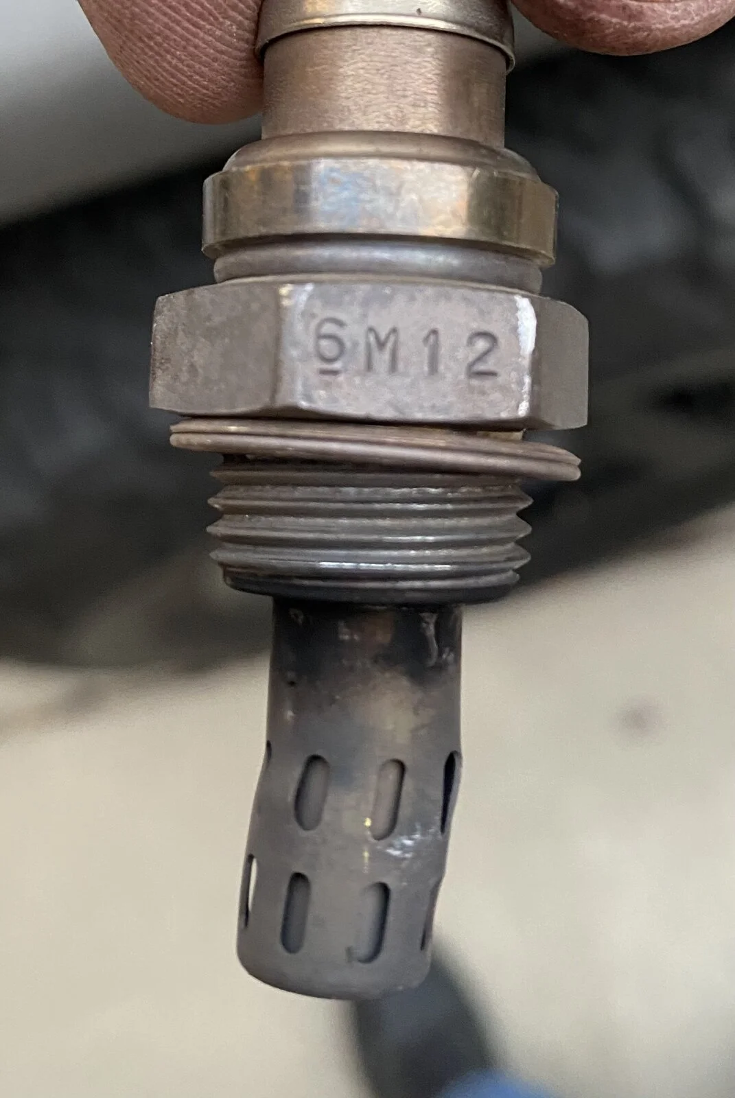

Finished replacing all my O2 sensors this afternoon.
Now it’s like a totally different vehicle. Much more power!

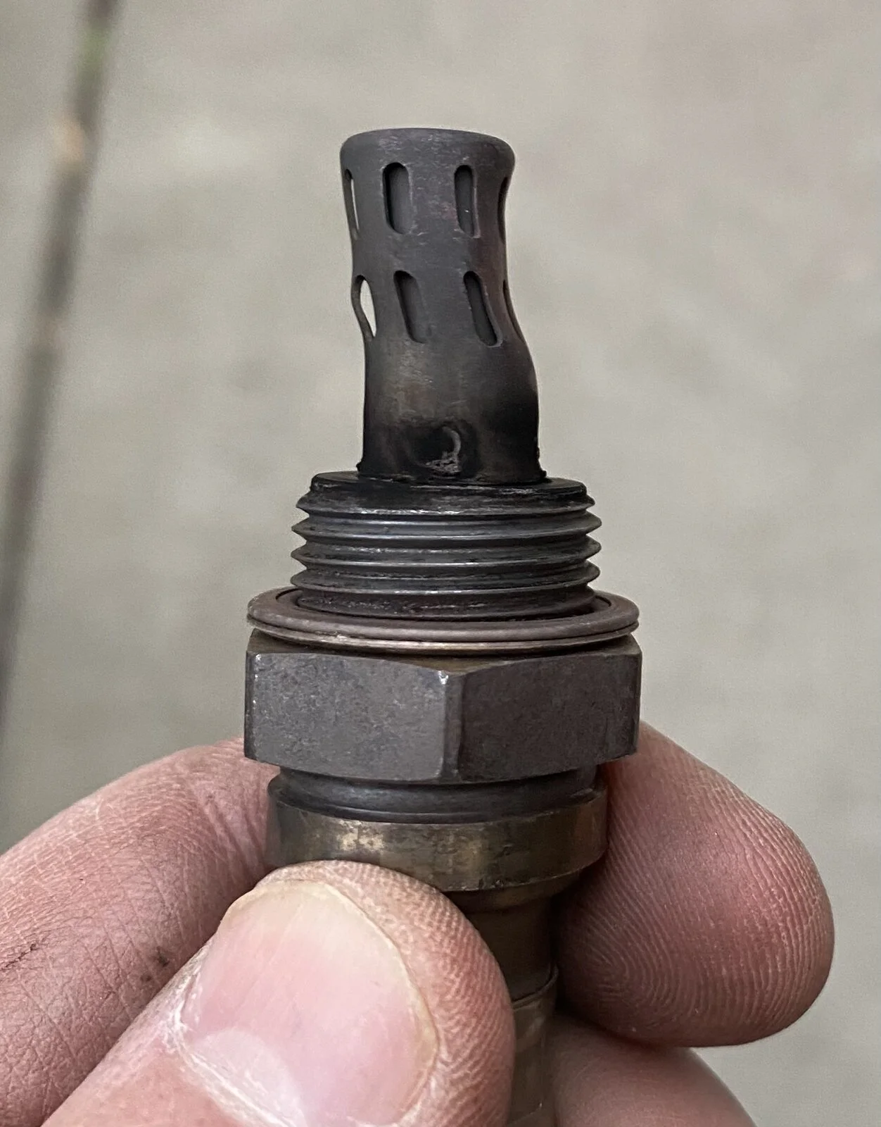

Here’s what my old front downstream sensor looked like when I took it out:

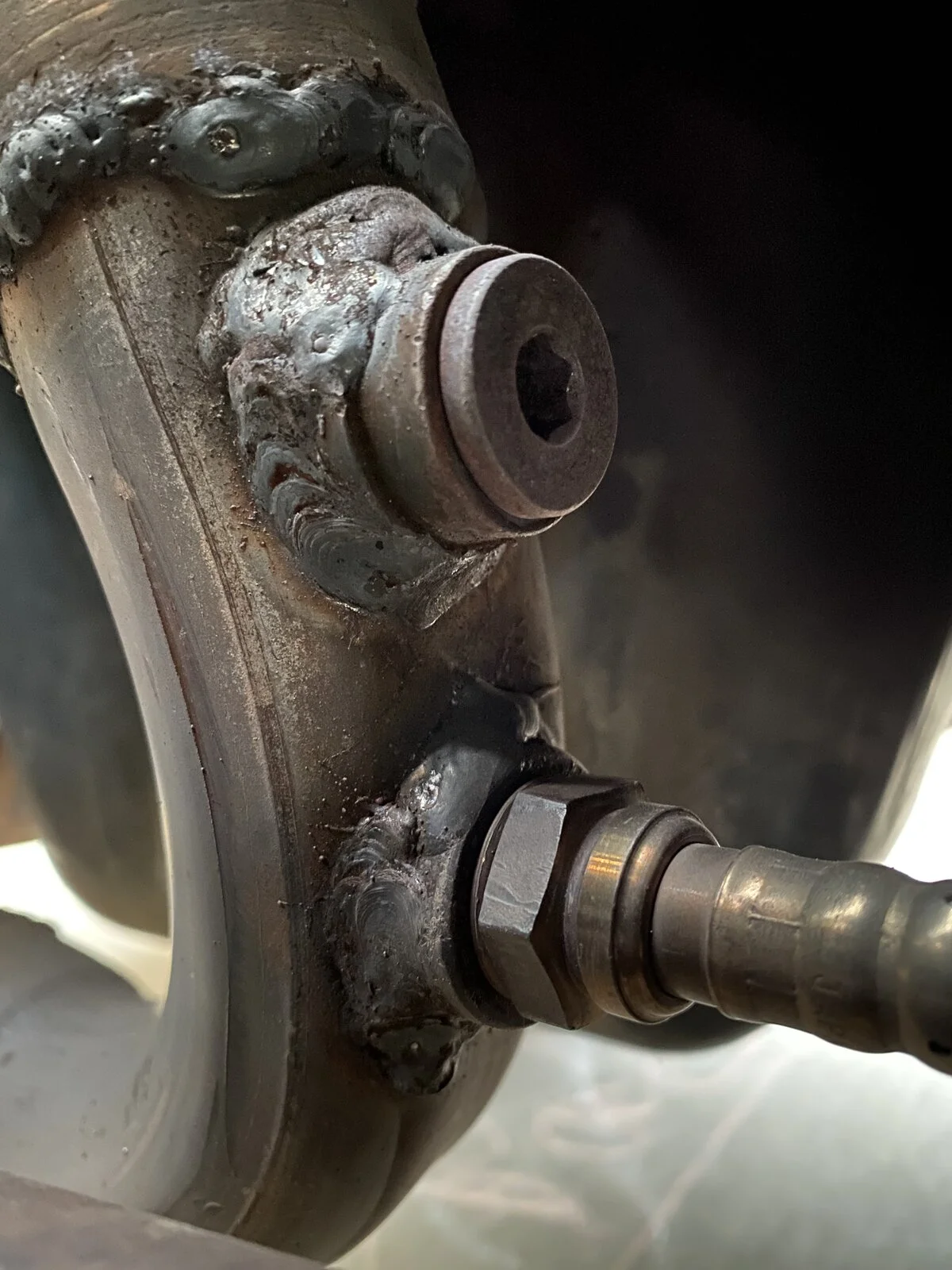

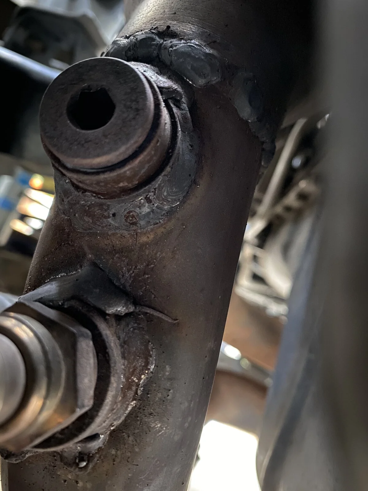

It looks like my rear downstream o2 sensor bung/flange was relocated? Does this all look OK? Why would this have been needed?

Yep, someone relocated it. It was probably interfering with the driveshaft or something else as the result of a lift or other suspension changes. No big deal though (y)
Thanks for the reassurance.
The Jeep hasn’t had any major lift or suspension changes. Almost completely stock when I bought it, except Bilstein shocks, and now all I did was add H&R springs.
I did notice before that when I bought it this pre-cat had been replaced, maybe the relocation was related?

That must be what it was related to in that case. I can't say why for sure, but it's likely that the replacement pre-cats they used had a bung welded in a place that was causing interference. Like I said, no harm in them moving it, so fortunately you're good to go (y)
