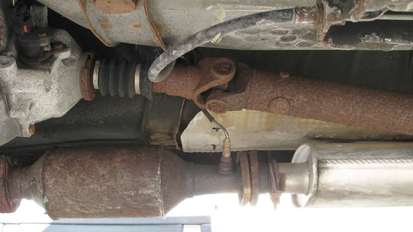

What are Bank 1, Bank 2, etc.?
Since this question pops up from time-to-time, here's an easy to follow diagram that illustrates what they mean when your OBDII code scanner (or manual) tells you something like "O2 sensor, Bank 1, Sensor 2":

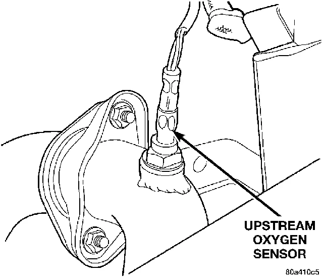

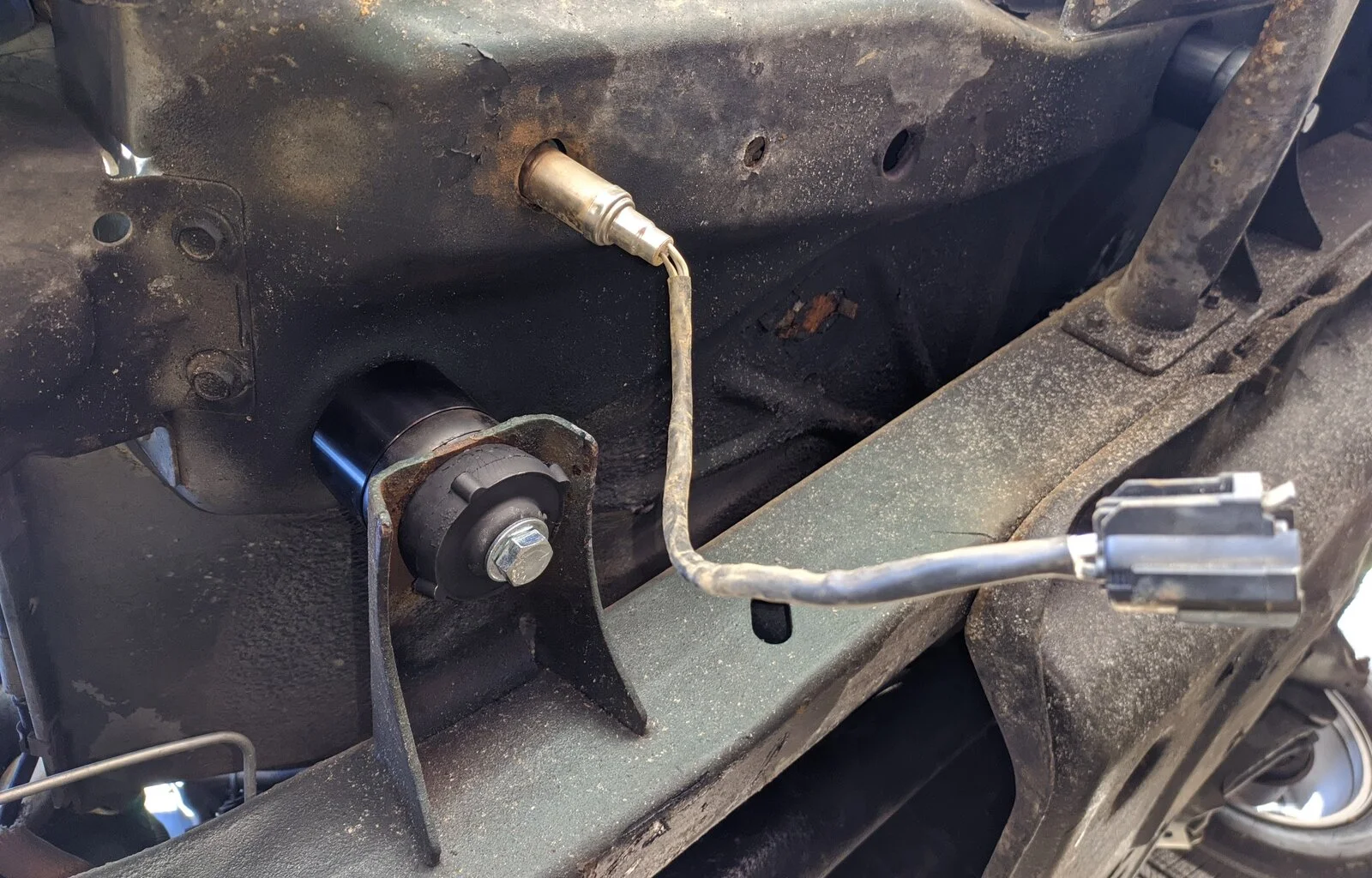

So I'm looking into changing out my o2 sensors, but I'm a bit confused at what I'm seeing from the PO.
(97, 4.0, MT... 2015 Blown Transfer Case, shredded wiring)
The upstream sensor looks proper, but the downstream is what I'm confused at.
Is there a good reason that the downstream would be shoved up into a random hole in the frame?

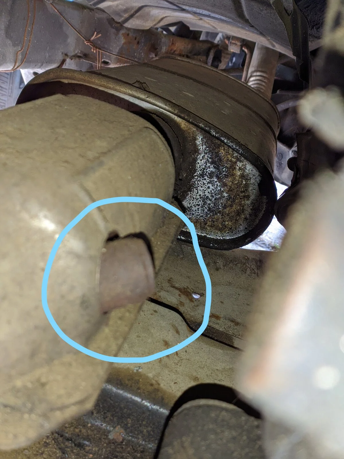

I think I found where the downstream is supposed to connect. Is this correct?
Bank 1 sensor 1 (upstream) should be just below the flange, mating the pipe to the manifold, bank 1 sensor 2 (down stream) should be between the catalytic converter and the muffler... That being said I suppose it's possible someone could have installed a different catalytic converter that has it "in" the body of the cat???
