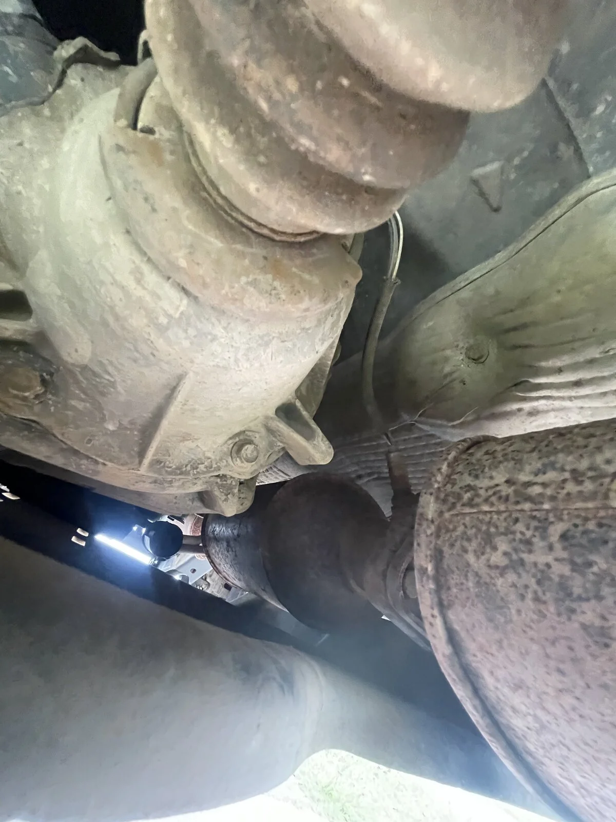

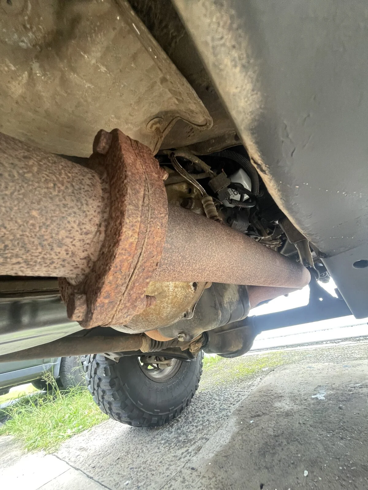

Hey guys,
New to the forum with a brain buster for anyone who might be able to help.
I have an 01 TJ 4.0 in Australia that I bought at the end of last year, I’m the 3rd owner and it’s my first ever Jeep, 192,000kms. Not a whole lot of issues so far, but a couple of weeks after I bought it, I had a CEL for crank/camshaft sensor, so I replaced both the crankshaft sensor and the camshaft sensor/synchronizer and the light went away. Happy days.
I recently got a CEL for the P0133 code (I believe it is the bank 1/sensor 1 code for slow response??) - doing the on/off ignition trick.
I have been getting terrible mileage since I bought it (but I also don’t really know what good is being my first Jeep), and thought that after replacing the crank/camshaft sensors it would get better. After reading that you get poor mileage due to bad o2 sensors, I decided after looking at this thread, I may as well replace all the o2 sensors for good measure. Got all 4 sensors according to the part numbers posted on here so should be all good.
Now the fun part…
Looking at the diagram for the 4.0L engine, I should have 4 sensors, and two cats right up against the manifold right? Wrong. No cats up near the manifold, looks like I’ve only got one under the skid plate, and only 2 sensors, one before the cat, and one after the cat. Refer to pictures. 1st pic is before cat, 2nd pic is the exhaust going into the manifold and actually looks like there are bolts in where the sensors should be and the 3rd pic is the cat/sensor after cat.
So I’m assuming the owners before me potentially modded this?! After looking at the VIN, double checking I’ve got 6 spark plugs (lol), and checking everything telling me this is a 4.0 6 cylinder engine, I’m not crazy am I?! Any idea on what sensors the two I have would be? TIA!
I can't tell much from the photos but if you've only got 1 Cat and 2 sensors I'm not sure how the computer is reading that.... must have been rewired as well.

Export TJs didn't have to meat the same US EPA standards. In the US 2000 was the last year that Jeep used a 2 sensor setup on the 4.0 and that was for the "Federal" emissions models. The California emissions models started running the 4 sensor systems that year. I would bet your ECM is programmed the same as the Federal Emissions 2000 model year.

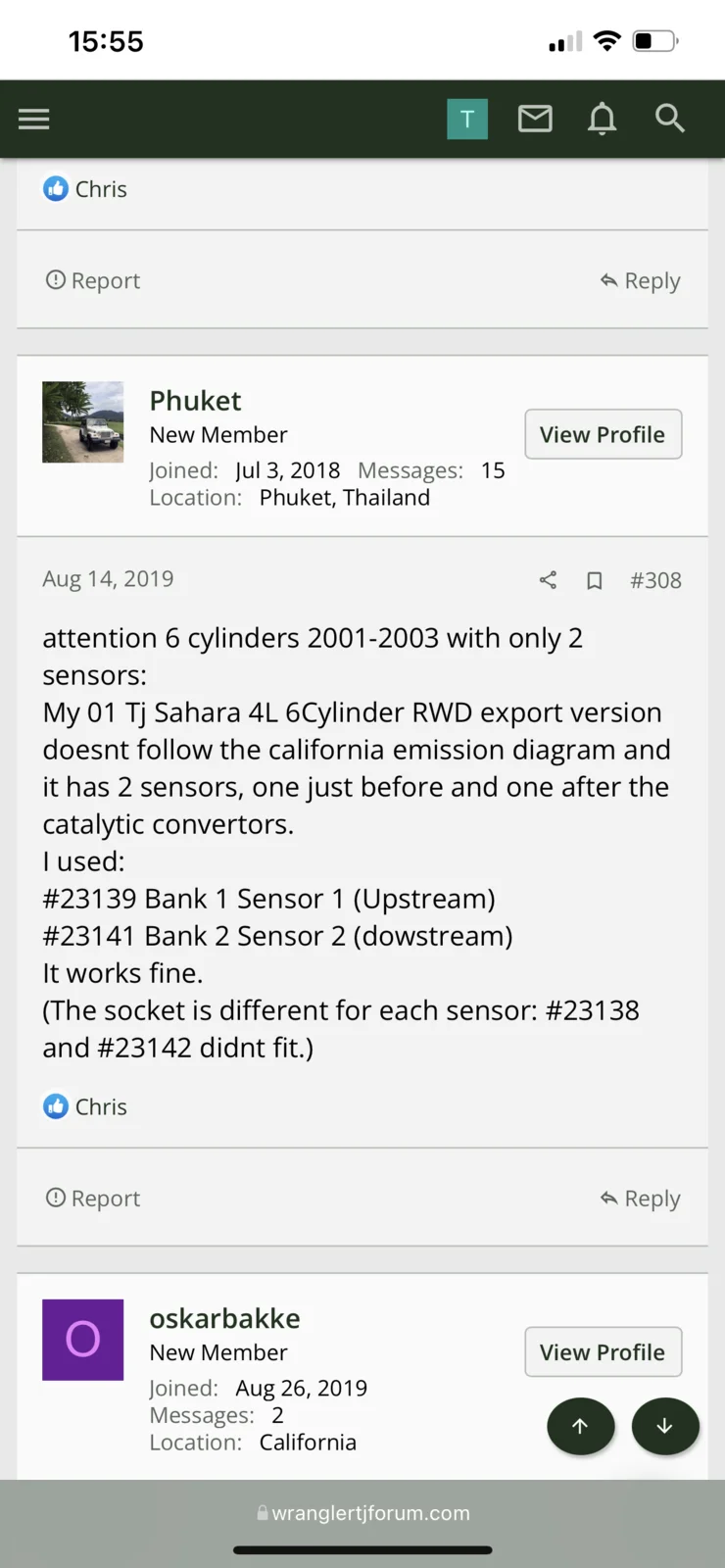

Might have finally found the comment you were talking about…
I have both of these sensors within the package of 4 that I ordered for a 01 setup. Thanks for that info, even the Jeep mechanic here didn’t have an answer about the export differences. Will give this a crack and see how I go.
Glad you found it. I knew it didn't use the same sensors as the '00 model and I couldn't remember the right #s.

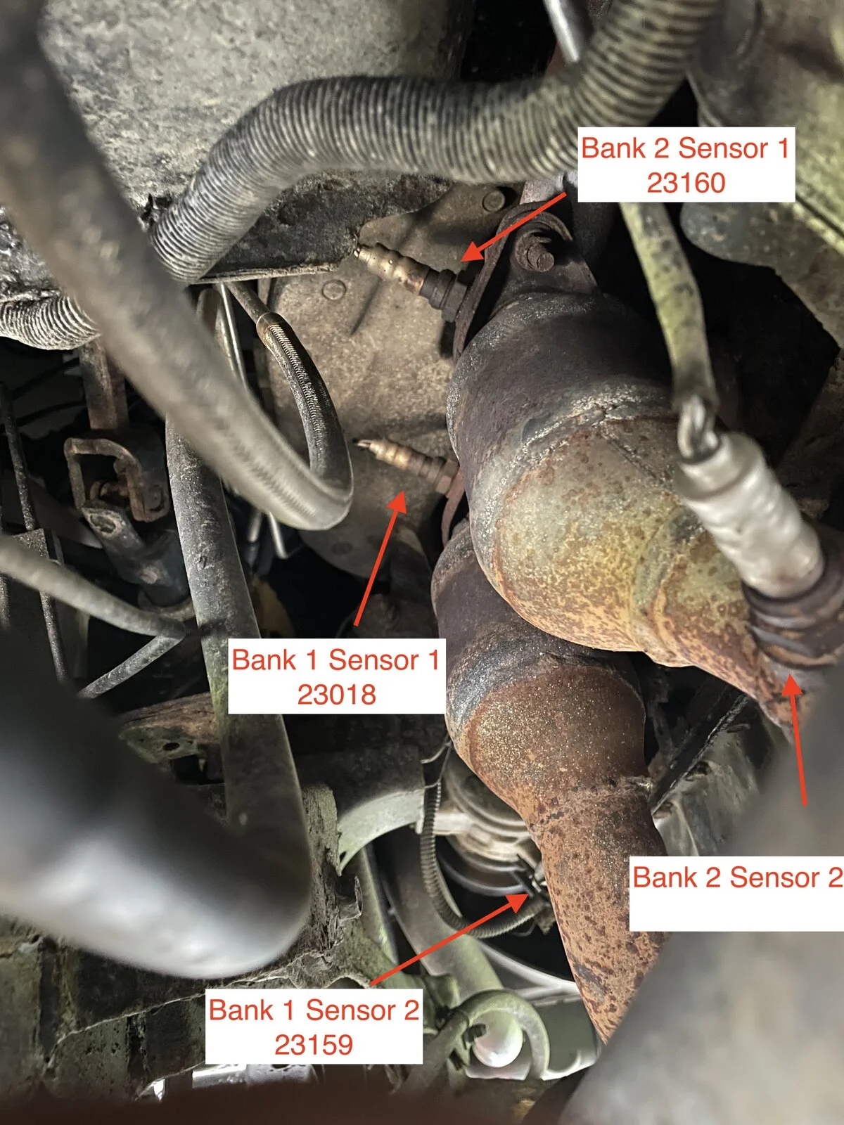

Can anyone confirm if I have the banks and sensor locations right before I go at it?
Picture taken from beneath drivers side door
2005 4.0

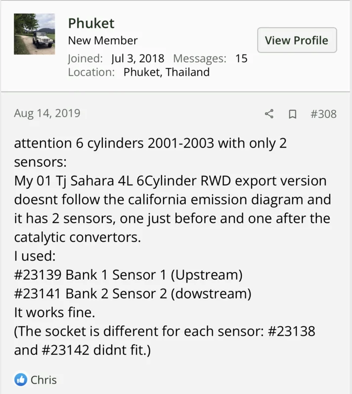

Those don't look like the correct numbers for the export TJ.
The author of this post had the same problem. the numbers he came up with are not the same as the 99 model.
Post #308

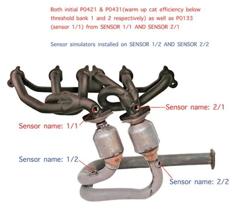

What are Bank 1, Bank 2, etc.?
Since this question pops up from time-to-time, here's an easy to follow diagram that illustrates what they mean when your OBDII code scanner (or manual) tells you something like "O2 sensor, Bank 1, Sensor 2":
