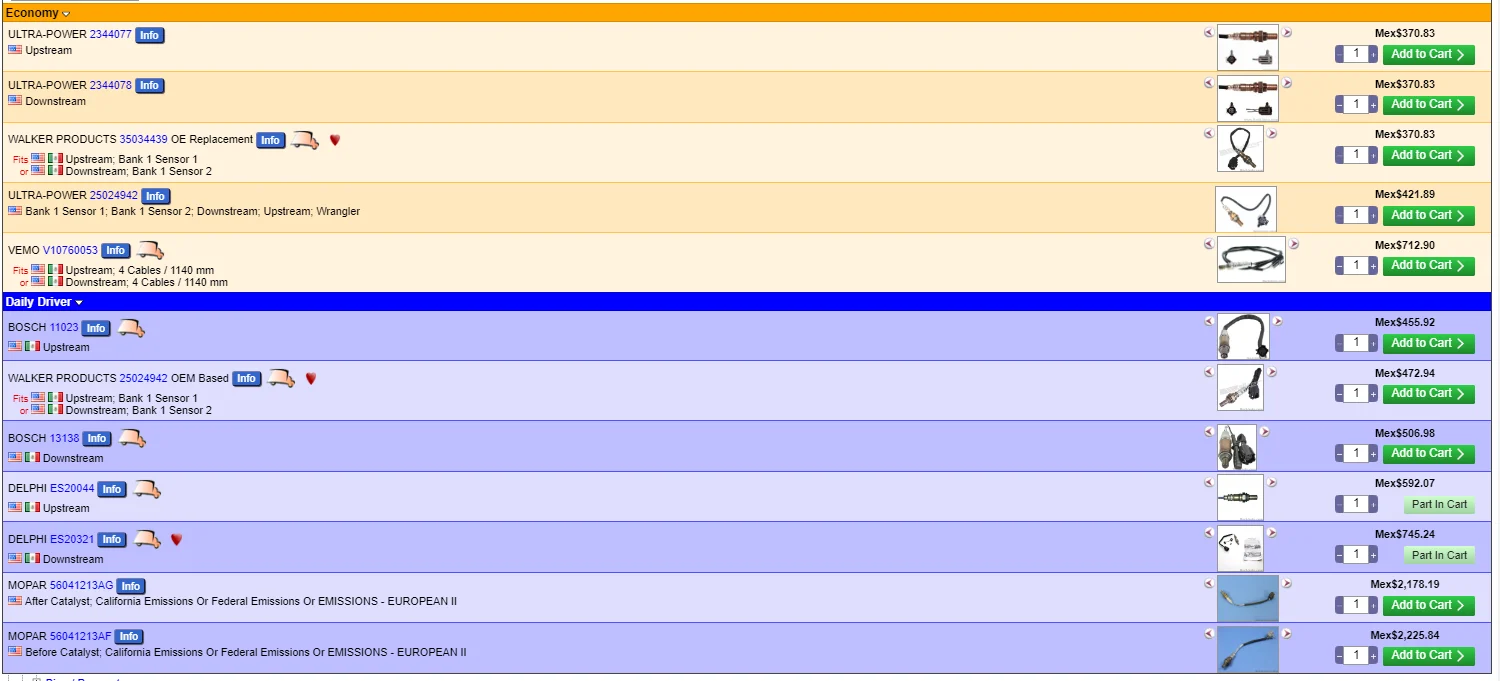

Guys, thanks all for your help and comments. This what rockauto offers for my 2.5l, i dont like that Walker offers the same sensor for down and upstream, i think the purpose is definitely the same for these sensors, so i would like to ask your opinions. And also, it seems Delphi has potential?
Guys, thanks all for your help and comments. This what rockauto offers for my 2.5l, i dont like that Walker offers the same sensor for down and upstream, i think the purpose is definitely the same for these sensors, so i would like to ask your opinions. And also, it seems Delphi has potential?View attachment 531610
They are litterally just temperature sensors. Many times different part numbers are assigned to identical sensors with the only difference being the length of the wire between the sensor and the plug, or perhaps a slightly different plug..
My guess is that the Walker just decided to kill 2 birds with 1 stone (so to speak)...

That circles back to the question of why Walker only offered 1 part number as a replacement for the 2 different NTK sensors...
@reddvltj, any idea why the Walker sensors have two options? One says OE replacement and the other says OE base sensor.

From what little information I can find, it sounds like the "OE base sensor" is designed to be a direct replacement for OEM NTK sensors, and the "OE replacement" is a less expensive or "economy priced" version. More or less a Premium vs Economy thing.
It would be interedting to see which versions those who have been using Walker went with...
Does the economy fall victim to the same sensor error issues that most aftermarket sensors do?
Is the Base the version that line that people have been having good luck with?
