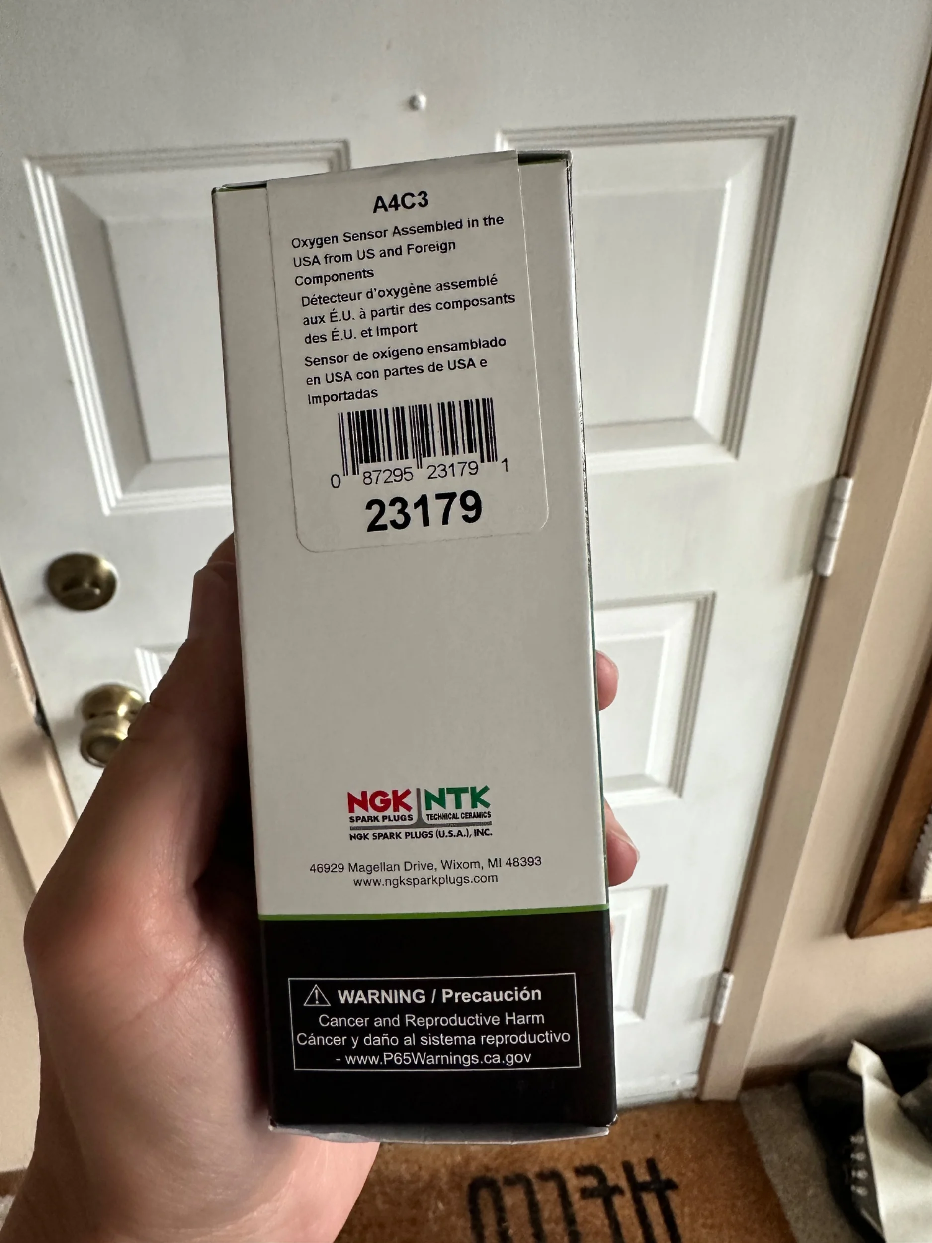

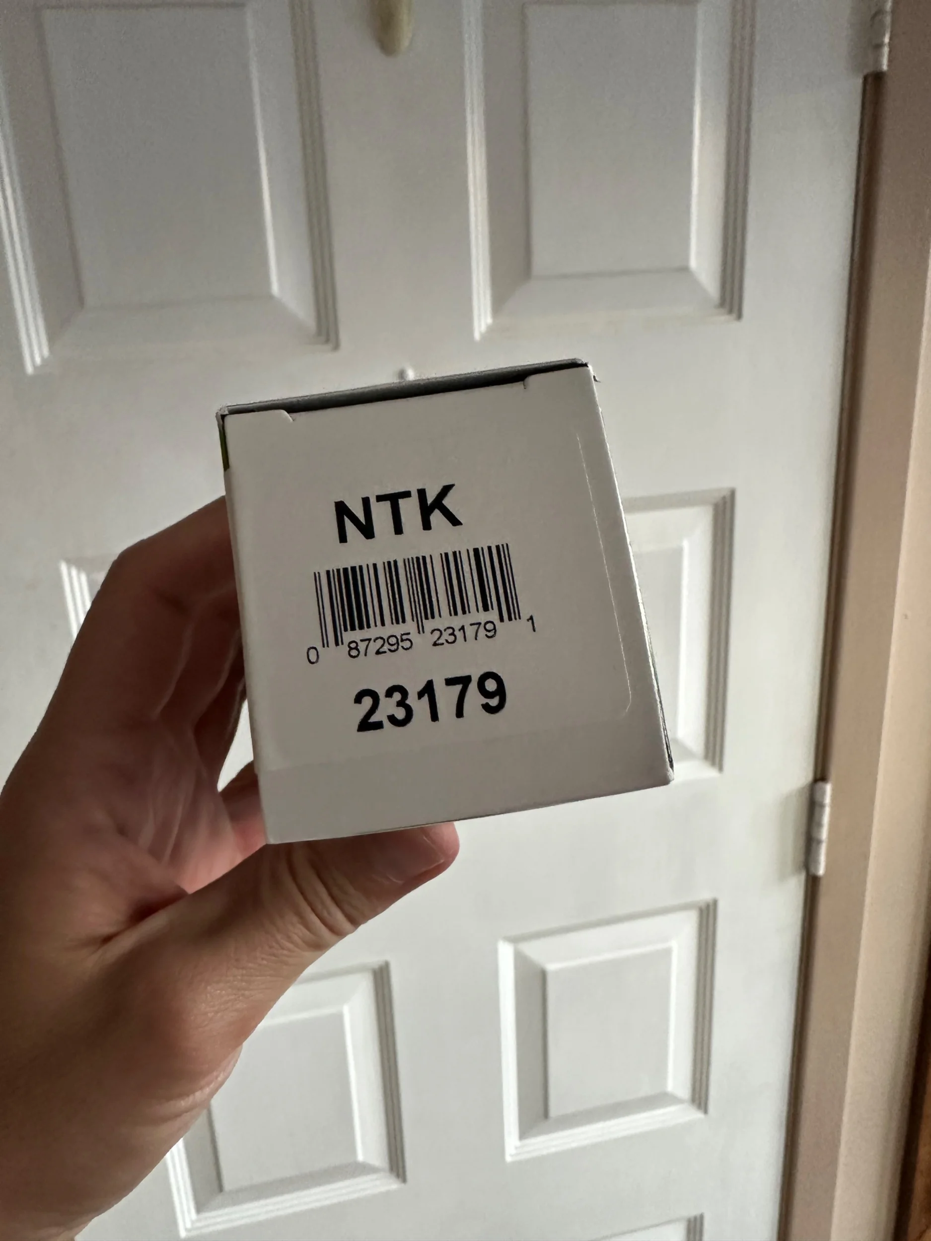

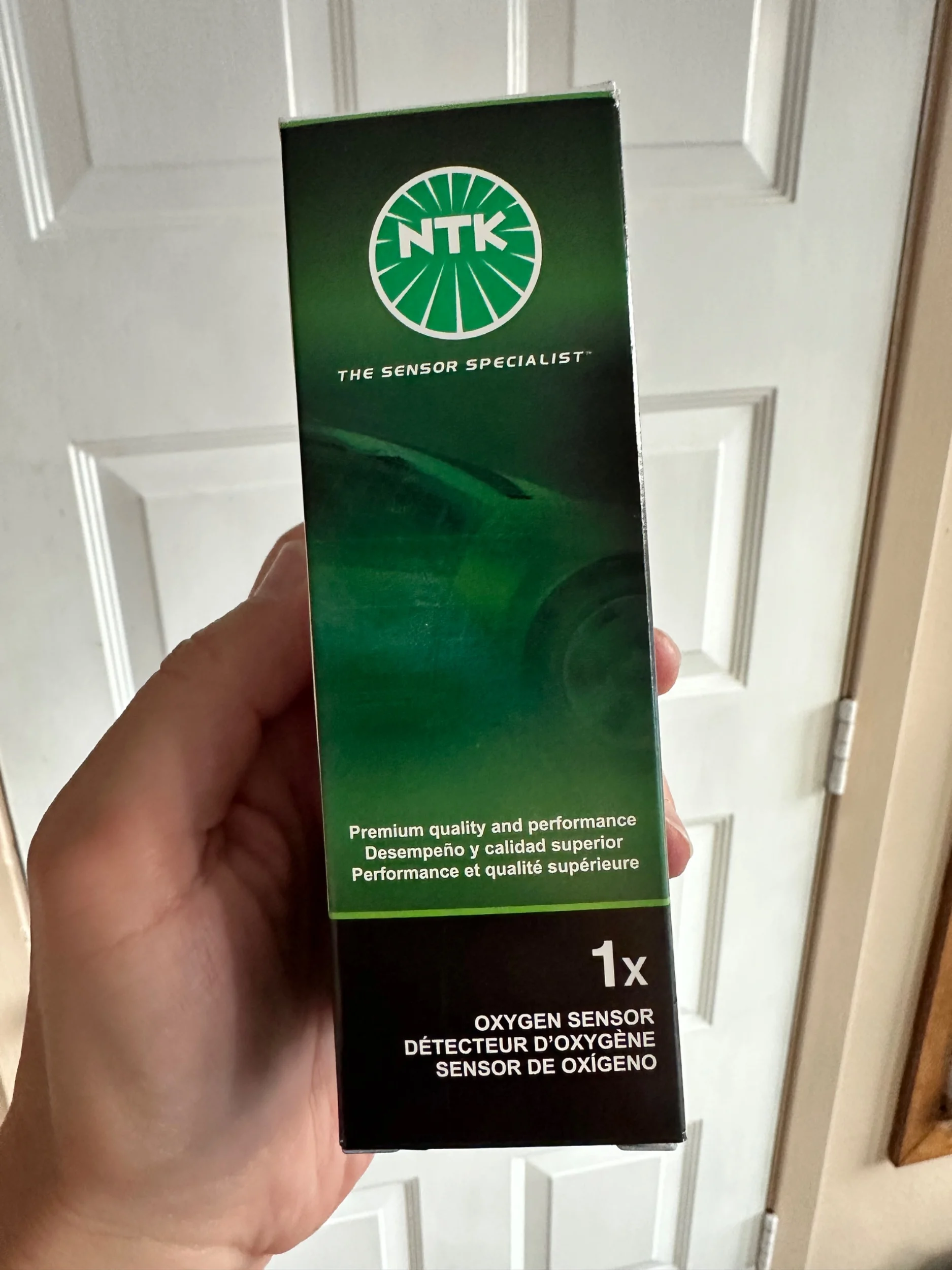

In case anyone was wondering I ended up getting this NTK sensor from NGK.com and they said that they had 125 in stock at time of ordering. Might be worth looking into.

So you think that ntk 23179 fits for the two upstream sensors ? I havent been able to crosschek that. Ntk has diferent refs for the upstream sensors, not sure if they have diferent refs and diferent wire lenghts, or they have diferent refs but same wire length
