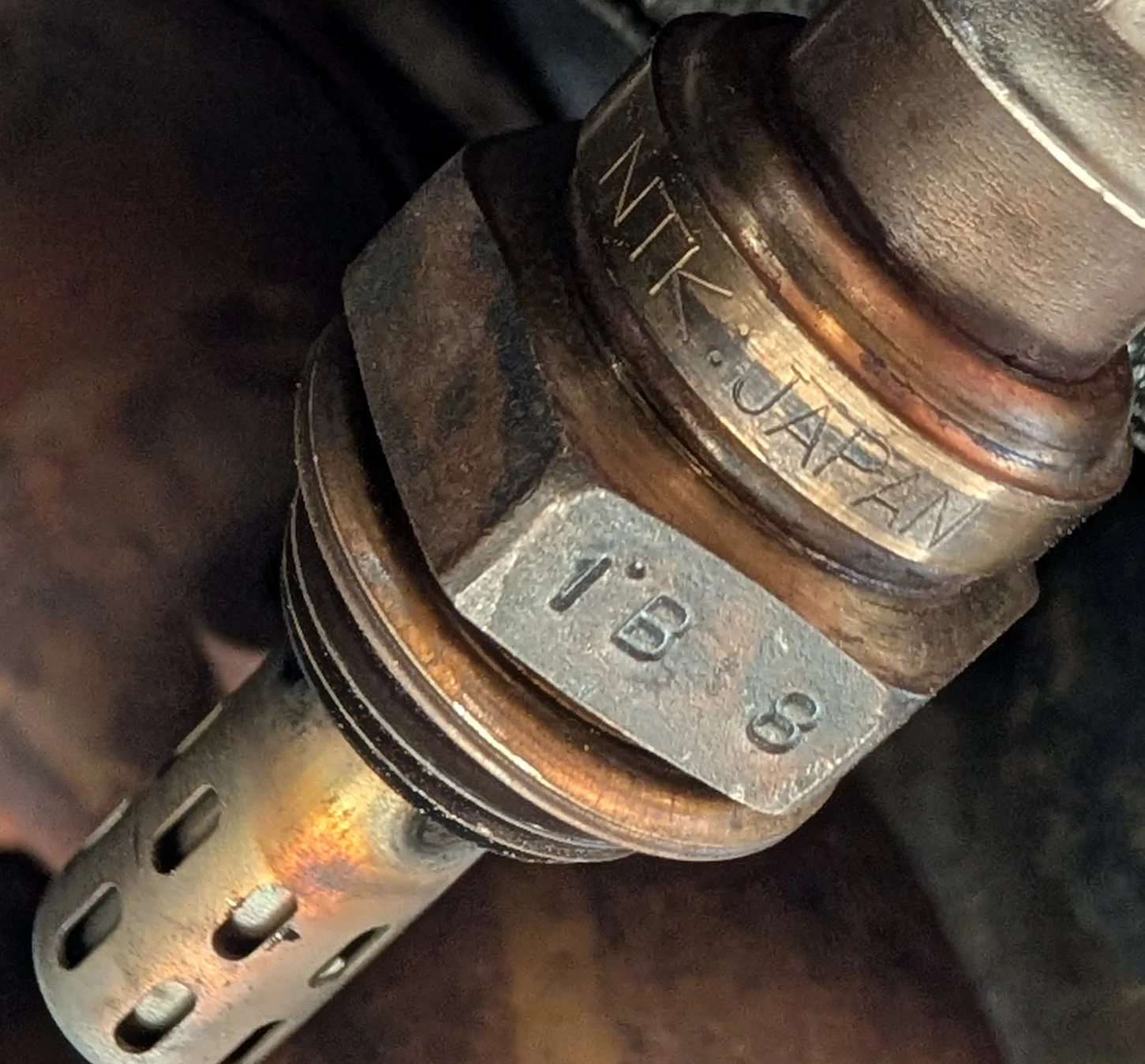

I bought an '01 TJ Sport with a 4.0L 6cyl in late '24 and have been doing lots of small things to get it fixed up. But I'm not sure how to proceed with the CEL for the O2 sensor (sensor 2 bank 2.)
The mileage is 200k, but I've been told that the engine was rebuilt at 130k (which may or may not be true.) Mechanically, it's stock.
The previous owner replaced the O2 sensor, but it did not fix the CEL. I've cleared the code a couple of times, and the CEL comes back. Once in about a day. Once in a couple of hours. Here's the sensor he put in...

Do you have access to an OBD2 code reader? One with "live data" functions?
If you do, start the jeep and let it run. Your oxygen sensor should read between 0.1 volt, and 1.1 volt on the live data function. If it does not, try a new one.
I have not had much luck with NTK oxygen sensors. Walker oxygen sensors have worked better for me and my friends with 4.0 Jeeps.

I have and 01 sport manual 6cyl 4L. I had to purchase a couple times until I got an ngk one that worked right and kept the codes cleared after I installed and cleared them. Not sure about quality control on those things. But it cleared. However I eventually ended up replacing the precats as that was really what was causing the issue. I have 180k and the originals lasted that long.

I had that code with a new o2 sensor. Turned out to be a wiring issue. Make sure the plug is fully seated on the sensor to wiring harness. Inspect all pins for any damage/loosness. Then check the plug that goes to the engine wiring harness. Mine had a loose pin that wasn't making contact. Once fixed, light went away almost immediately. Plus gas milage was improved dramatically
