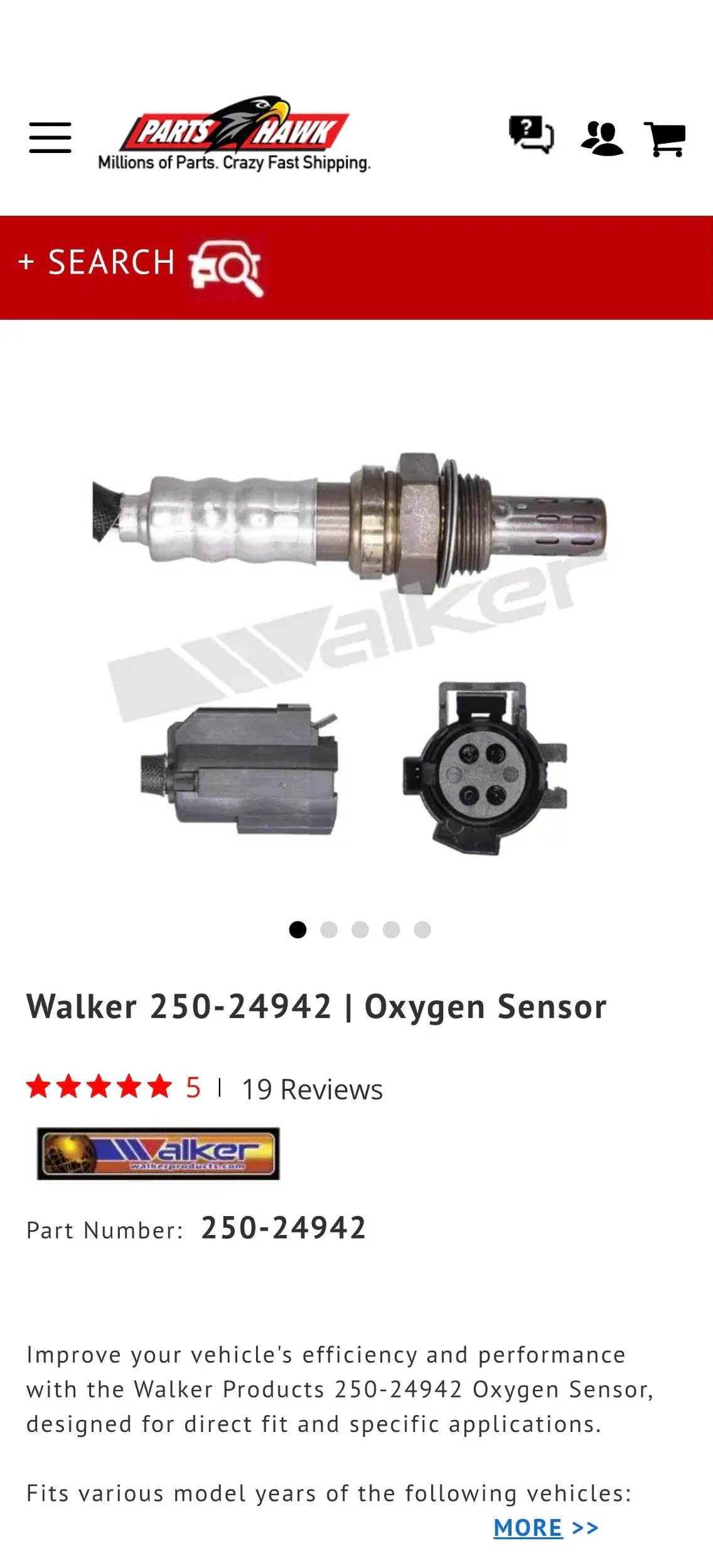

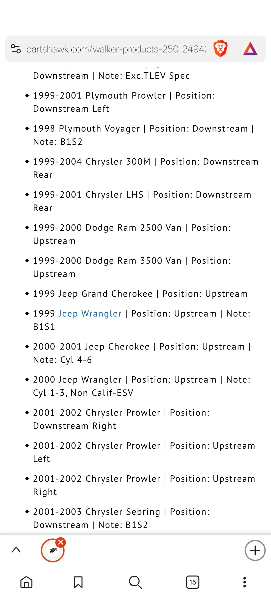

You know Awayne I think this you have mentioned is like that. That the 943 up and the 942 down are gonna work, because here in spain the refs have to do with that ones. Here they only have the oem refs
56041212AE (up) 943
56041213AG (Down) 942
For the 2 sensors 4.0 in Europe
And that is the same you are saying so it would have to work.
The only thing I dont understand is that I thought you said before you installed the same sensor up and down. The other walker ref.
Thanks for This thing you have wrote, has give me some light
