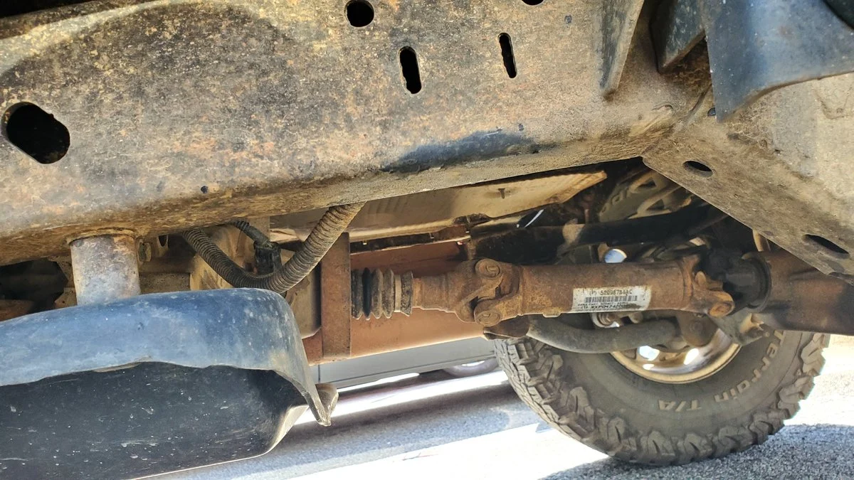

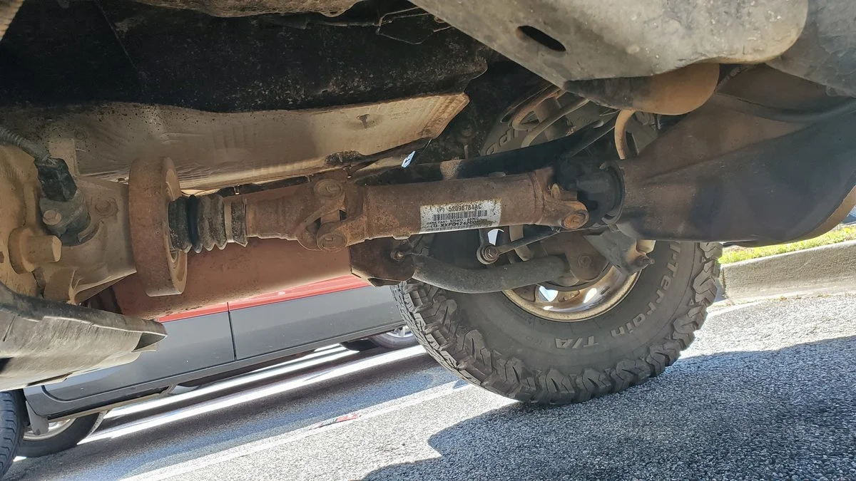

Hey all! So I've had my TJ about 8 years now and I'm a member on some of the other forums but new here. I'm replacing my track bar, ball joints, and probably U-joints to help eliminate some vibrations. And don't worry, I read the DW thread already and will be going to an offroad shop to get my tires balanced properly after I do that. This has gotten me into "project mode" now though lol. I came across this thread and while I know I don't have an SYE I was hoping someone can explain what the PO did to the driveshaft. What is that large disk on the slip yoke? I haven't seen that before.

That's the factory driveshaft. The previous owner just put a hell of a large transfer case drop on it.
If you're looking at that round disc thinking it might look odd, that is the factory harmonic balancer. It's usually removed when installing a SYE.

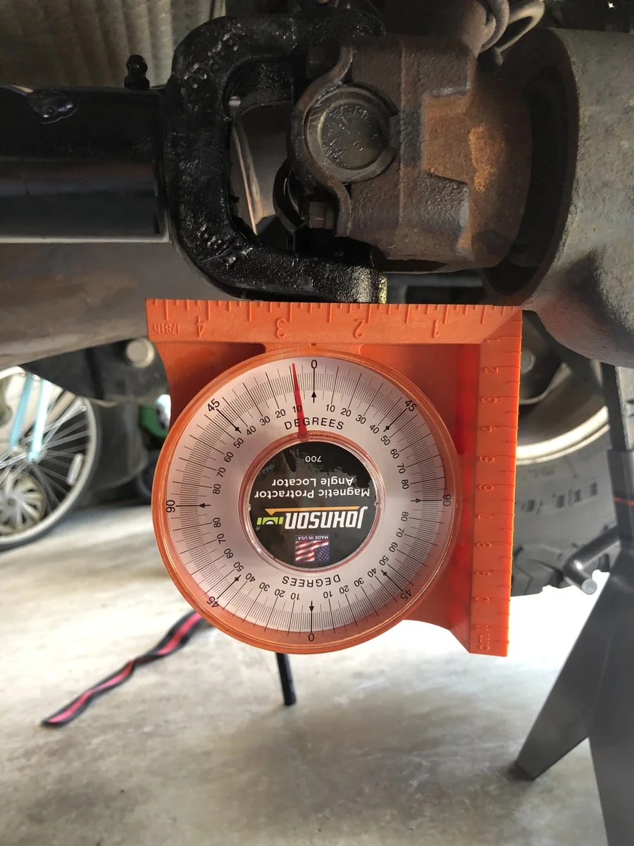

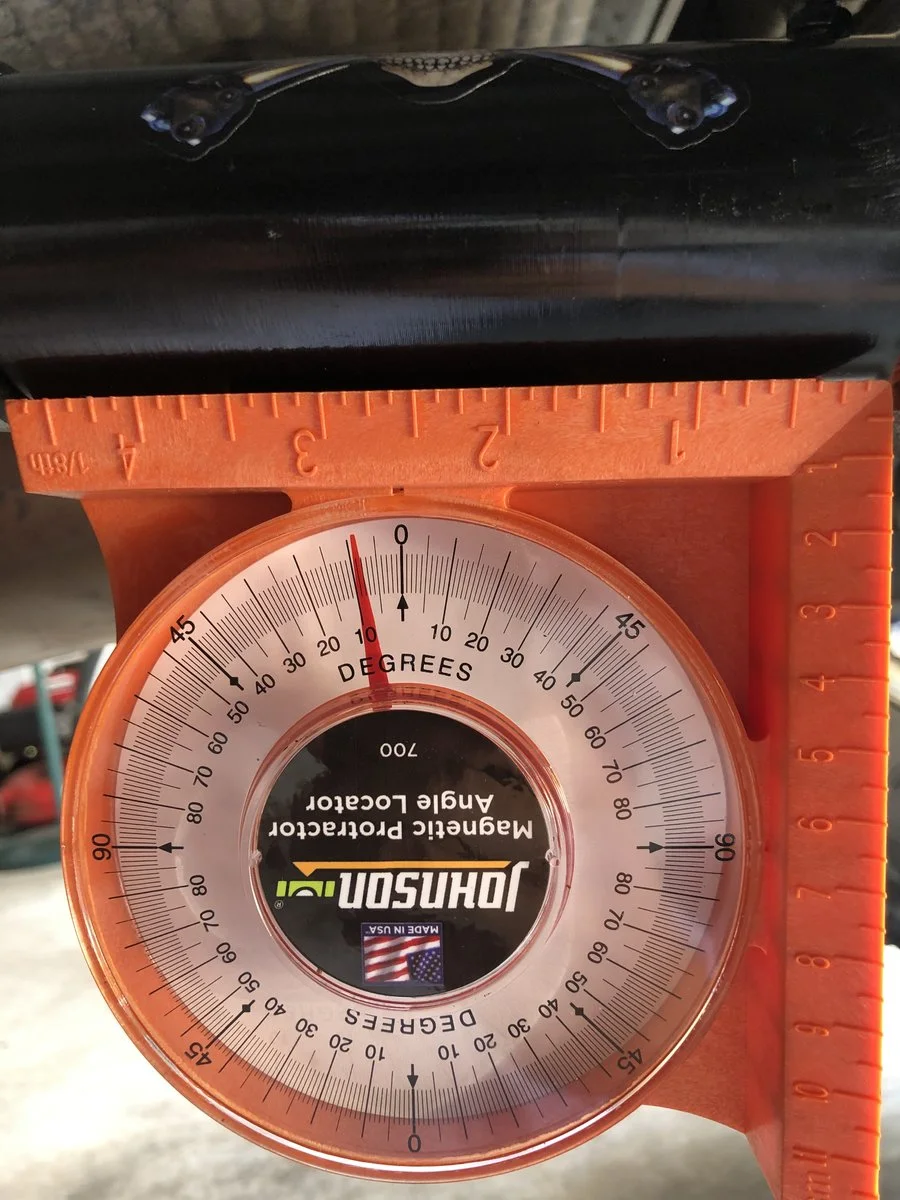

I’m finishing up my install and I have a question: Am I measuring the angle of the differential correctly?
If so, how does that look? Does the pinion yoke need to come down a bit or is that within tolerable limits?
Measure the angle of the pinion like you are, but then also measure the angle of the driveshaft as well. The driveshaft should be around 1-2 degrees lower at most. The reason for this is that when you accelerate, the pinion is going to rise up slightly, thus making the pinion and driveshaft almost equal.

when I put it on the driveshaft it’s about 9 degrees.
