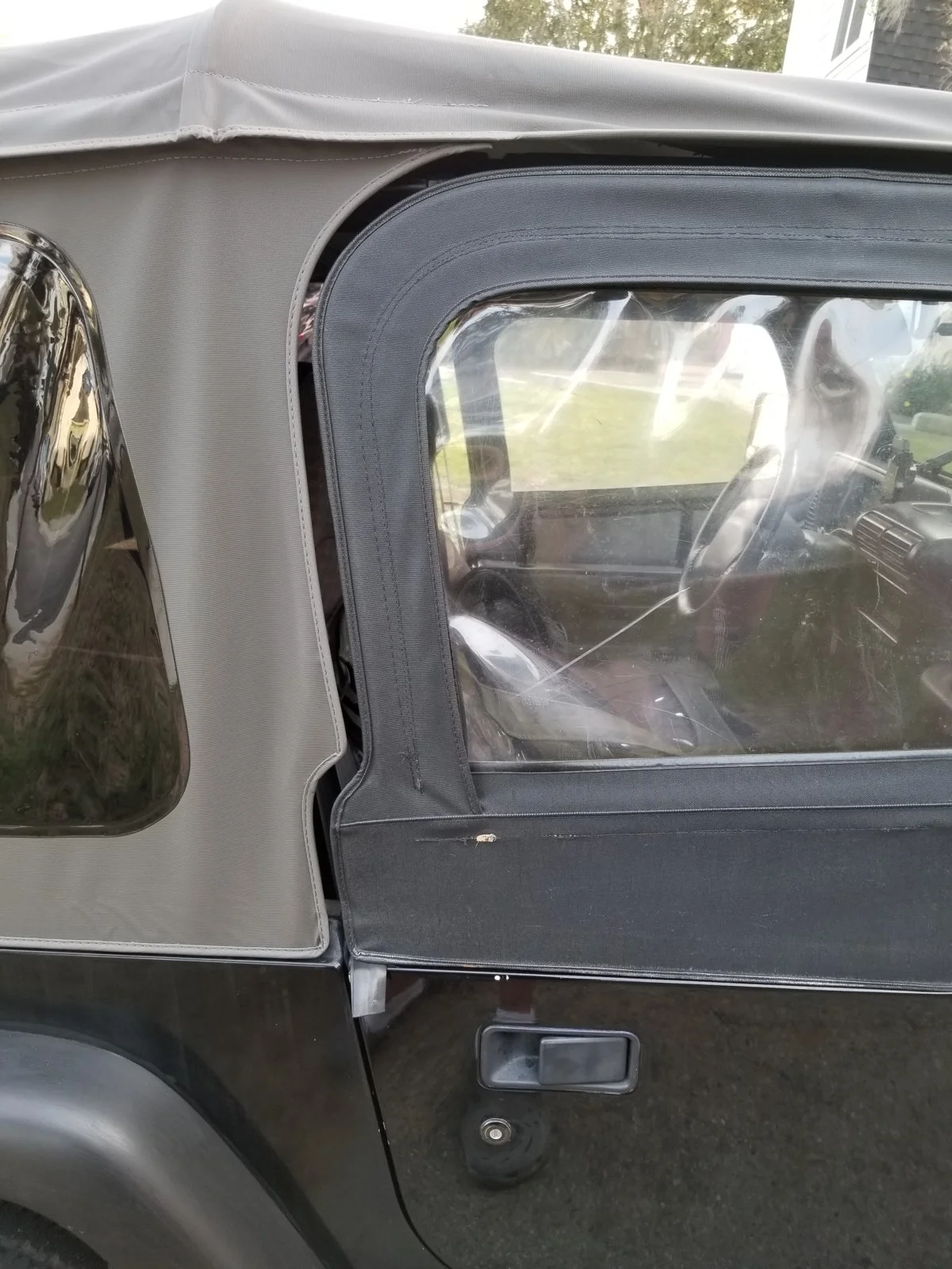

This looks like a hot mess. Typically, you cannot put up a top without the bows. The bows not only give it support but also us what you use to bring the top up and over everything. I don’t know how you can attempt to do that backwards.
The front attachment to the header also looks messed up. It is possible for headers to be top specific so not sure if that is even the right one. It does not look right and certainly doesn’t seal right.

I don’t have any soft top experience but it looks like the bows aren’t in the right place to begin with. In the picture above showing the interior of the Jeep, why is that bow by the roll bar? Is that not supposed to be all the way back first before you set the top on? Get your frame in place first and then start putting the top on.
I did that first. And ended up with a 2 inch gap to get my side window into the slots along the body. Which was impossible to do.
So I switched to moving the bows down. Getting everything fit and zipped up. And then I'll be applying heat and trying to push the bows into place.

That’s going to give you nothing but troubles. I hate to say it, but pull the top and start over. Put the bows in the correct location and figure out what you’re doing wrong. Start from the front and work your way back. You’ll never get the bows to fold back with the top in place.

Read my post above about the bows. I've already tried it with the bows up. And am left trying to get the bottom of the window into the slots on the body. Impossible to do in it's current coldness and non stretching state.
I may agree with you on the header. When I started I was shocked to see bolt holding my clamps on the header. And not a simple latch that you could latch by hand. I was told I have the OEM header from early TJ's. Mine is a '99. So maybe there is another bow that will work better. But when I contacted Rampage they directed me to their bow. But it looks exactly like mine. So I'm at a loss.
Until I can really heat it up I won't know what the real issue is. But I will be playing with the header again. IF the bows won't go up into place.

So you have the door surrounds in and the top attached to them? The top fits into the surrounds pulling it back some also. Temperature or not, I don’t see you stretching that material 2-3”. Meaning there’s a step that you’re missing.

I don't even have door surrounds in. I didn't have them. The soft top this is replacing didn't need them. I have a new oem set coming.
If I'm only supposed to be an inch or so off because of cold. You're right. Something is wrong. But I suspect it's not the install or cold as much as it is the top. But we'll see. I still haven't tried any of these steps with a heat gun.

Done the textbook way (meaning front to back) the passenger side looks like this. Pretty much perfect. With the exception of the surround missing:
But at about where this pic ends on the left. It won't go into the slot on the bottom on the other side - the drivers side. You end up with a big gap there in the front half - bottom of the window. ABout 2 inches at the front end where it meets the door.
So like I said. You can either make up the gap in the zipper, in the slot at the bottom or inside with the bows. AFter trying to do it with the zipper and the bottom slots. I am now going to attempt to do it with the bows. As the zipper felt like it was breaking. And the plastic trim would not go into the slot at the bottom no matter how hard you pulled down on the top. You'd have to attach something alot heavier than a bowling ball to the bottom of the top to get it to go in the slot. But with 2 inches to make up - it would probably tare before it stretched down that far.

To me, those middle bows are way too high and that is what is causing your issue. That’s my over-the-Internet professional opinion from what I can see. Are you sure that the bows are 100% in place? Nothing causing them to bind up or give you troubles? I’m not trying to tell you the answer or how to do it by any means. Just trying to help you eliminate any possible issues.
The bows are definitely a tight place. But they are in the same position as when I took the old top off. They aren't adjustable. Except for the back one you have three or four position slots you can tighten it with. But even trying to get it in the least tight setting. It won't go. Without heat that is. The most heat I've had is that space heater set at about 80f. But with several gaps around the top. It didn't hold in much heat.
