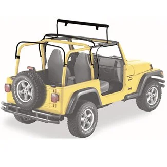

A) This is the OEM factory style frame. See how much bigger the windshield header is? The part that goes on top of your windshield? It has quick clamps that are alot easier to put in place. And tops made for this style frame have alot more fabric up front where that attaches. This header will attach to your soft top with screws. But is alot easier to get your soft top off and on:

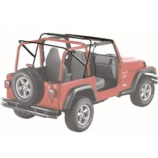

B) This is the Bestop Supertop frame. It has a slimmer windshield header made of metal and plastic that bolts down to stay tight. Doesn't require as much fabric up front. But takes a wrench and some finagling to get it to mount right. Isn't as easy to take your soft top off and on:

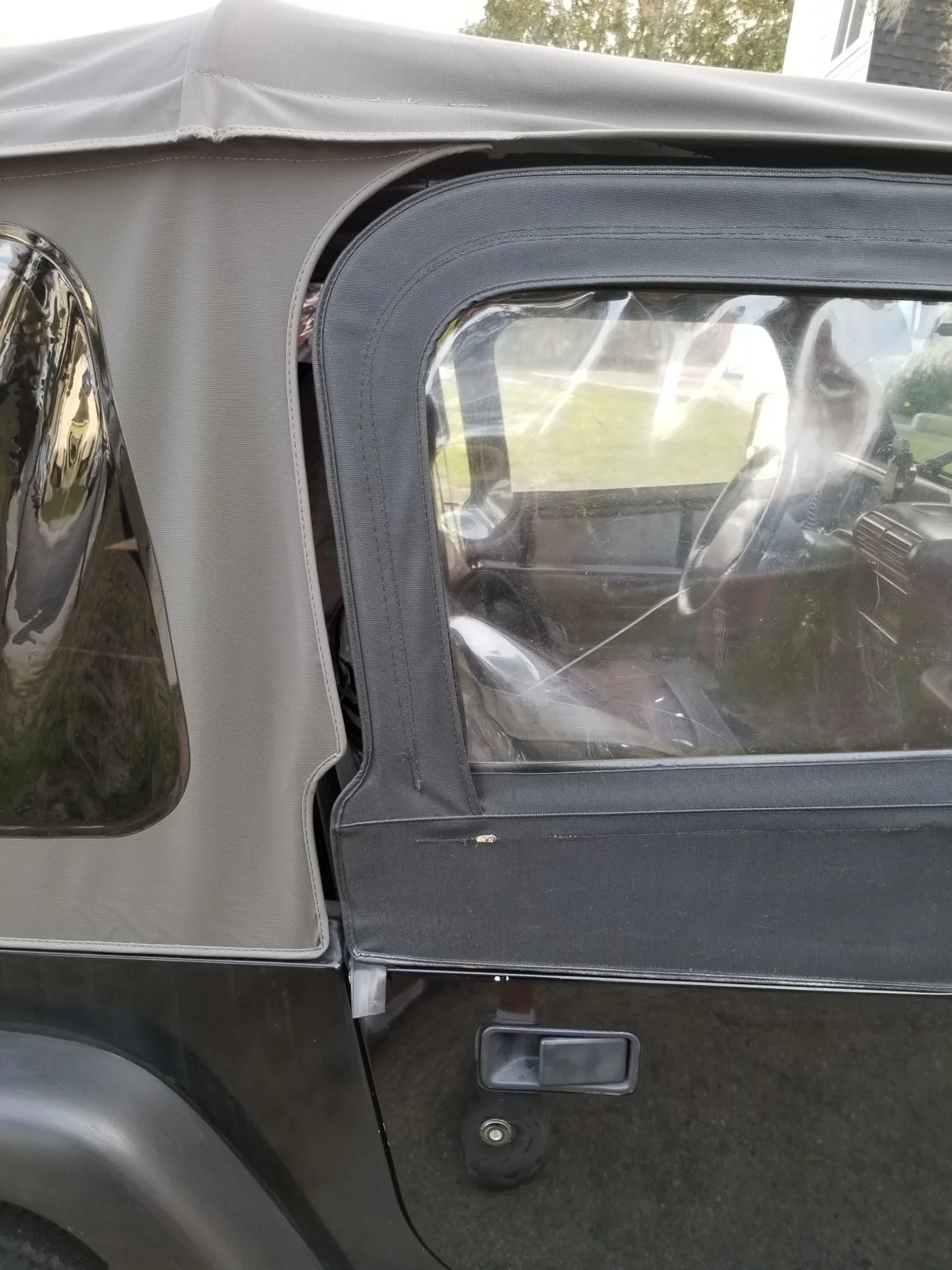

2) Don't try to put your soft top on on a cold day. Wait for some sunshine. Or heat your garage up to 70-80f. Try not to use too much heat gun. If it doesn't go on it can actually shrink the fabric. It did this a tiny bit when I was trying to get my upper door skins on. And I could see it shrinking the rubber rain gasket around the outside. Be careful with heat guns. I've seen them used on YT. But those skins appeared to be going on during a warm day. And did not seem as tight as mine. Which leads me to this...
Secondly, soak your upper door skins (if you have them) in the hottest water you can find. And then try to put them on your metal window frames. It will save you alot of aggravation. And possibly tearing something.
*Start with the pointed corner first at the bottom front of the window, then the larger square corner at the bottom rear of the window, then the next sharpest corner towards the upper rear of the window, and lastly the longer rounded corner on the top front of the window.
On the last long rounded corner at the top front of the window - your going to need a blunt and smooth prying tool. I used the handle of a medium to large sized crescent wrench. It went on fairly smoothly. And that was after trying five or six times with other techniques. Use the hot water. And work quick before it cools off. Once it dries in place you'll have a perfect fit. These were made to go on tight so the wind won't make them flap. And buddy they are tight. Especially in the winter.

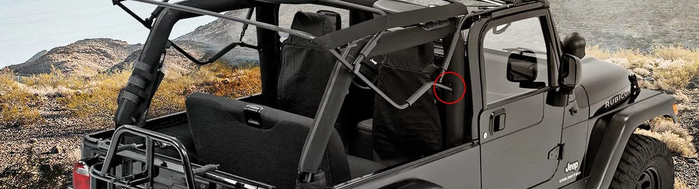

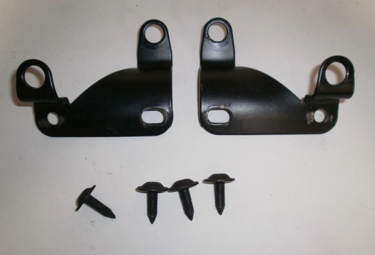

3) If you don't have the correct frame. Also make sure you have the correct frame bow brackets that mount to your Jeep for your frame to hold onto. They are very different. In fact both frames are very different. And the OEM frame appears to be alot easier to use (taking your top down and putting it back up) than the Bestop Supertop frame. Just my humble opinion. Others have chimed in with a similar opinion.
Soft top bow brackets look like this:
And are attached to the roll bar (on an oem factory style frame) just below the front seat belt mounts. (The Bestop Supertop frame connects to the top of the rear body panels. As seen in the pic above of the Bestop Supertop frame.) There are two small slits built into your roll bar covers at that point. Allowing the bow bracket to stick out of the padding once mounted to the frame. You have to remove the roll bar padding and I believe the seat belt attachment to mount the bow brackets on an oem frame. Then you cover the bracket with the roll bar padding and cover. And then reattach the seatbelt mounts:

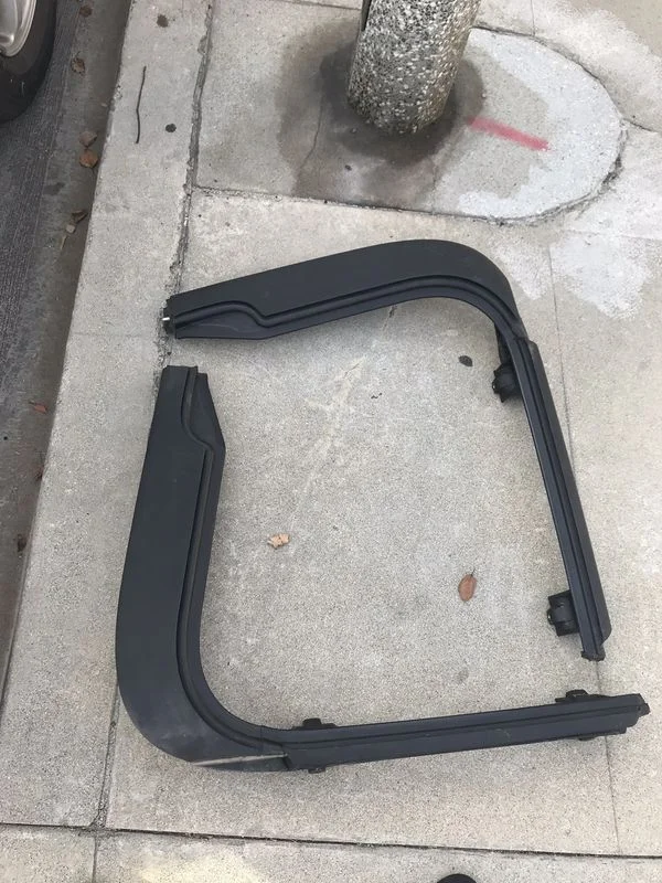

4) You'll also see door surrounds just to the front of that red circle above (And on the picture of the OEM factory style frame above). My frame (I assume it was a Bestop Supertop frame) did not come with window surrounds either. They make up the gap between the soft top and the upper doors. (On a Supertop there is no gap. The soft top extends below and behind the door uppers. Whether you have half doors or full.) So I had to track down a set of window surrounds as well. I paid $150 for a new set. That was the same price used at my local junkyard. Although surrounds often come with a full frame. But shop around. Used oem soft top frames can be found for a couple hundred used on CL or Offerup.

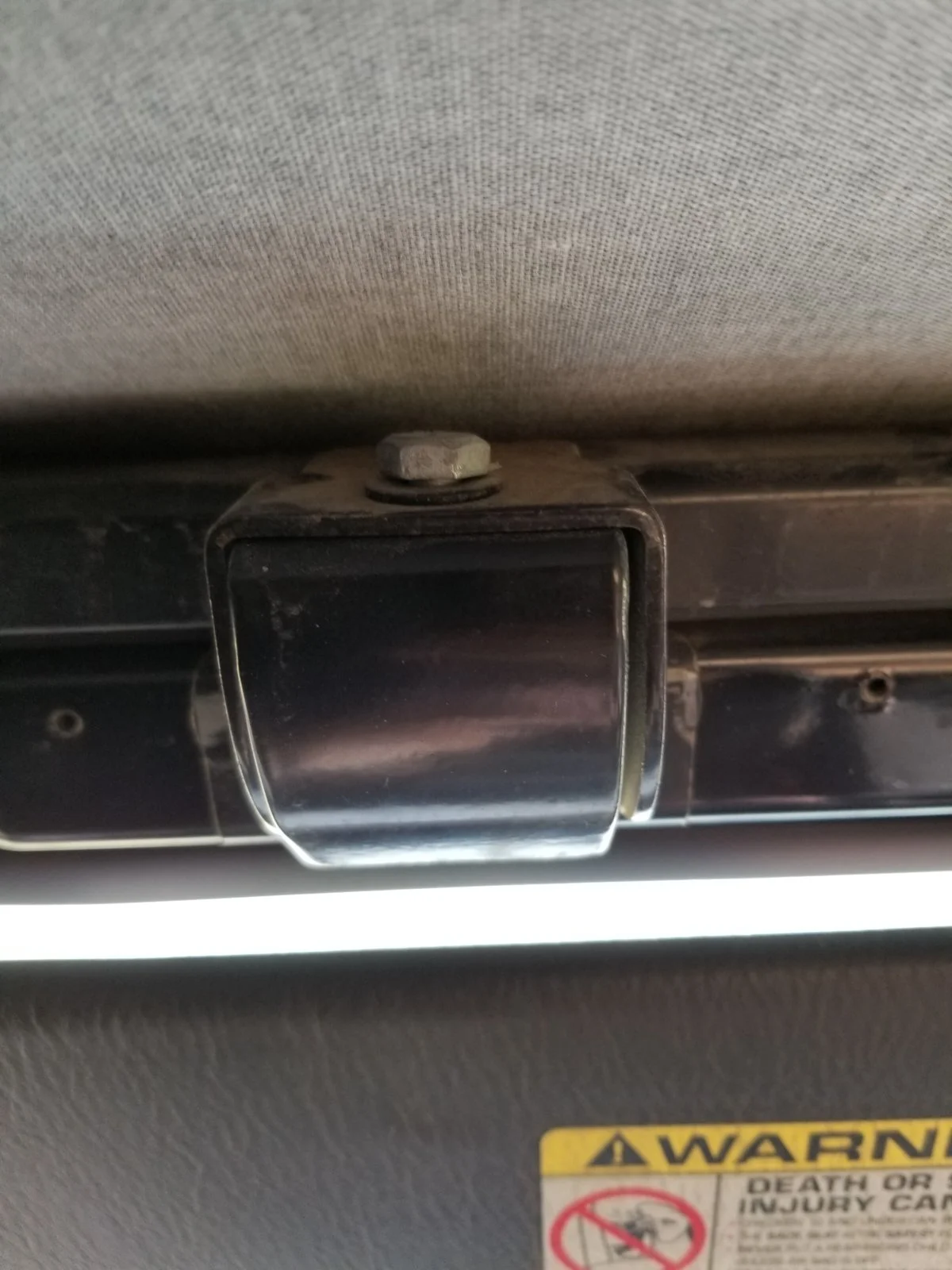

Is this stock or aftermarket? I'm about to remove my top and replace it with a Rampage. Just curious what those bolts might mean for putting another top on that's a different manufacturer? I assume it's just to hold the clamp tight. But I've never seen this on any of the tutorials or YT videos I've watched. (This is where my trouble began. I did not realize I had a Bestop Supertop frame. And that I needed an OEM factory style frame.)

Stock. It came on early models. You're right, they are used to tighten the clamp to the windshield frame. If your rampage top comes with a new header bar and clamps, they will work too.

Thank you so much. Is there any reason to believe a new Rampage soft top won't fit on a stock frame like this?

I am not to familiar with rampage tops. Are you using your existing hardwareuse? Does the Rampage top use a new windshield channel?

I'm using the oem channel. And it's not fitting to the top. I'm going to call them and see if theres a new channel I need to buy. I'll post pics in a bit.
My '97 never had those type of latches. They look very much like the type of clamps used on the bikini/safari top headers you always have to remove when you put your regular top back up.
Same. I guess thats what I meant by stock, my safari top uses this type of header channel. My bestop softtop uses clamps

What are these called? I need a pair. And what year range will fit my '99 TJ? And how much do they run used?
The directions from Rampage (Lund) suck. It shows you having to screw the soft top into the windshield header. Which don't exist on my older stock header. And then when I called and talked to their tech. She had no clue that you had to double over the plastic on the front of the soft top and wrap the top around the entire header instead of just putting it in the channel in the header like it does stock. It is a better fit IMHO. But it would be nice if anyone at Rampage knew this. She actually said "sometimes they fit but sometimes they don't. Because we have these made overseas.".
Further it doesn't say you need those things above. Again I use the term cluster...whatever you call it. ;) I found some local but have no idea how much they are worth or what years fit my '99.

Door surrounds. 97-06 will fit!

MEantime I'm on the hunt for door surrounds. Found new ones for $58 plus shipping. And am negotiating over a used set. I guess those just come off when you take your top down? I'm really bummed I have to buy/use them. But I can't tell with any soft top - which ones you need them for and which ones you don't.
