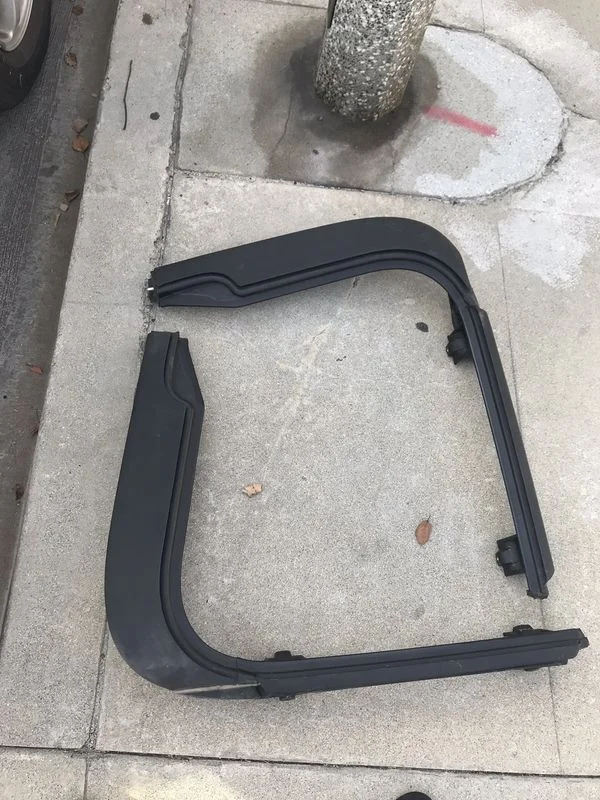

What are these called? I need a pair. And what year range will fit my '99 TJ? And how much do they run used?

Sorry for your troubles. The header with the clamp and bolt is not stock, that's part of the confusion. The stock soft top does indeed wrap around the header and screw to it in several places.
Why do some tops require surrounds and some don't? And why don't they specify? My top that I had (not sure but it looked original) had no surrounds a soft top with half doors.
The reason that some have them and some don't is due to the licensing agreement Bestop had with Jeep. Bestop designed the OEM soft top for Jeep with the door surrounds. They were not allowed to produce them or make a top that used them until that agreement expired in about 03 or so. Previous to that, all tops made had to make up their own version of a door surround or get a cease and desist letter from Bestop followed up by more serious deterrents if production continued.
One may wonder how I know such things. When I was helping Thor on the original design of the Rampage top, he designed it to work with the factory door surrounds. He did in fact get that letter with a very small but highly important caveat. They let him know that the agreement with Jeep would be expiring in a few months.
I would assume OEM window surrounds are better than aftermarket? OEM is about the same price. And for a set that doesn't need painting.
Where are you finding aftermarket surrounds? Used OEM typically go for 100 bucks. I wouldn't mess with aftermarket for that price.
Small correction: All TJs with soft tops come with door surrounds from the factory. My LJ had full doors and a hard top, but no soft top. It did not come with door surrounds. I ended up buying a soft top package from a dealer that was getting rid of old inventory and it included the door surrounds. (Note: the door surrounds for an LJ are different than a standard TJ. The LJ has an extra spring-loaded clip at the top where the door surround curves. The soft top frame attaches to the spring-loaded clip. It looks like they added it so they could add the fold-over sunroof - it keeps the top attached when you release the front header to fold open the sunroof.)

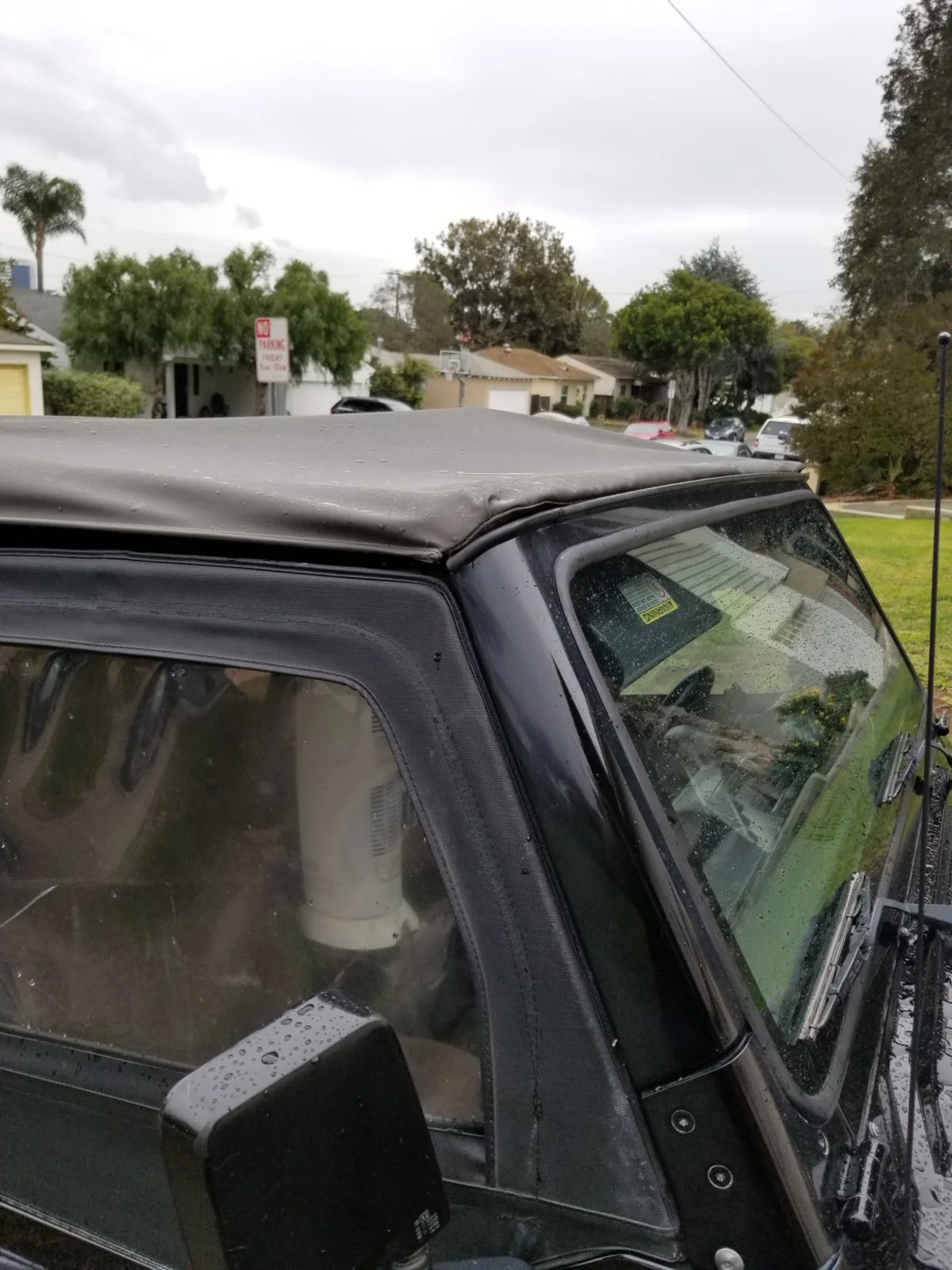

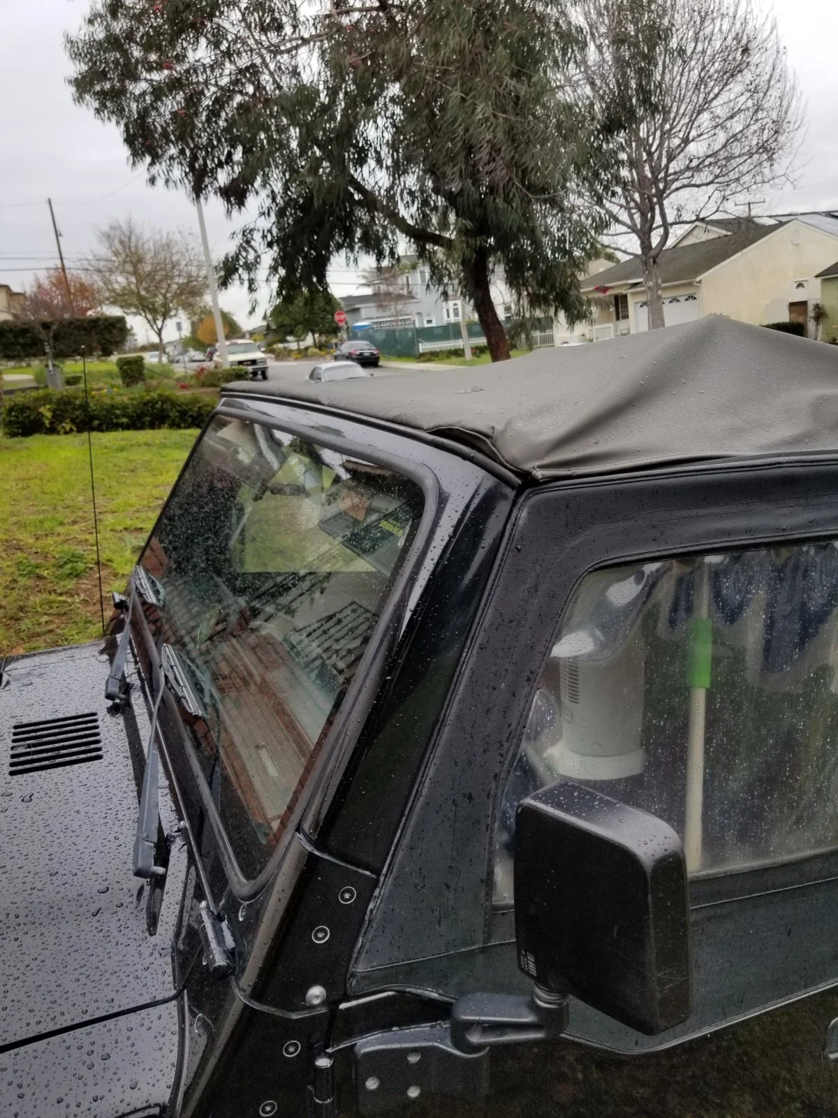

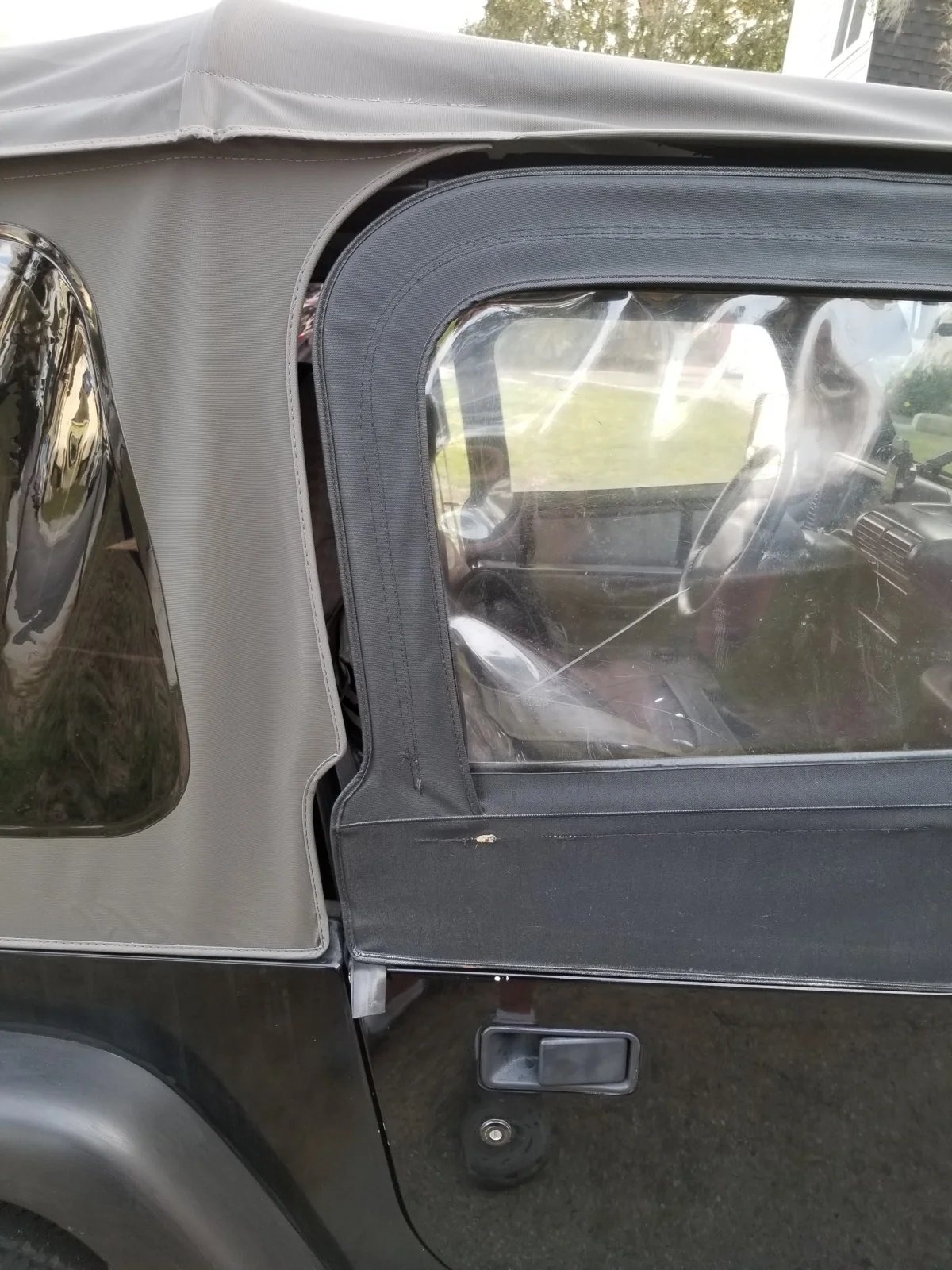

Here are pics of where I'm at. First you can see how the top ends up on the header after wrapping it around the entire thing. You can see that it's a pouch of fabric up front. For either a much larger header or to be wrapped around it period.
The other side needs to be better seated around the header. I had to overlap the plastic strip one time and then wrap it around the header to get it to fit correctly up front.

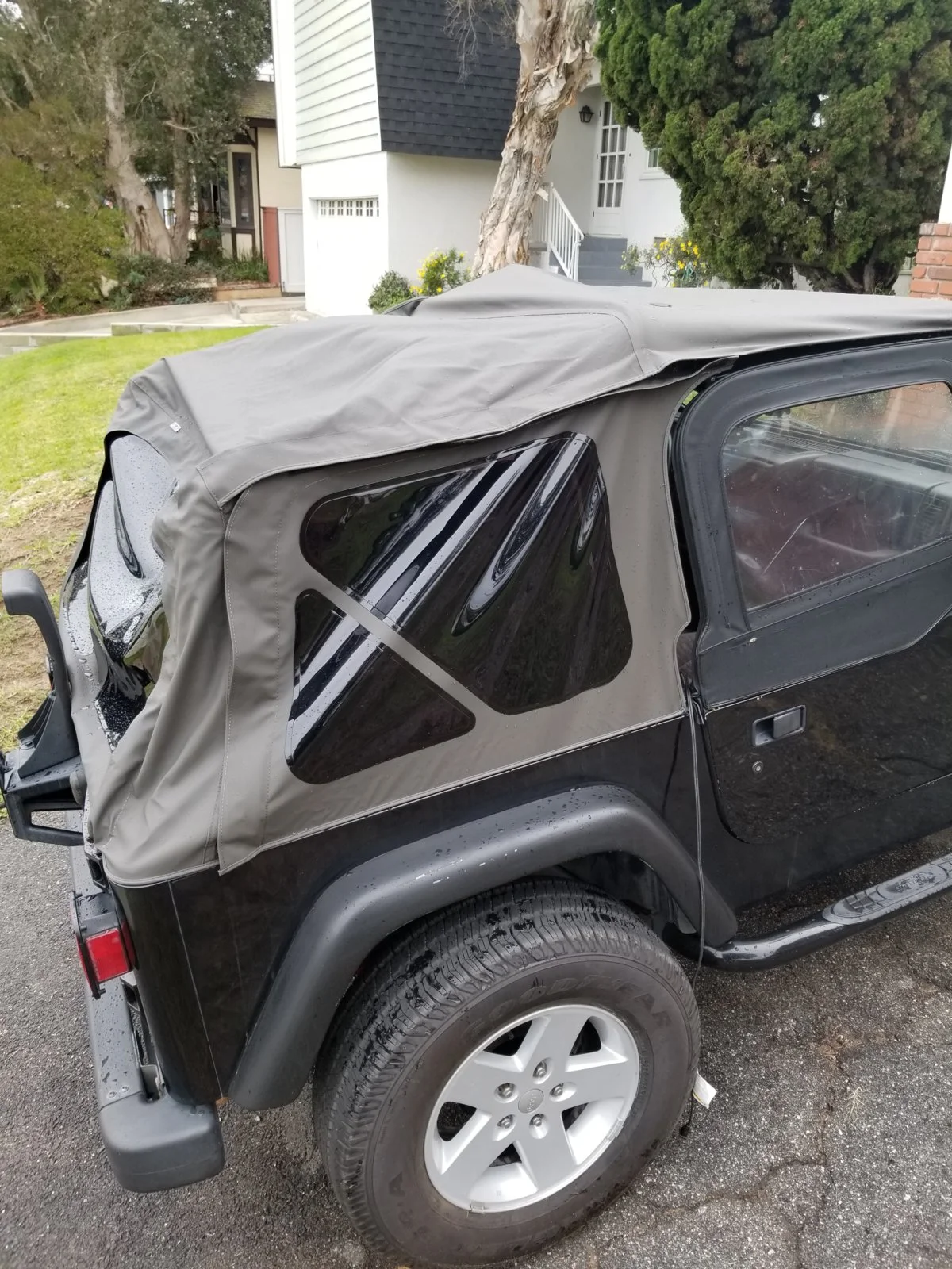

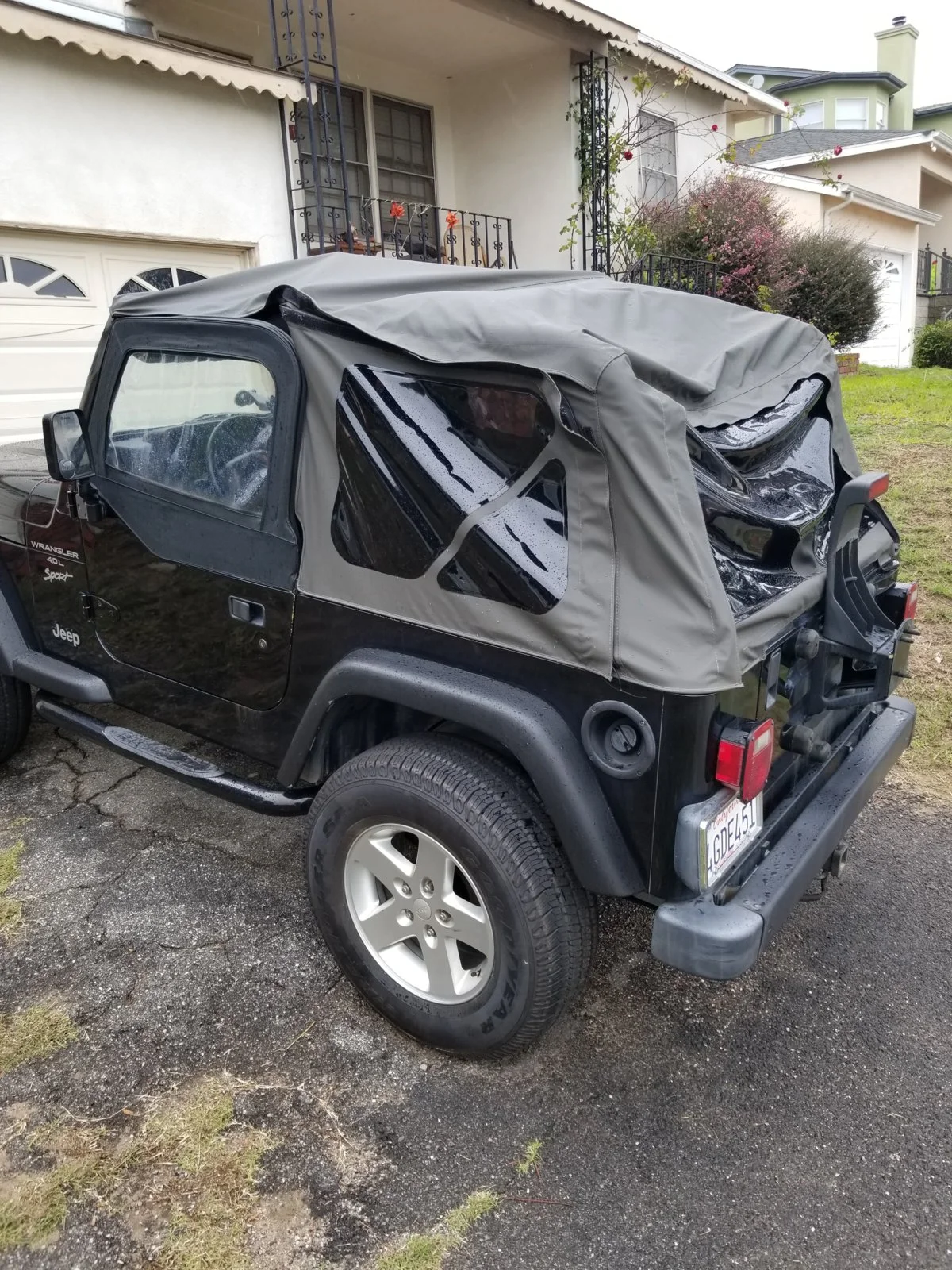

This is it zipped and clamped on. Without the bows being fully extended. My next attempt is going to be heating the ridgeline up with a heat gun. And trying to get the middle bow up all the way and into the velcro.

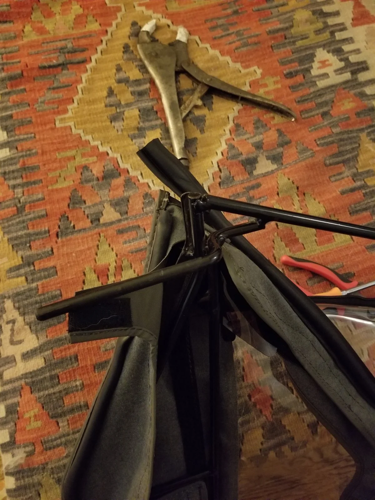

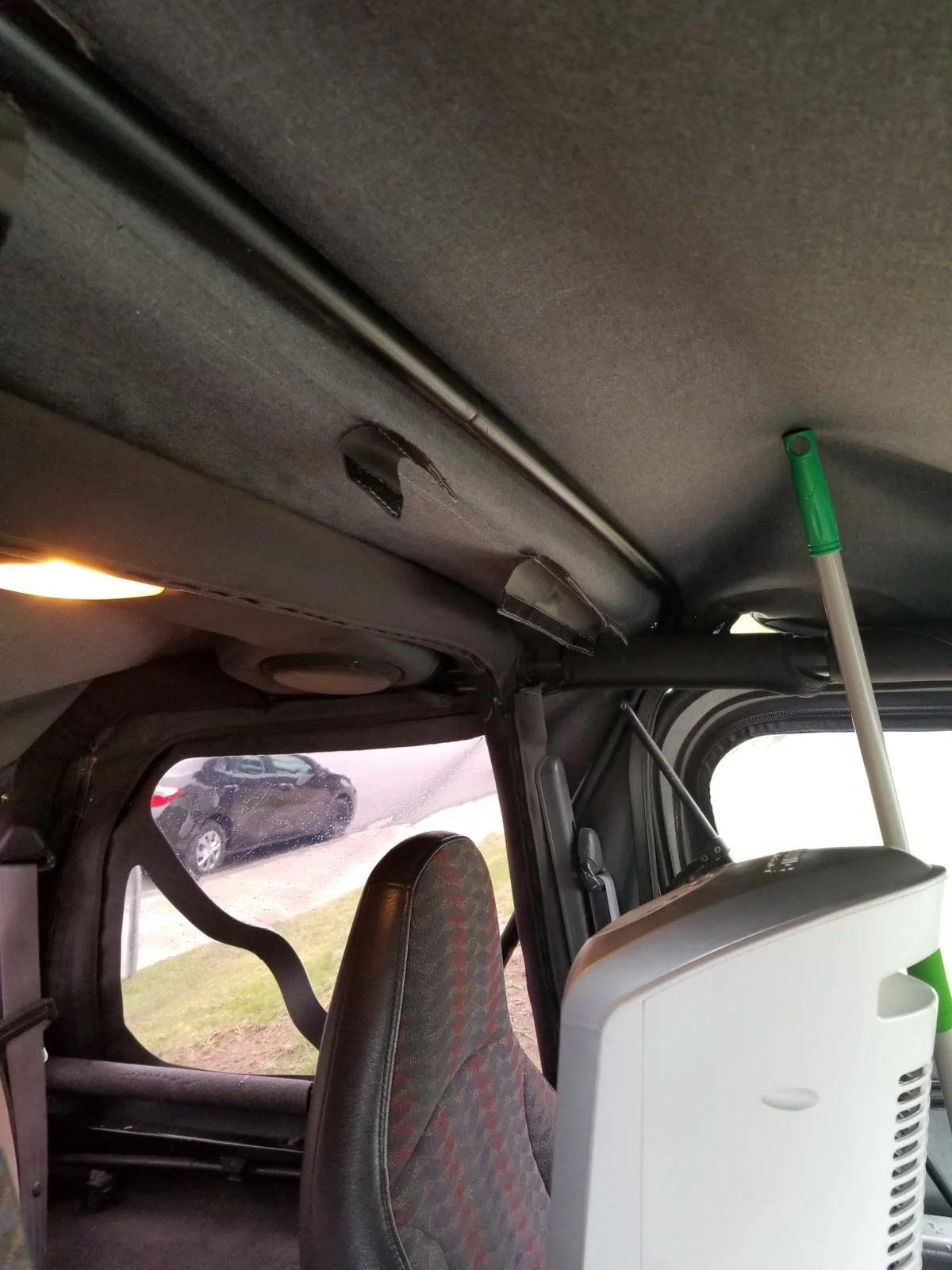

Below is how close the middle bow is to being centered and in it's velcro sleeve. (If you notice the black foam on the rear bow that is lying down. I had to cut that off the middle bow. As there was no way the middle bow was going up with it in place. And the velcro on the soft top wasn't reaching all the way around the foam and the bow. Only the bow. So I cut it off. I can still slip some in there later. But I think using the velcro sections on the soft top will better hold it in place. Than if it was just riding loose with the foam on it.)
The back bow is not up at all yet. It will go about 3/4 of the way up. But then stops as the top is not loose enough for it to go all the way up. I may try cutting the foam off it too. As I think the velcro fittings on the soft top don't go all the way around the foam and the bow. Just the bow.
Again, I'm going to try to use heat to get it to loosen up. And hopefully extend the bows out all the way. Ignore the mop handle. That's just to keep water from pooling up on top. I tried just using that heater set at 80f to it to loosen. But at that time the gaps were to big and alot of the hot air just went out the gaps. Now that it's zipped up. The only gaps are where the surrounds should be. So maybe if it doesn't rain tomorrow. I can heat up the inside and hit the outside with the heat gun.

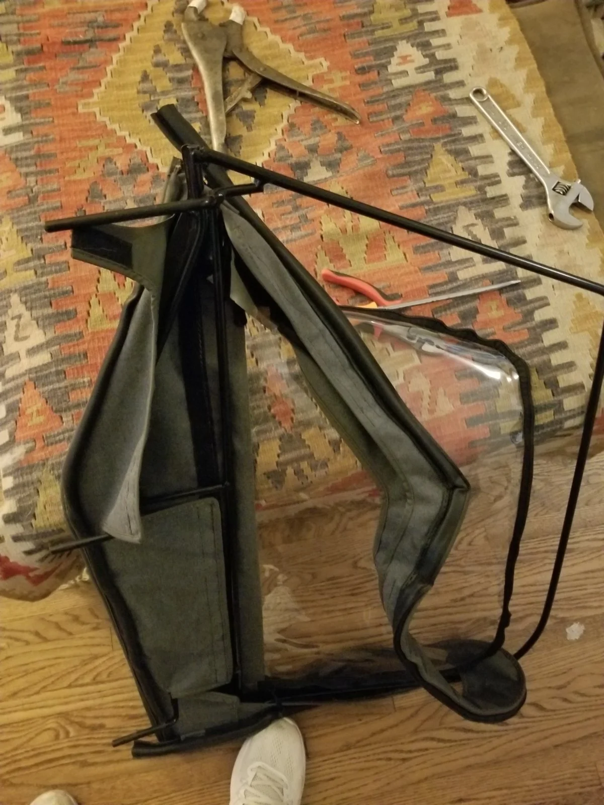

Below is one of my upper door skins. You can see where i've started with the square corner first. And then trying to get the pointed or front bottom corner installed next. Even heated I'm a good inch off. And it has to seat kind of deep into the corner pocket. I think I'm going to soak them in complete hot water in the bath. And see if they will go on then.

Man, I feel your pain. That top around the header, and the bow locations look like crap. Did you happen to take a photo of the header prior to installing the fabric?

It looked better on the Jeep when the bows were up and there was a two inch gap along the bottom of one window. But getting that bottom of the window into the slot in the body. Was alot harder than trying to get the bows up. AT least on the bows you can push it into place. (Once it's flexible enough from heat.) Trying to get that plastic to go in the channel was impossible. It just wasn't happening. If I can get a sunny day I may try a couple completely different tactics. Like loosening the header. And trying to get everything else buttoned up and doing the header last. But that part was such a bitch. I'd be reluctant to try it again without some help. If I could get my son out there on one end with me. I could probably get it in ok. But really two people on the header and one with a ratchet to tighten it down is best. If I had the normal kind of latching header it would be easier. As these aren't really latches on mine. It's a fitting with a bolt in it that tightens it down. So nothing snaps quickly into place.

For the door skins, the sharp pointed corner goes in first. Opposite diagonal corner goes in last. As for the top, I can not tell what surrounds you have.
What I do know is we installed a top on Monday. A new OEM top that had never been unrolled from it's factory ship position. We also had to modify the bows in the back to clear a fuel filler neck. We just put a propane heater in the back, covered the whole mess with a tarp to keep the heat in and monitored the temp and watched the wrinkles flatten out.
Your windshield header does not look correct.

What doesn't look right about the header? The header itself or the the way I have the top installed into it? And if it's not the right header which one should I be using?

I don’t have any soft top experience but it looks like the bows aren’t in the right place to begin with. In the picture above showing the interior of the Jeep, why is that bow by the roll bar? Is that not supposed to be all the way back first before you set the top on? Get your frame in place first and then start putting the top on.
