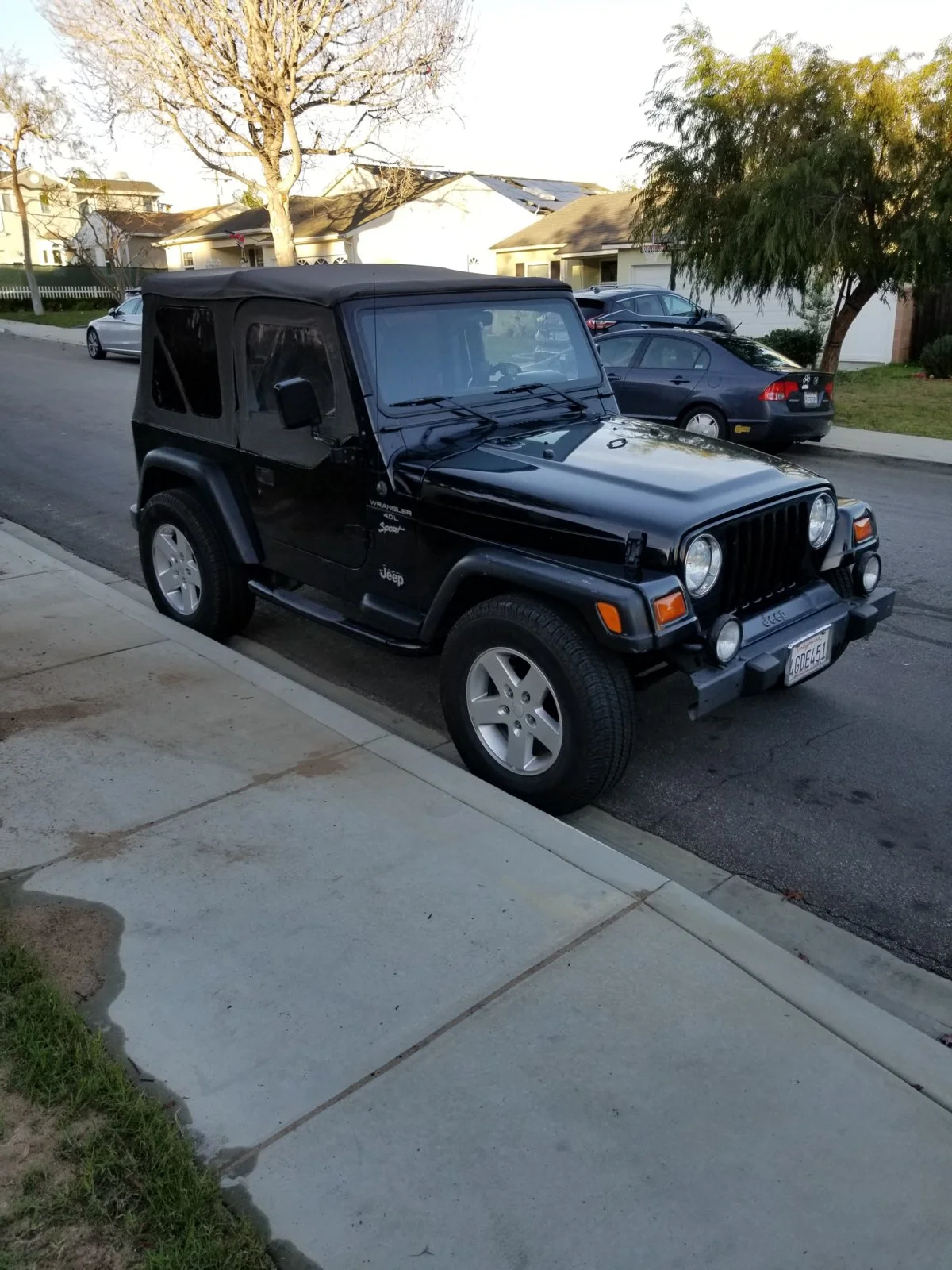

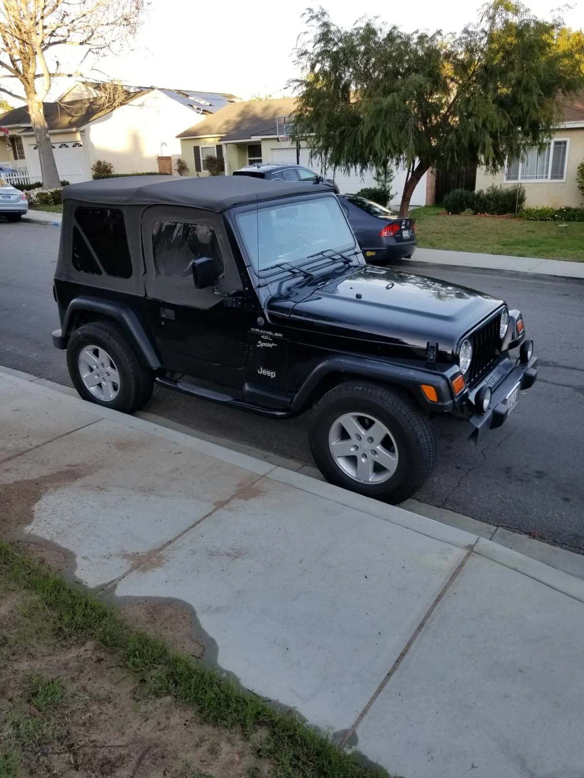

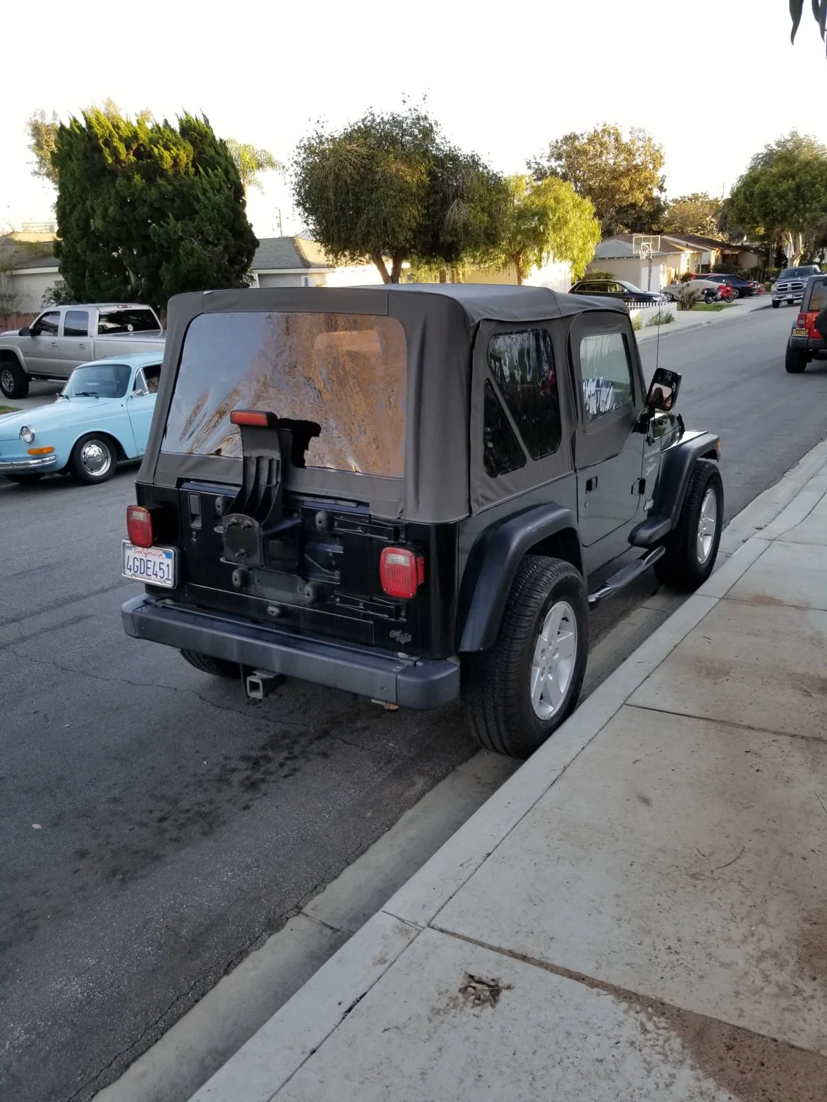

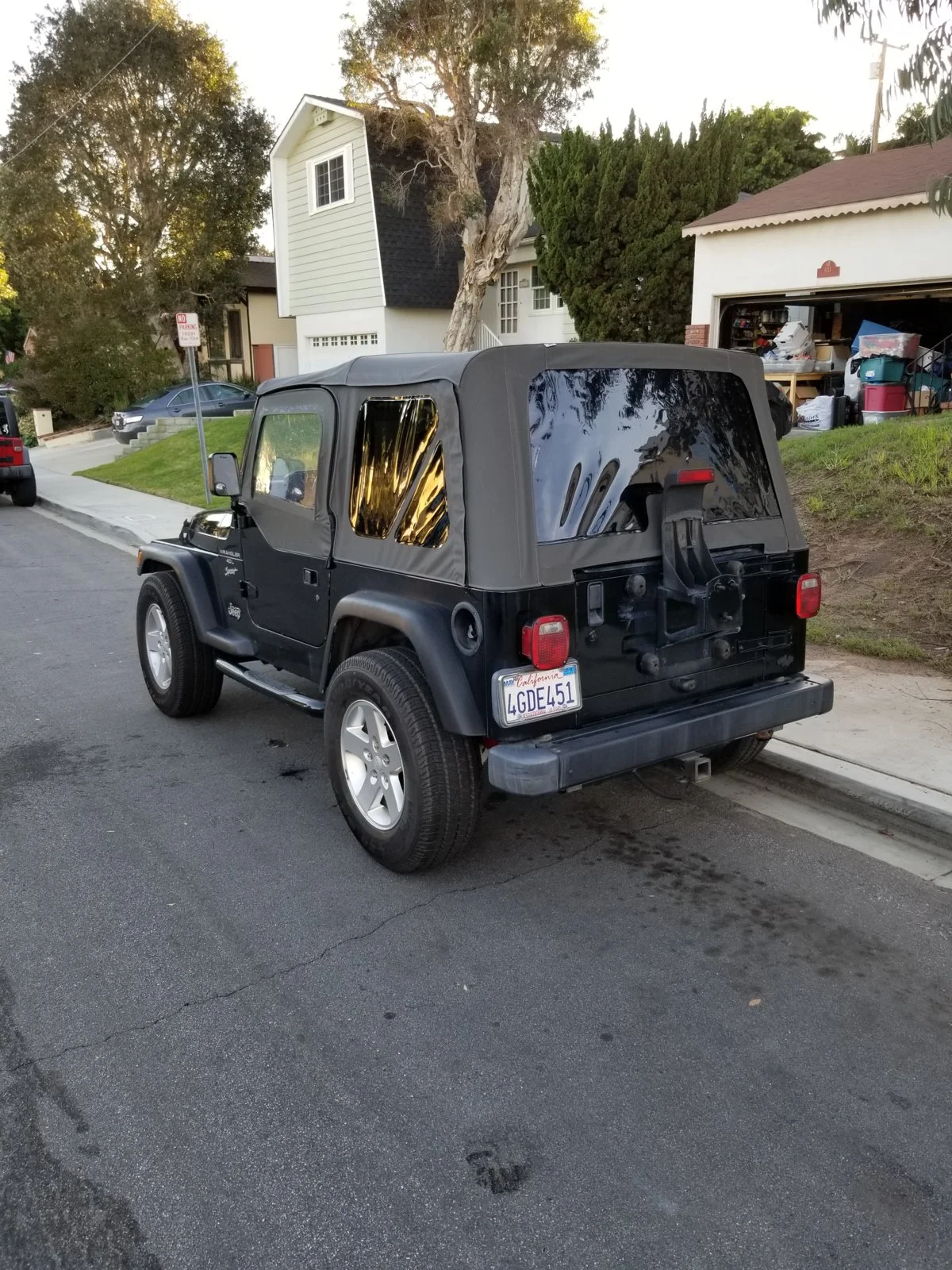

Well it's done! :):):):):) Sorry I couldn't pick up the phone blaine. I was literally in the bathroom placing the last hot skin onto it's frame. I'll ring you up this weekend though. I finished this just in time for family dinner.

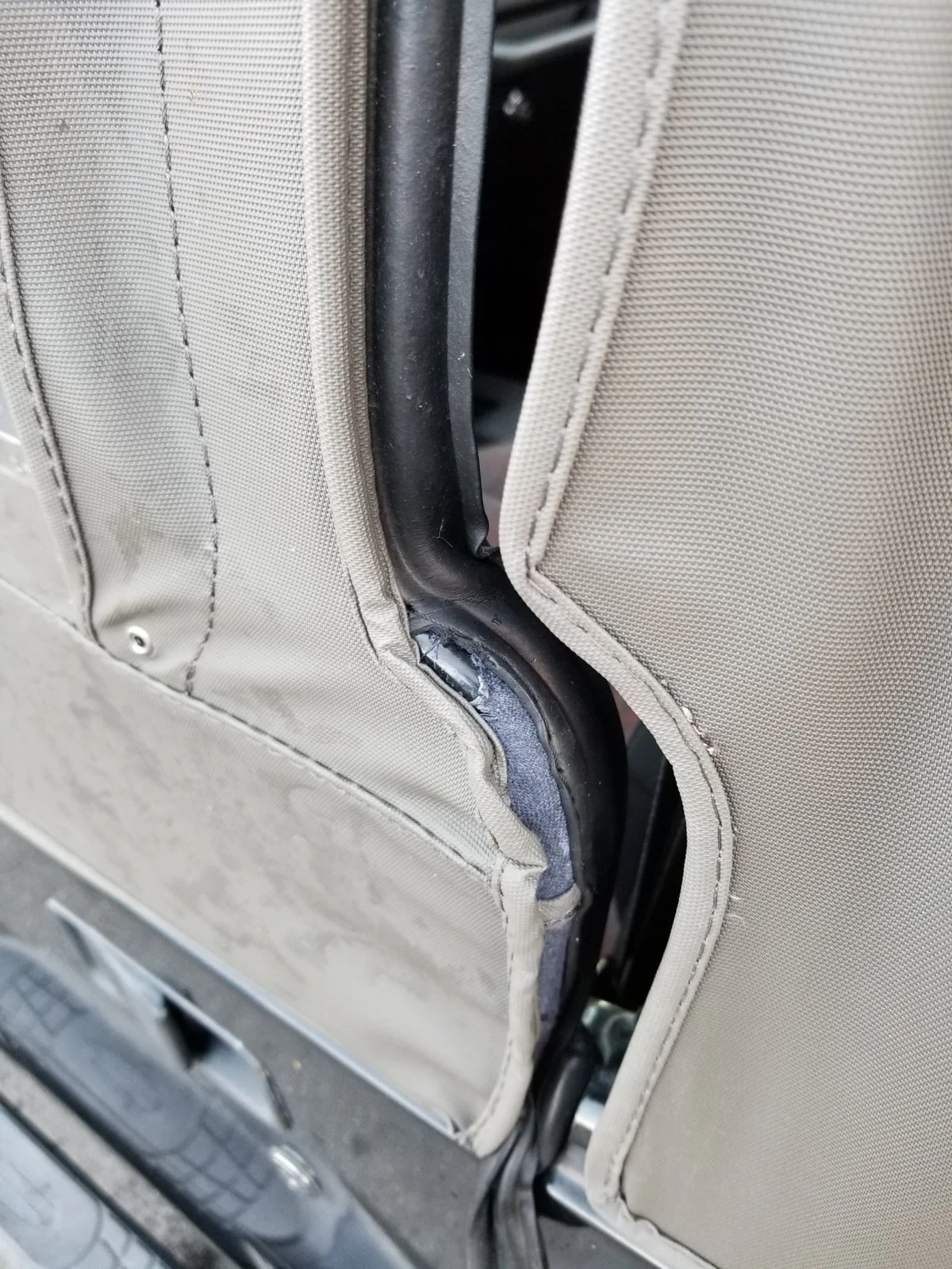

Took two tries on the header. And a bit to figure out the uber simple latches that my feeble mind could not comprehend. Finally after 20 minutes the mind opened. And I figured out how to get it to latch. It's all buttoned up tight. Only glitch was a small tear in the drivers side upper door skin. Anybody got any ideas of how to re-enforce that? Or should I just return the top and only exchange the one window skin out? (I'm thinking the latter.)
Fit's tight. The bow brackets were a breeze to install. Now I can see what it's gonna take to remove my roll bar pads for painting. Got a little mold from the rain on one of my seats. No big deal. Wiped right off. I've got new ones coming anyway.
Finally it's done. SO pleased with how the color turned out. And it will look even better (like my avatar) once I can afford to put some black steel rims and off road tires on it. And a small 2" OME lift. Still have to get my spare mounted. Hopefully tomorrow.
The biggest improvement is I can now take my top down and put it back up EASILY. Which wasn't the case with my other frame. I don't know why they sold the other Supertop frame. My only opinion of it is it sucks. Unless there is some intended purpose I am unaware of?
Thank you one and all for helping get thru this mini saga of putting a soft top on - when none of your hardware is co-operating. Big thumbs up to you all! Especially Mrblaine!
The one tiny split that occurred.

1) Any advice on the rip in my upper door skin? Is there anything to permanently fix that? Or should I just exchange it for a new one? I'm thinking exchange as it looks like that is just going to get worse. I don't mind swapping it out as I have the process down now. Just hoping 4WP's will let me exchange just the window out of a set and then return the new set with just the one bad window. I don't see why they wouldn't.
