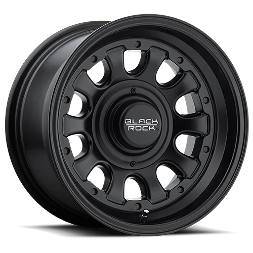

Black Rock makes an aluminum version...
https://www.blackrockwheels.com/wheels/product-detail/series-909b-type-d/

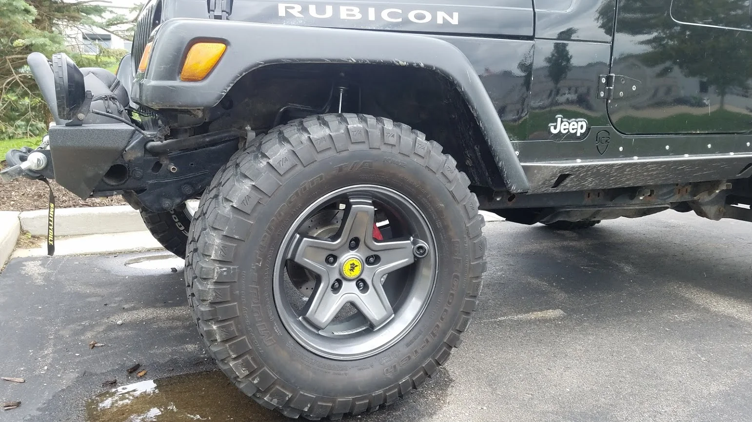

Personally, I'm running AEV pintlers. Its actually a JK wheel. They are 17 x 9 with about a 5.25 backspacing. Since I also have to run an adapter, I have a 1.25" adapter to give me an effective 4" backspaced wheel. I get just a little bit of tire out past the fender and no rubbing. The Pintler has LONG been one of my favorite wheels, but since they don't make them in a TJ pattern anymore, I'm running the JK version.
Do you need to have a lift with this setup? What size tire is that you are running?
those look pretty nice, a little fancy but definitely in the right direction
ouch $170 a wheel, that hurts a little, or maybe i'm just a cheapskate

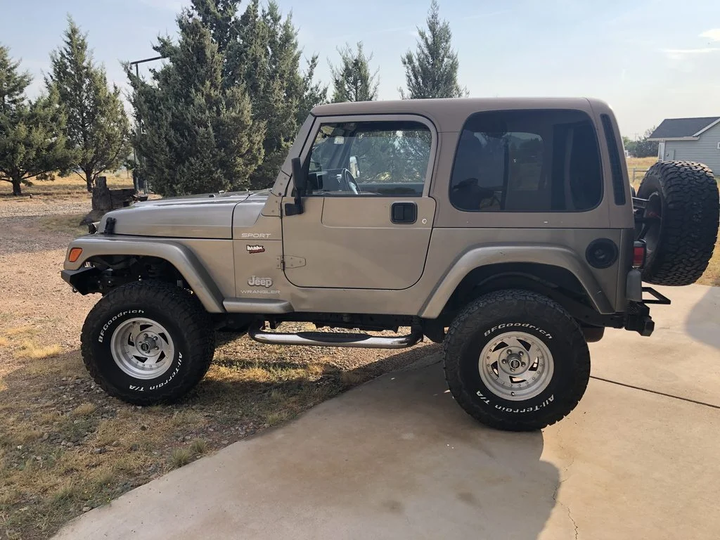

These are American Racing. Does anyone remember the model number? Also the clear coat is not in very good shape, and I am wondering what it would take to remove all of it.
