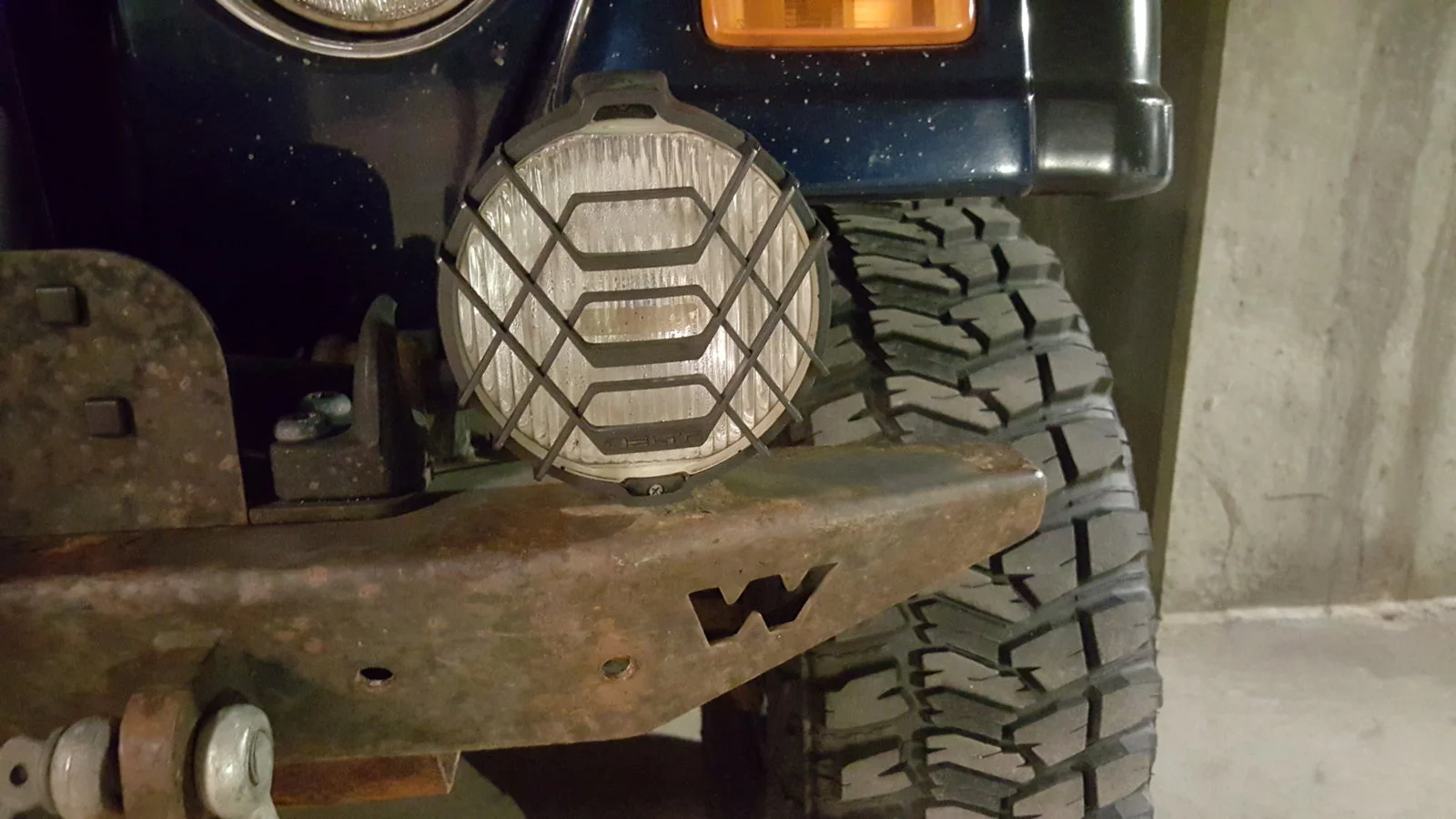

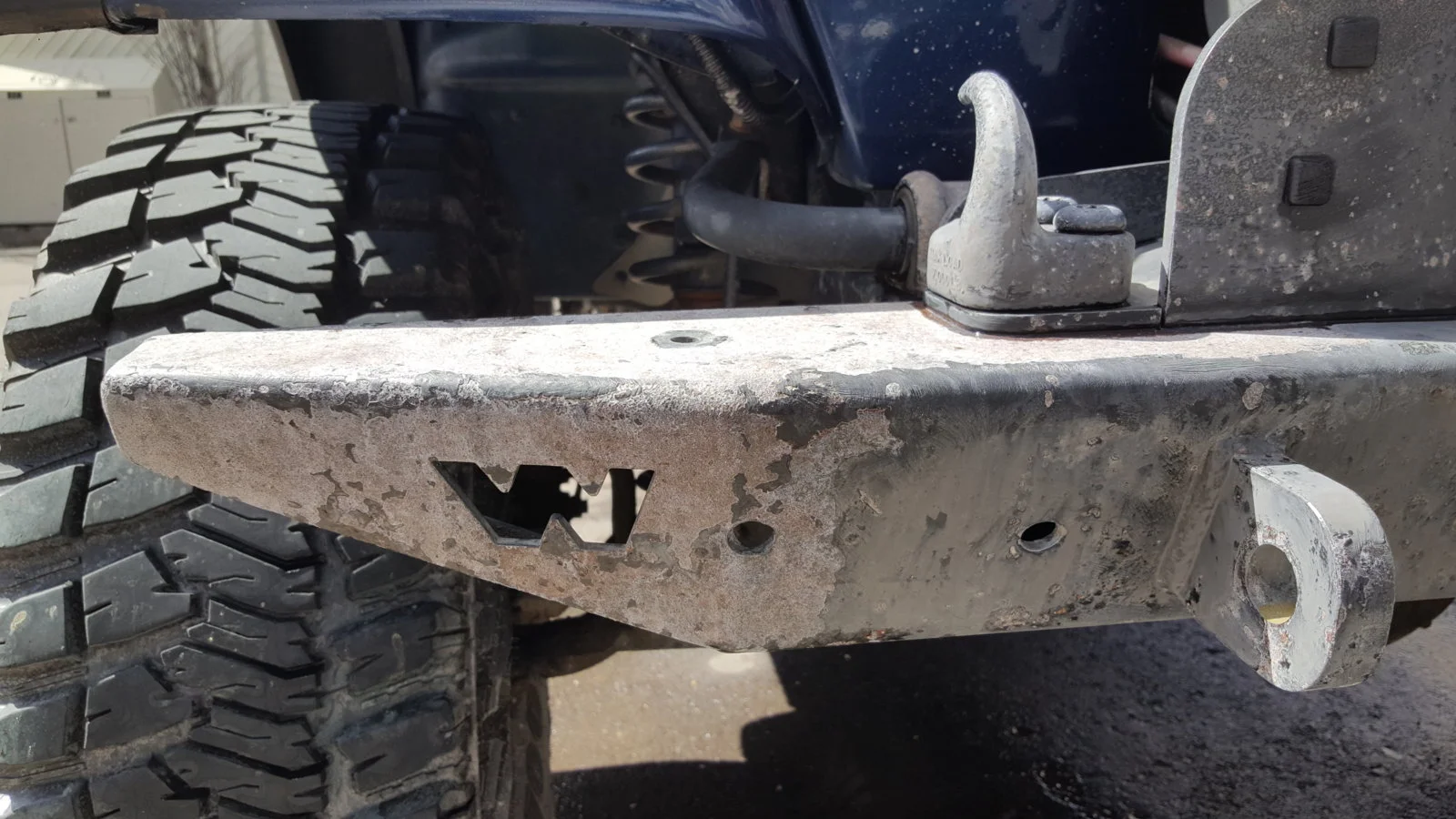

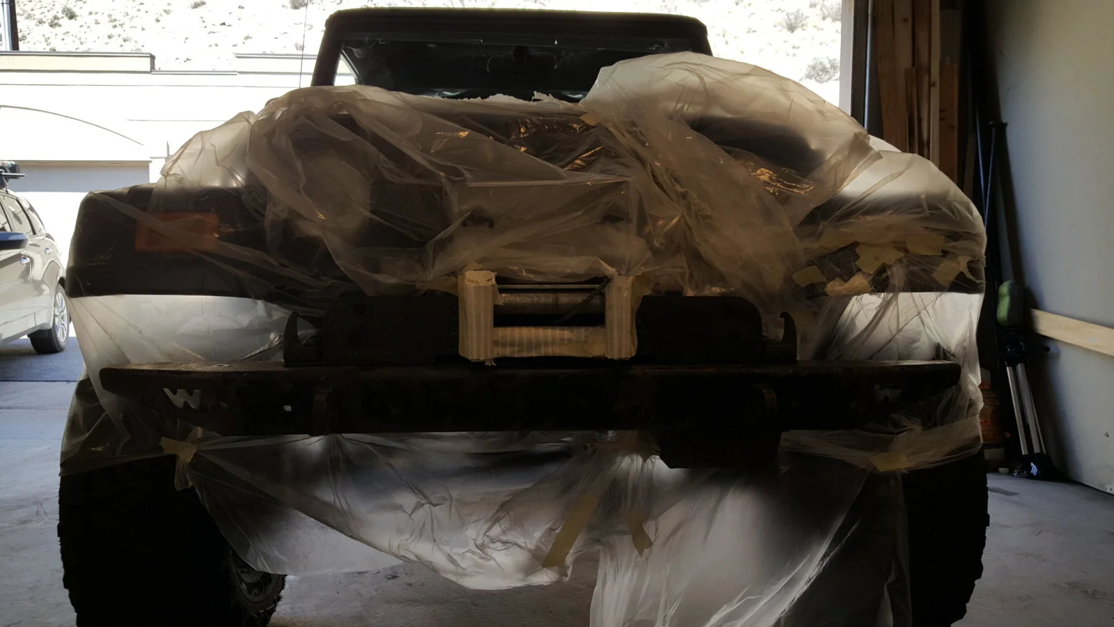

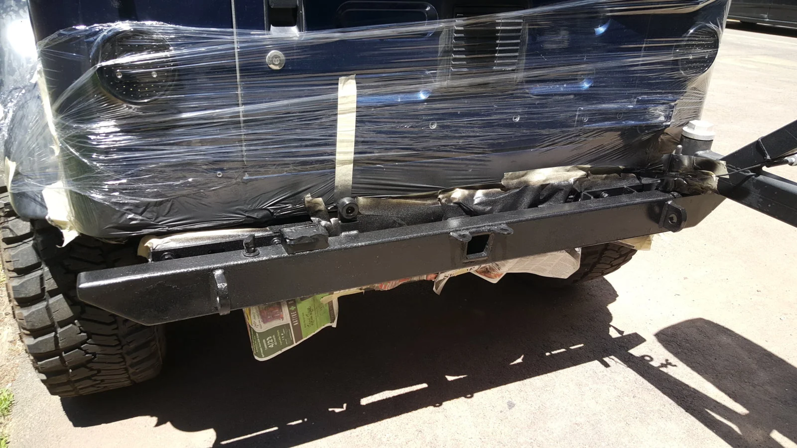

The bumpers had seen some wear and tear use, but the metal was sound. I found this product called Ospho, which is marketed towards the marine industry. You remove loose rust and paint, then spray the water like substance onto the metal and let it sit overnight. Then wash it off, and be amazed at what it has done to the metal. After, you can paint directly onto the dried ospho.

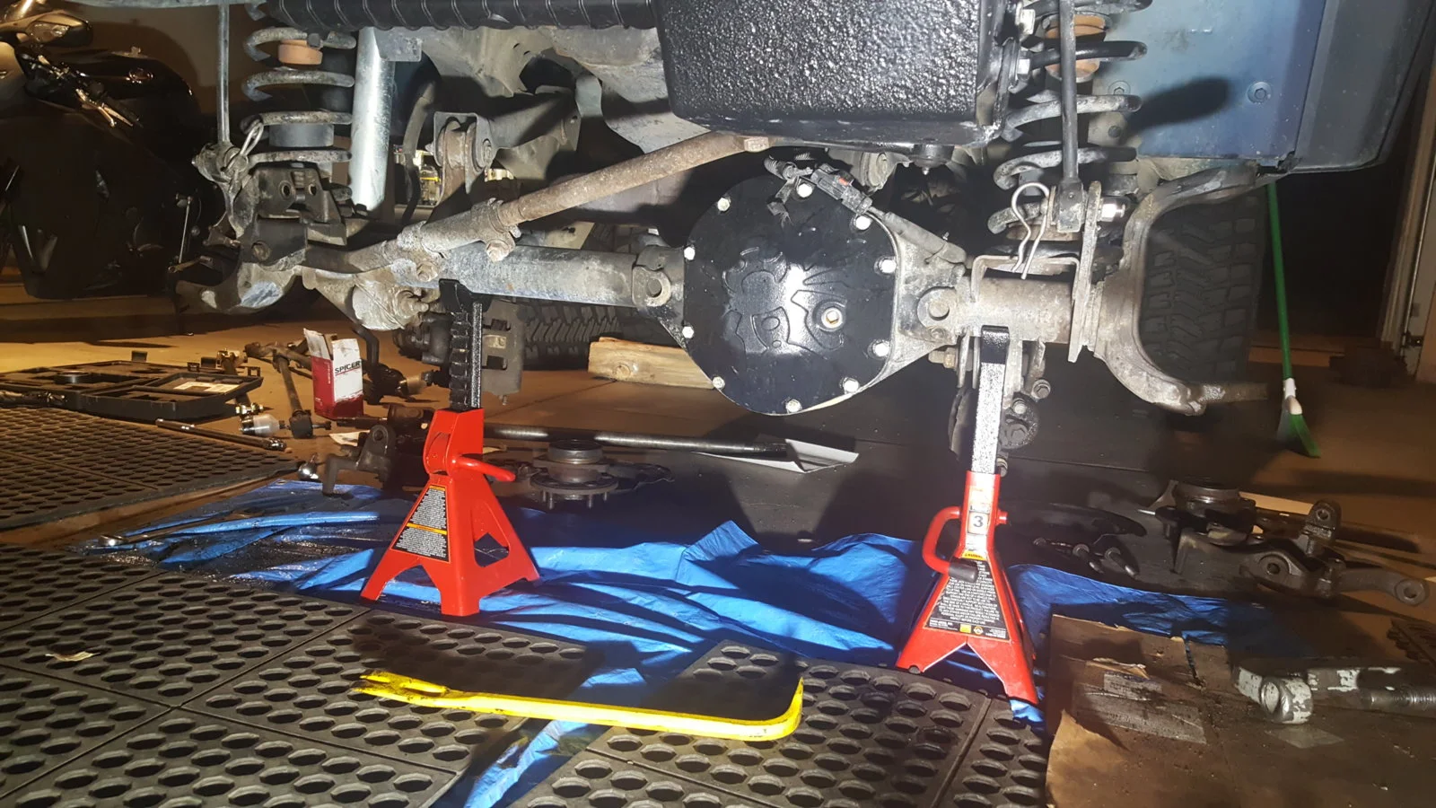

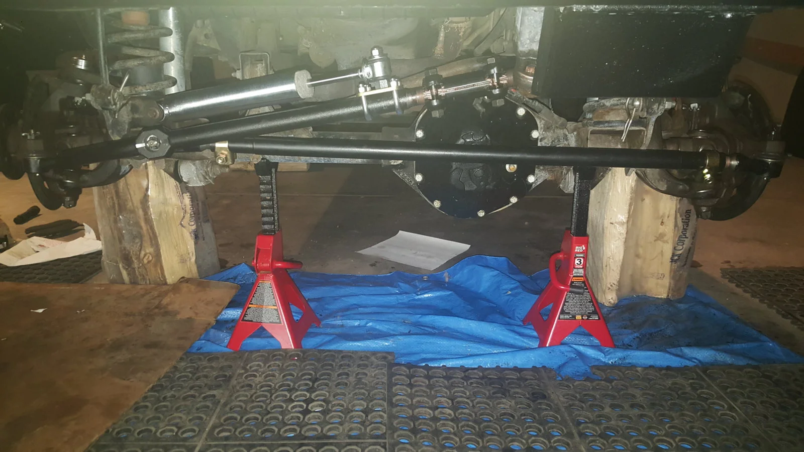

Right around the same time I noticed some uneven wear on a front tire, found a tutorial on how to check the ball joints and found those to be the culprit. After a grueling 3 day stretch stripping out (what appeared to be) the original parts, I finally got it reassembled. Hearing the u-joints and ball joints finally break free sounded like a gunshot in my friends garage. A wave of relief passed over as I celebrated not having backed myself into a corner where the part either comes out, or I have disassembled too far. While I had the wheel hub apart for the ball joints I went ahead and replaced the other things.
Reactions: Matt77 and derekmac

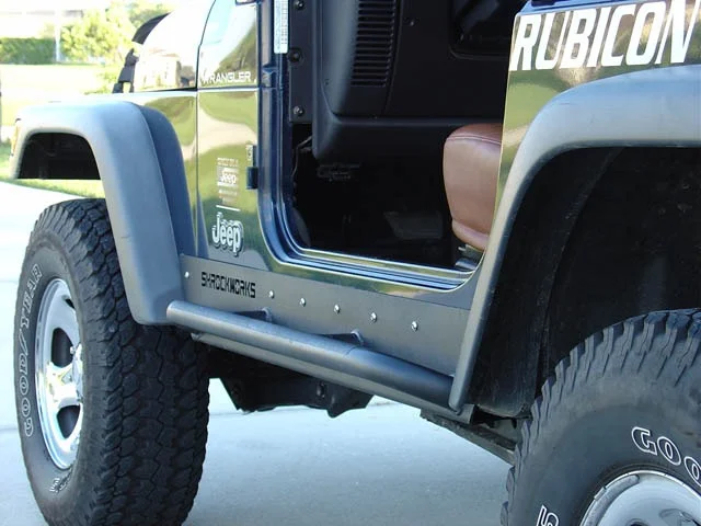

Also ordered Shrock Works rocker guards, these are handmade by a small shop in Texas. Roughly a 6-8 week lead time which will give me enough time to get the body lift on. I chose these over PS rocker knockers as Shrock's do not incorporate any mounting or attachment to the body mounts. Important because the PS would require me to trim part of my body lift on the left and right side to make it level with the front and rear.

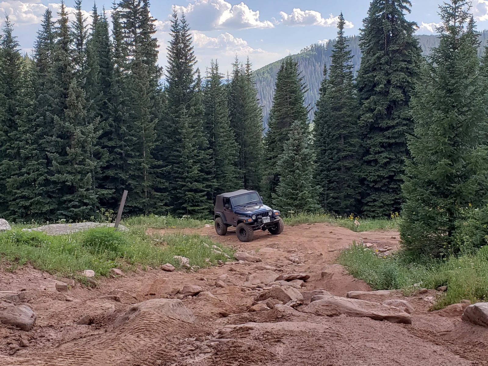

Thanks, this definitely gets used pretty frequently. I am about 4 hours outside of Moab, and there is miles and miles of terrain locally. I picked this Wrangler with the sole intention of building it for trail riding, camping, and assisting with recoveries around the trails.

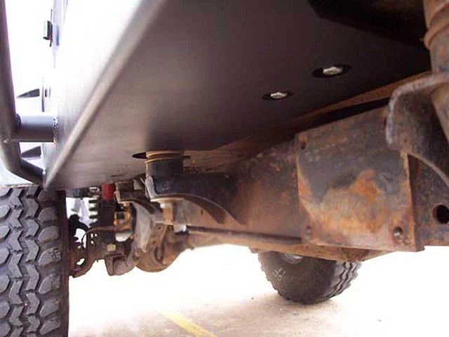

Definitely headed in the right direction! What belly up skid are you going to use?
This week I am considering UCF since it comes in varied heights of tuck (I like options), and a trans/oil skid. Last week, it was Nth Degree. I like their price (and design) a lot, but the idea of leaving my trans unarmored while spending so much to protect the oil and transfer skid, seem problematic.

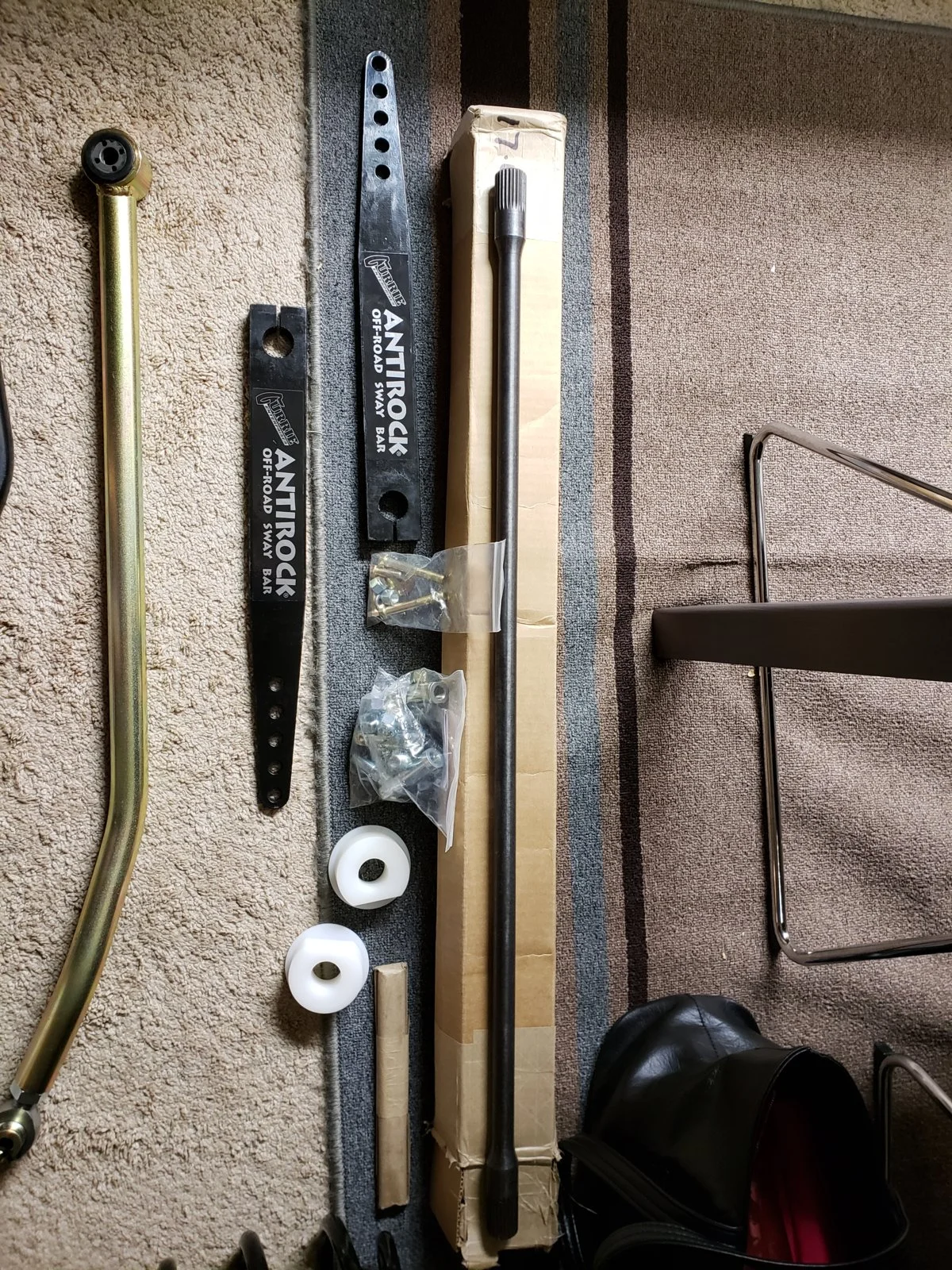

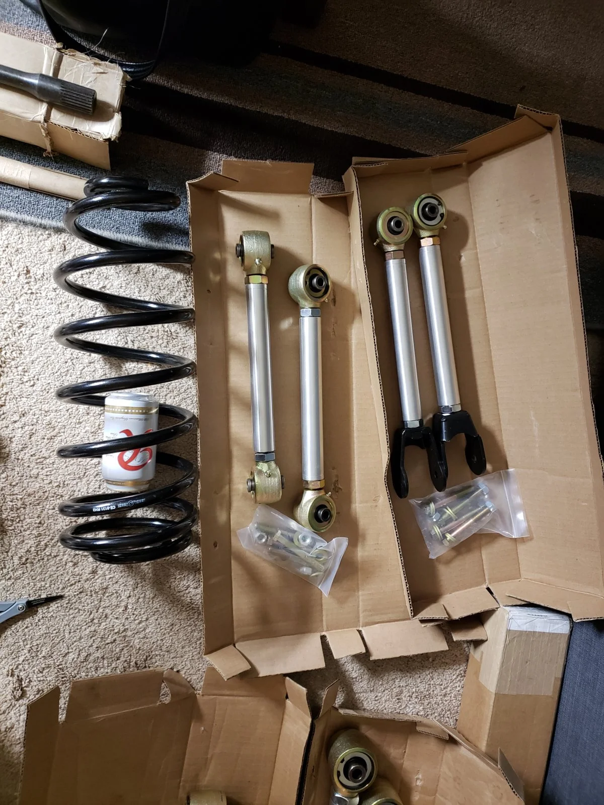

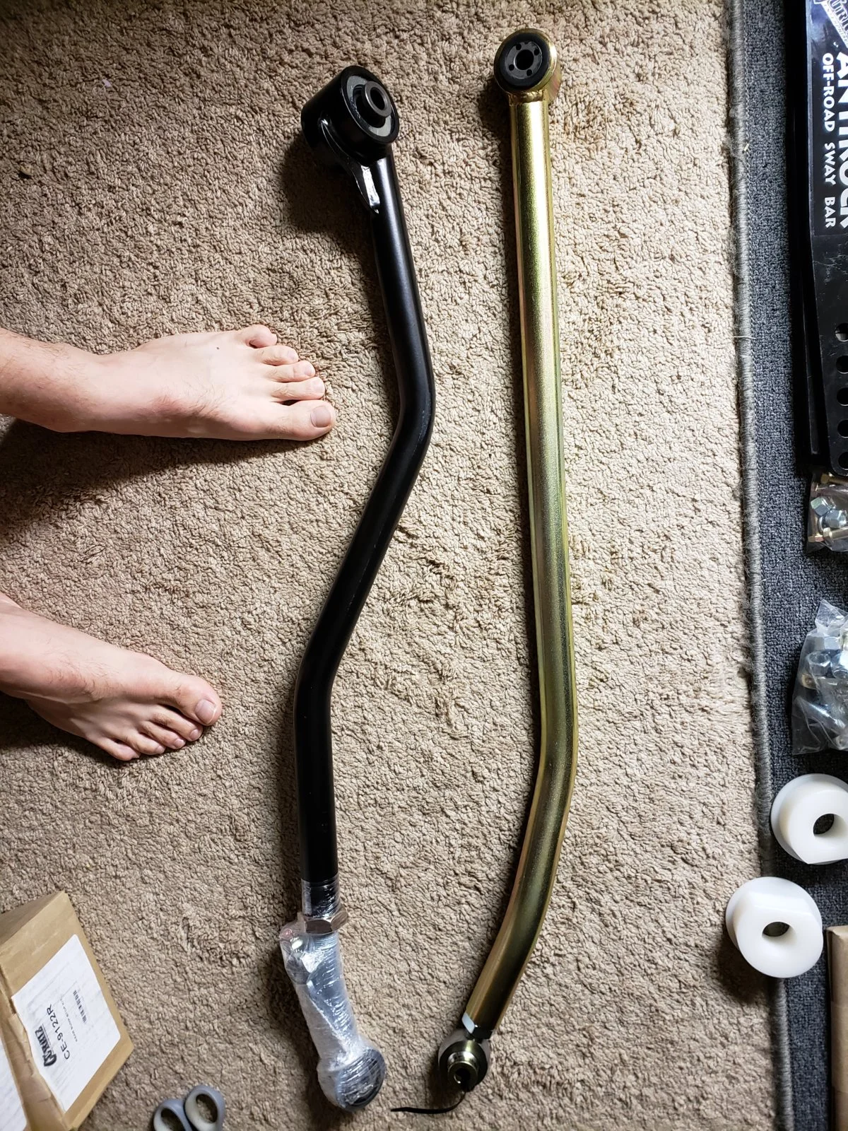

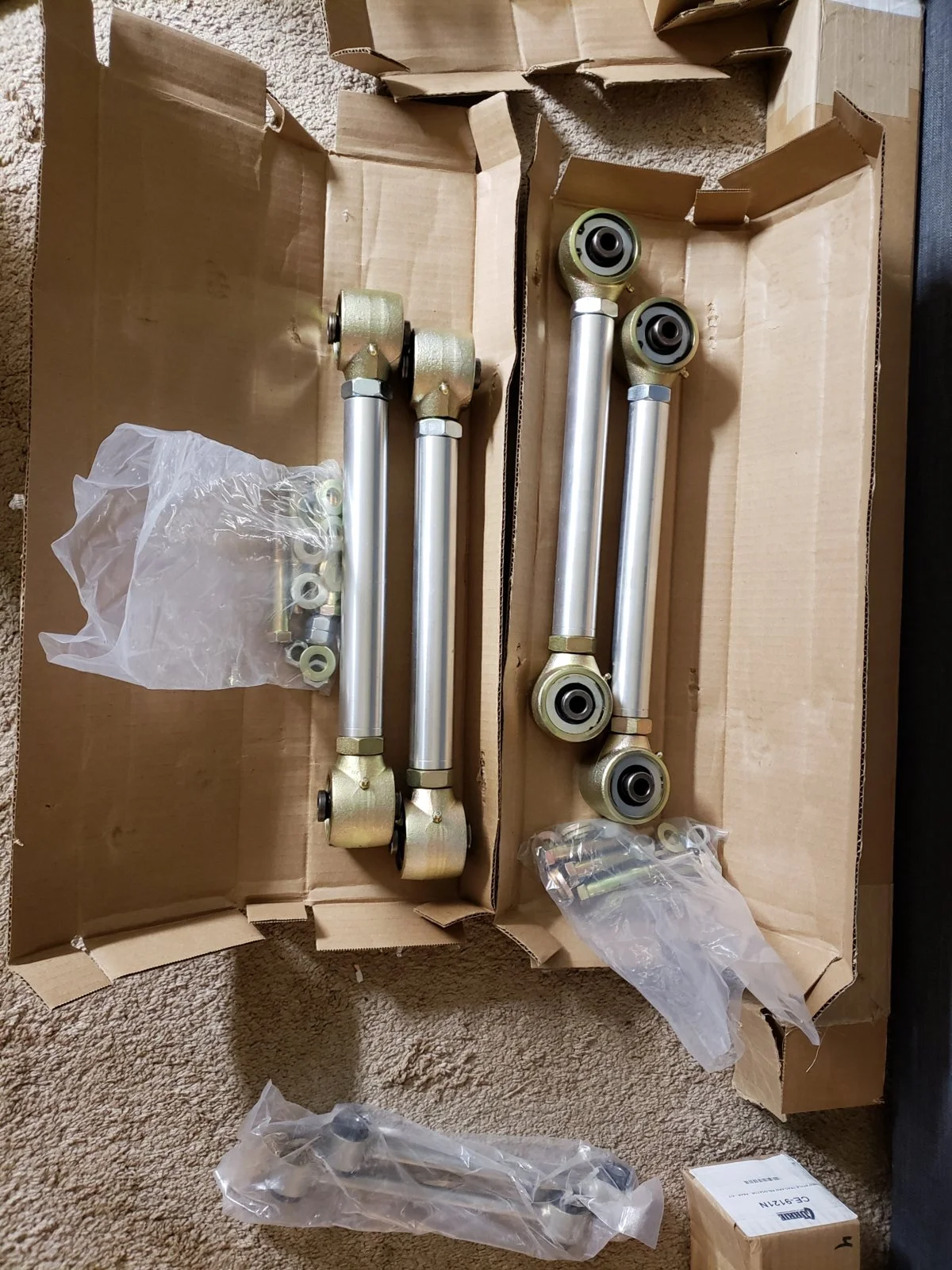

So yesterday my wife sent me the picture of all the boxes and made sure I knew how heavy they were for her to drag inside the house while I was at work. My excitement outweighed her sore back. I very briefly got to open my new toys before I had to move my attention to her. This morning I got to open them all the way.
First impression: Holy shit, these are high quality. Like seriously nice. Granted, my recent experience has been my old Teraflex kit, but these blow that out of the water.
My advice, if you are currently about to drop a good amount of money on a full suspension kit, of any brand be it teraflex, RE, whatever it may be, seriously consider saving just a little more and putting on Currie items. From the quality of the Currectlync, to their JJ's, the antirock, their trackbar, everything is of the highest quality. Thats it, I am a Currie fan for life now. There is no doubt that this kit will perform as well as everyone has said it will. (and its shiny)

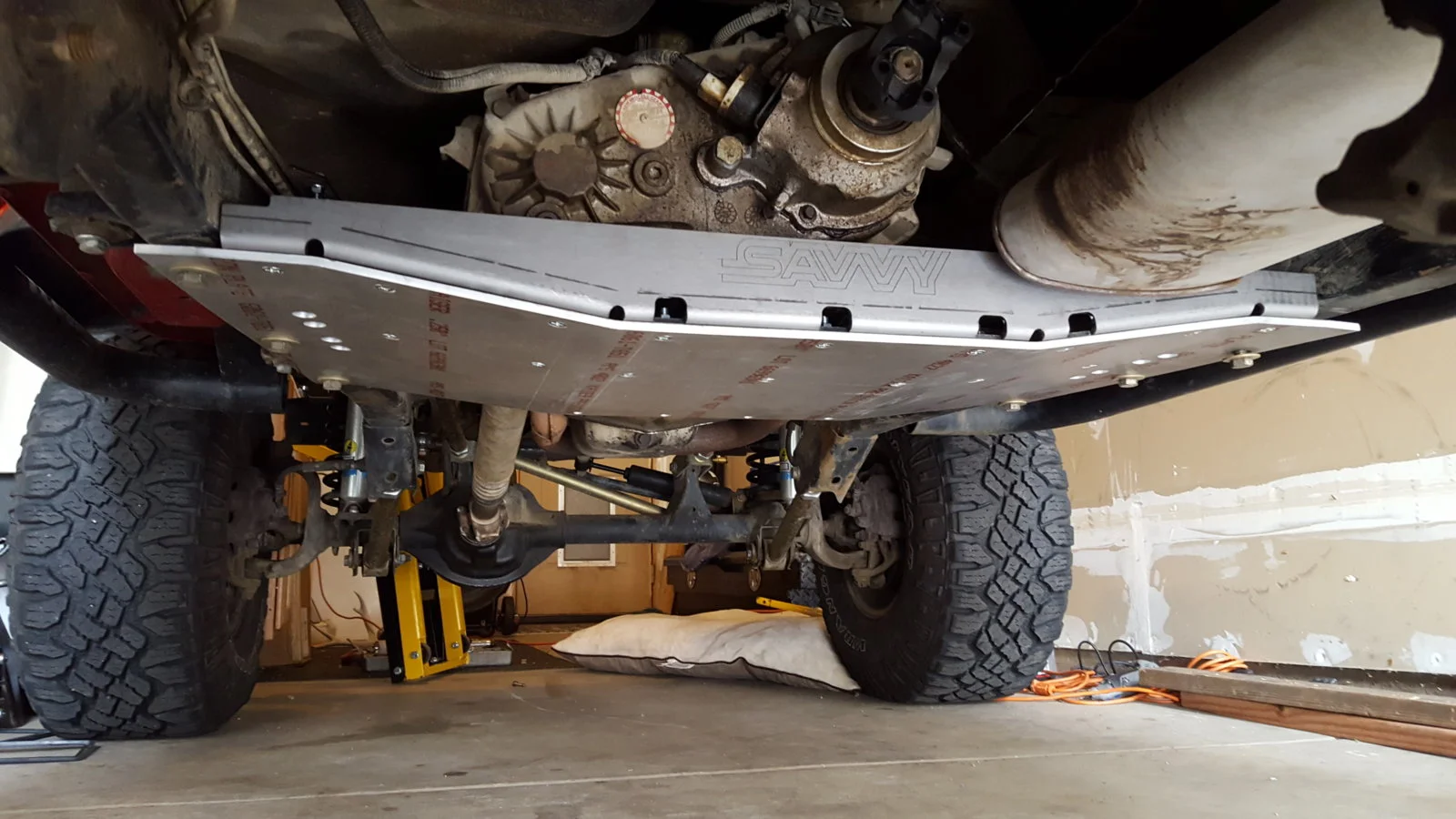

Have you looked into Savvy for your tummy tuck? Their system includes a tcase skid, engine skid, gas tank skid, 1.25" body lift, and a 1" motor mount lift. There are a few of us in CO that run it. Definitely worth the money.
Reactions: MaloStapalo
I have considered it, I have their 1.25" body lift in with this order and a mml arriving today. I saw that it was backordered currently but that may change by spring time. Do you have pictures of it installed on your rig?
