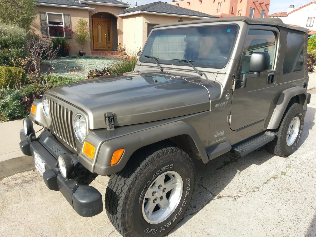

That was it. I had permission, and I figured I'd better move quickly. So I picked up this 2005 Sport:
The Jeep had one owner who had racked up 130K miles using it as a DD in SoCal. No scuffs or rust on the underbody, and the axle seals were good. Nothing worse than the usual minor leaks from the engine.

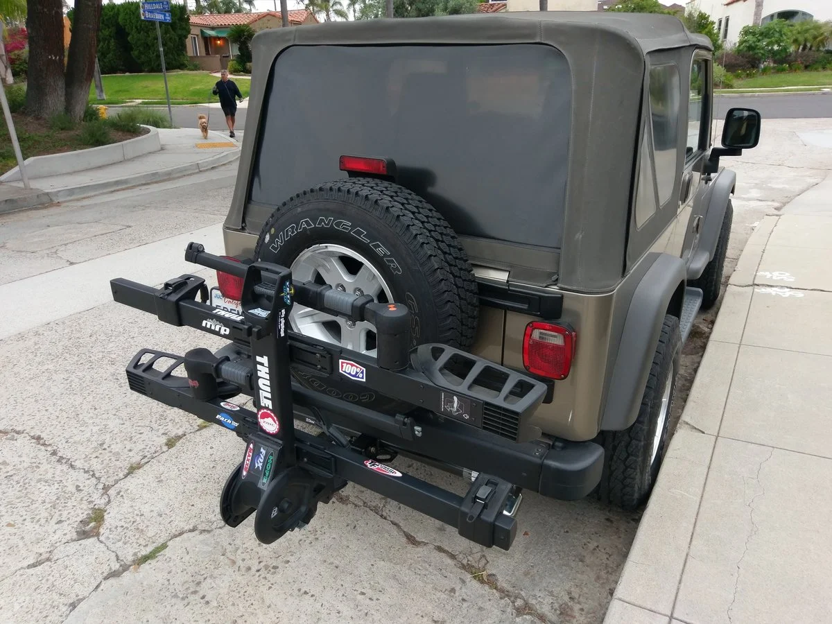

The first upgrade was a Draw-Tite hitch, which was necessary so I could use the bike rack. This was a mistake because it caused clearance issues with the tailpipe
and eventually was responsible for ground clearance issues.
No issues with the bike rack itself. It was just the hitch mounted beneath the stock bumper that was a problem.

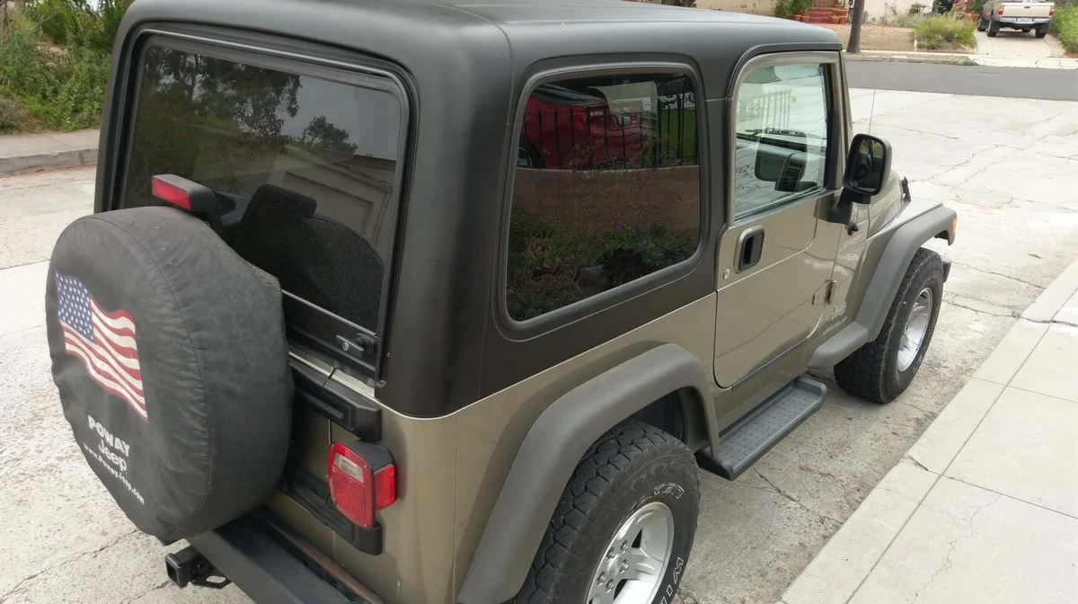

I really wanted hard top instead of soft top, and the old soft top was really crispy from being in the sun and the windows were badly scratched and fogged. So I got a new top from Camper King since their prices are low and they're just down the road.

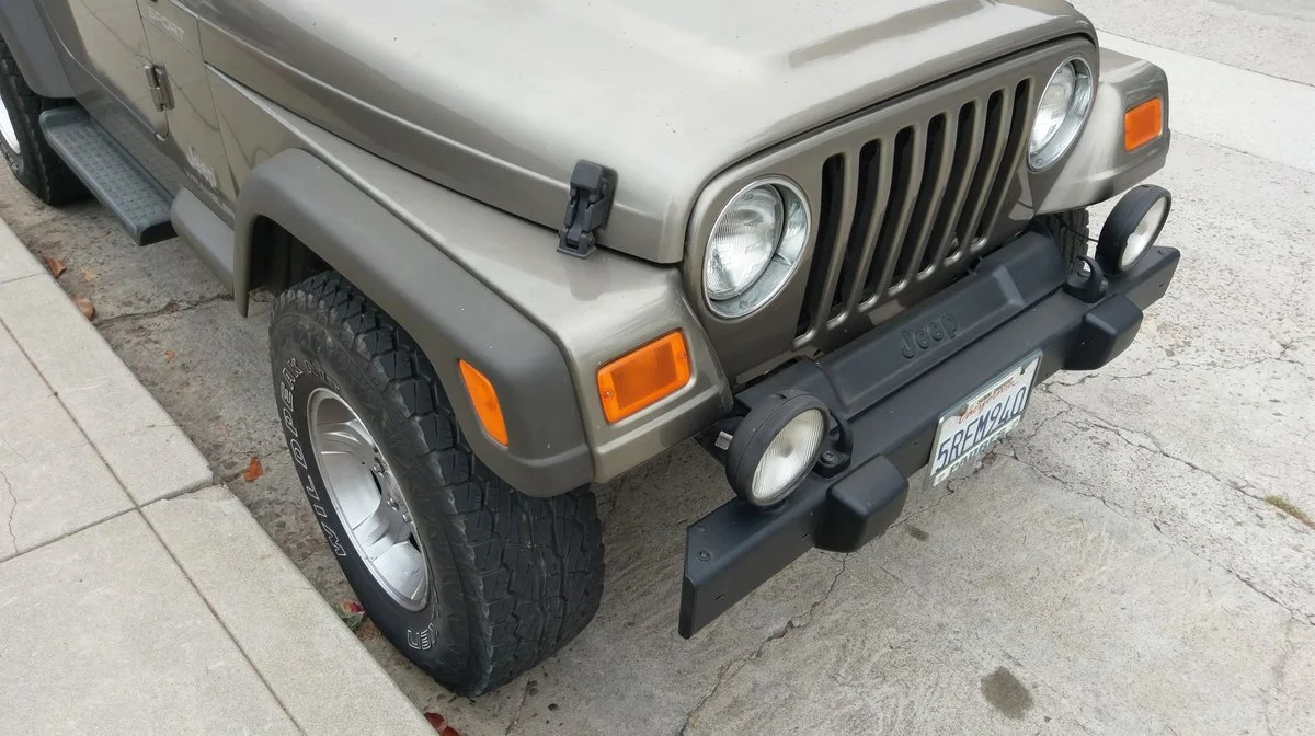

I swapped out the milk jugs for stubby bumper caps.
... and that front bumper is done! The stock bumper looks so darn good with the stubby ends. And it's still totally functional and lightweight. I figure I'll keep it like that until there's a really good reason to replace it.

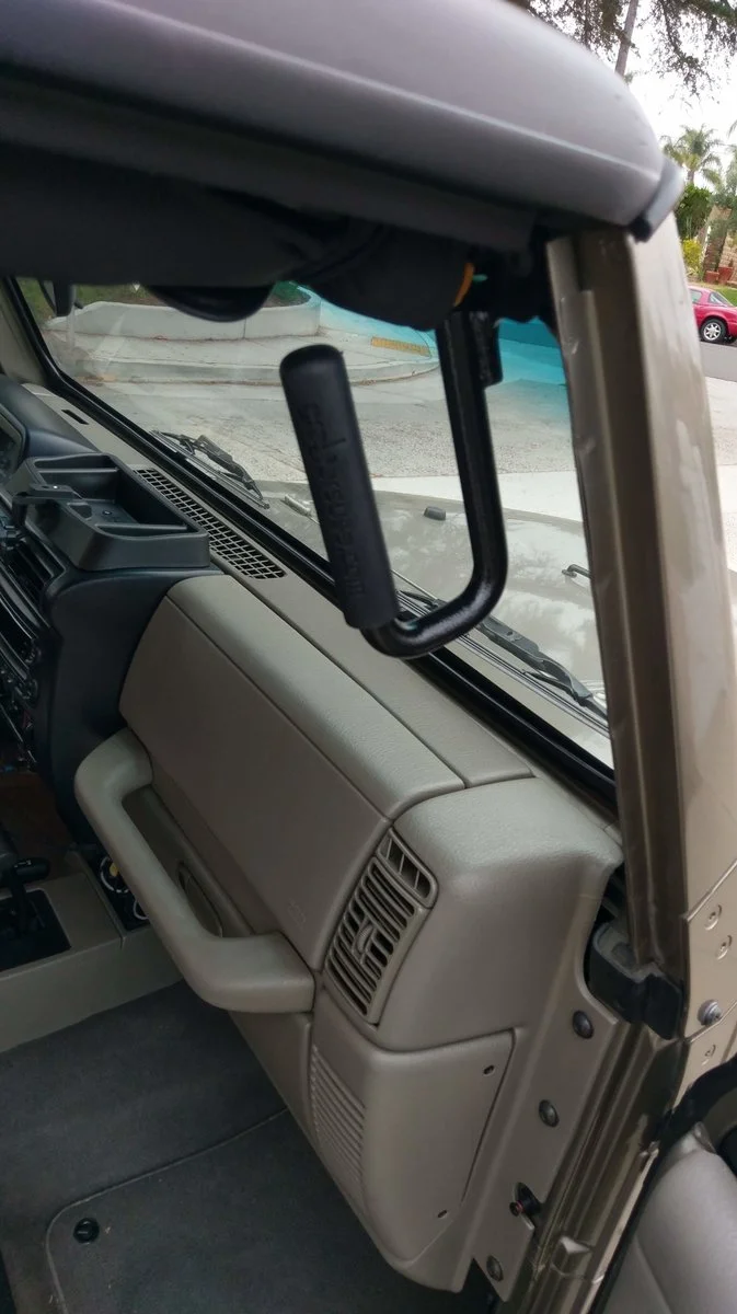

Added handles for the wife:

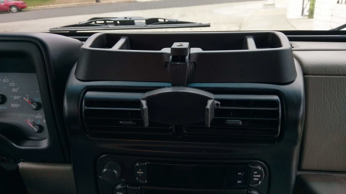

And the Rugged Ridge dash tray and phone mount:
That was a cheap and easy upgrade, but it's one of the best things I did. It allows me to use my phone as an OBD2 monitor, navigation system, and audio source for the stereo. I also use the mount on top for a little GoPro Session cube camera to get video of trail runs.

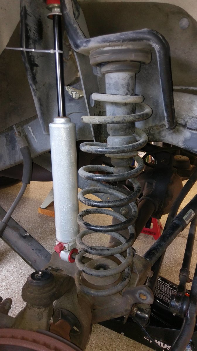

Like many new owners of old Jeeps, I felt like the ride was way too harsh, and that led me to look at the suspension since my tire pressure was already reasonably low. While checking things out, I started to wonder if my front springs were sagging. (See https://wranglertjforum.com/threads/sagging-stock-front-springs.11772/) The springs definitely were sagging after 130K miles, and replacing them with Moog 3226/3227 springs restored the stock ride height. (See https://wranglertjforum.com/threads/stock-spring-swap-walk-thru-with-pics.12655/)
While replacing the springs, I did a bump stop check (See https://wranglertjforum.com/threads/bump-stop-check-walk-thru-with-pics.12883/) and learned that the RS9000x front shocks are just a little too long when fully compressed, and that I needed a little bump stop extension to protect them from full compression. At the same time, I learned that my 31x10.50R15 tires rub slightly at full bump, and that they rub hard on the spring perch at full flex with any amount of steering. That goes counter to the prevailing wisdom that 31s fit fine with stock wheels and suspension.
I replaced the old coil spring isolators when I replaced the springs, and that made a noticeable improvement in ride quality. That and the thread about control arm bushings (https://wranglertjforum.com/threads...composition-affect-ride-quality-or-nvh.13928/) got me thinking about the other worn out rubber on the Jeep.

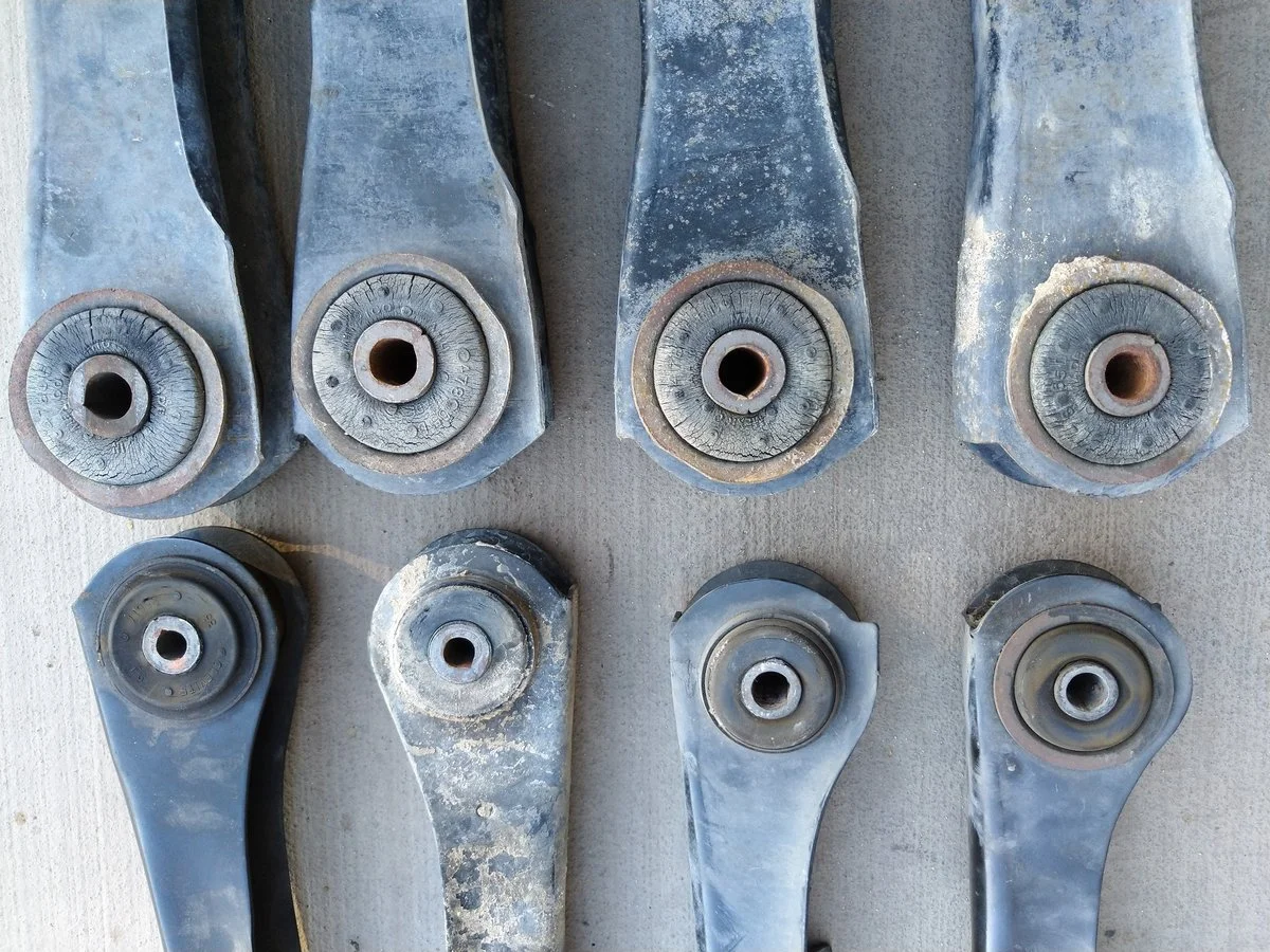

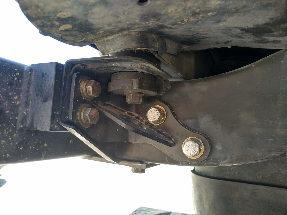

Just look at those cracked LCA bushings! So I swapped the OEM control arms for a set of Moog control arms, but just one location at a time. That let me see how much the control arm bushings affected ride quality. In my experience, front lower control arms make the most impact on ride quality, followed by rear lower control arms, and lastly the upper control arms. But swapping the old front LCAs for the new ones was like night and day.
After having success with the control arms, I figured I'd replace the old, cracked body mounts with a new set of Crown body mounts. That improved ride quality a little too.

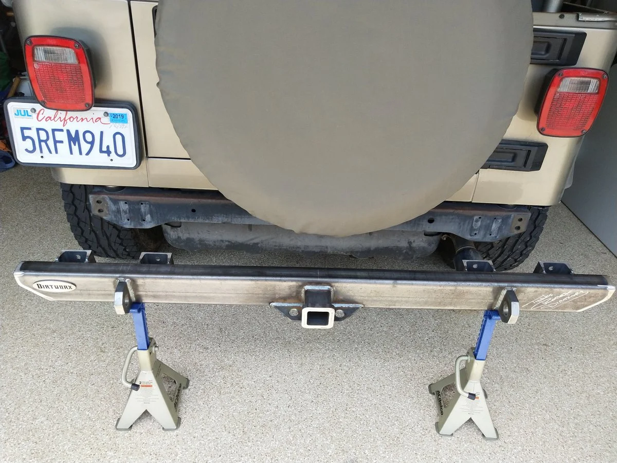

You can see it right there — the bolt-on flare for the tailpipe hanging right below that bolt-on hitch. Just waiting for the right rock to come along. That whole setup had been annoying me since day one. And I figured that since the hitch was in the way and I managed to destroy the tailpipe (it got a minor dent), I needed an upgrade.
So that whole mess came off and I mounted a Dirtworx rear bumper and a low-profile tailpipe flare that tucks in nicely. While I was at it, I added the Poison Spyder frame tie-ins. They might not be necessary, but I figured I'd rather distribute the load on the bike rack as widely as possible. Also, they're really sweet looking little bits of steel and nicely made!
With the rock solid Dirtworks bumper and the frame tie-ins, the bike rack is now way more stable than it ever was on the bolt-on hitch. It also sits a lot higher — good for ground clearance, bad for tailgate clearance.

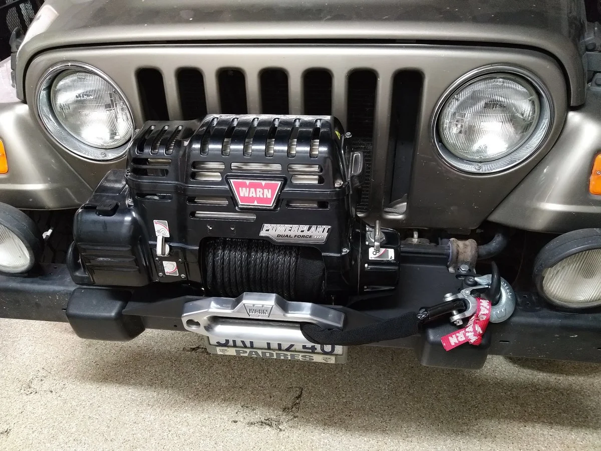

I had been kicking around the idea of adding a winch for a long time, but really got serious about getting one when I found that there were some reasonable deals on used Warn PowerPlants with on-board air. I had been airing up my tires with a high-volume bike pump, which worked reasonably well but was a lot of effort. Then I got this.
I also scored the 100' 3/8" Spydura line and fairlead off of CL new-in-box for a song! Fog lights got relocated outward by a couple inches to make room for that beast.
It's turning out to be a pretty good setup overall. Good enough to lead a couple of new Jeepers around the local trails.

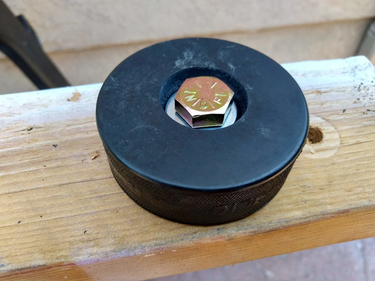

I made up some 1" bump stop extensions out of hockey pucks.
The bolt is the same 1/2"-13 spec as the JKS bump stop extensions, so I could swap those in at some point if I ever wanted to. The Grade 8 bolt may be overkill, but it's all the orange hardware store had in stock.

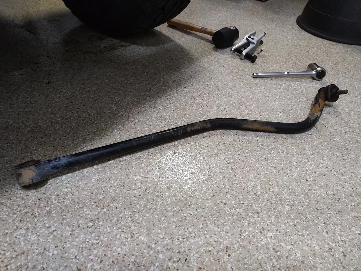

The parts have come in for the lift, and I just managed to get started yesterday.
The front track bar is out, but I had to pause because I don't have a drill big enough to drill out the track bar frame mount for the JKS install.
Track bar took me way longer than it should have. No matter how much I messed around with ratchet straps, I couldn't quite get the axle bolt free. So that took a while. And then the cotter pin on the ball joint was in at an awkward angle and I had to mess with that for a bit. Then I couldn't get the ball joint tool in place — just couldn't get it to go in where it was supposed to fit. I did finally get it though.
All it took was some persistence, patience, and a lot of swearing.
