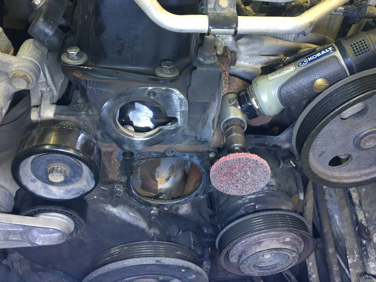

Jerry is right. All of these thick gasket, rtv, Teflon tape, yada yada yada fixes are just Band-Aids trying to cover up gasket mating surfaces that are either warped, not cleaned, or overly pitted (assuming you are not over/under torquing it). I have had even brand new housings be warped and leak.
I got a tile of marble from Home Depot (for the flat surface) and put a sheet of sand paper on it. Took the housing and sanded the mating surface to ensure flatness. I use no RTV, Teflon tape, or anything else. No leaks.
