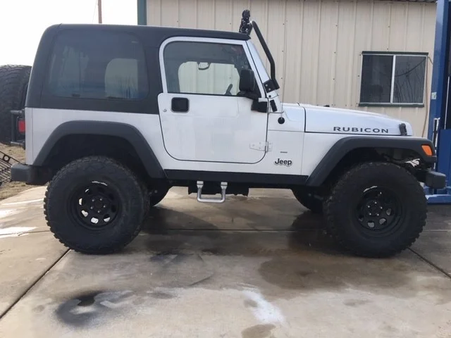

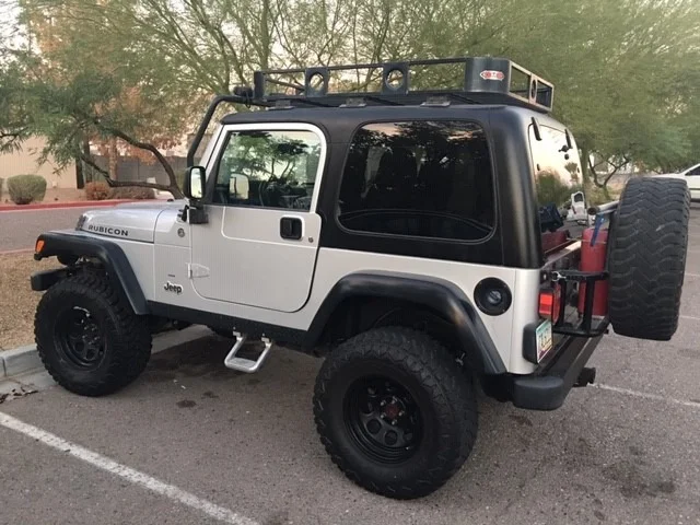

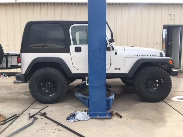

Done! Finished it yesterday. Drove about 75 miles today and am ecstatic!! It drives and steers awesome. Absolutely amazing how much better it drives! Here is some more info if interested.
https://wranglertjforum.com/threads...-3-did-my-toe-change.17109/page-2#post-279167
From this:
to this:
And a half and half:
Reactions: billiebob
Jeep looks great . 3inches you love beats 4+you hate. Nice job.
