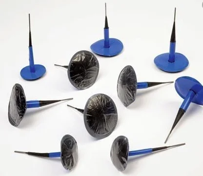

A plug isn't a good permanent repair. Though some do last a long time. Best option in to have a plug / patch combo installed asap to completely seal the injury. Plugs are good for getting home though.

Also, that kit is overkill, and overpriced since you cant use the patches without a buffer, they wont stick to unbuffed rubber due to the slick mold release and uneven surface of the inner liner. You can get a decent plug kit for about $20-$30. Or a nice ARB kit for about $40. Search Amazon for lots of options.

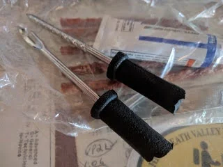

I understand many people hate this but I carry the $5 harbor freight kit. It's weakness are the tools. To solve this issue when you get the kit simply take the new tools and stick them in a vice and snap the handle off. It isn't difficult. When you go to use them grab locking pliers from your toolbox and you are good to go. It's a good alternative if you don't want to spend the money on the others. I also like that it is much more compact. For me it's something I rarely use and if I have something that I can make work to get me off the trail that's good enough. You can buy the higher quality plugs if they dry out, mine have held up for maybe 10 years in a ziploc so far.
