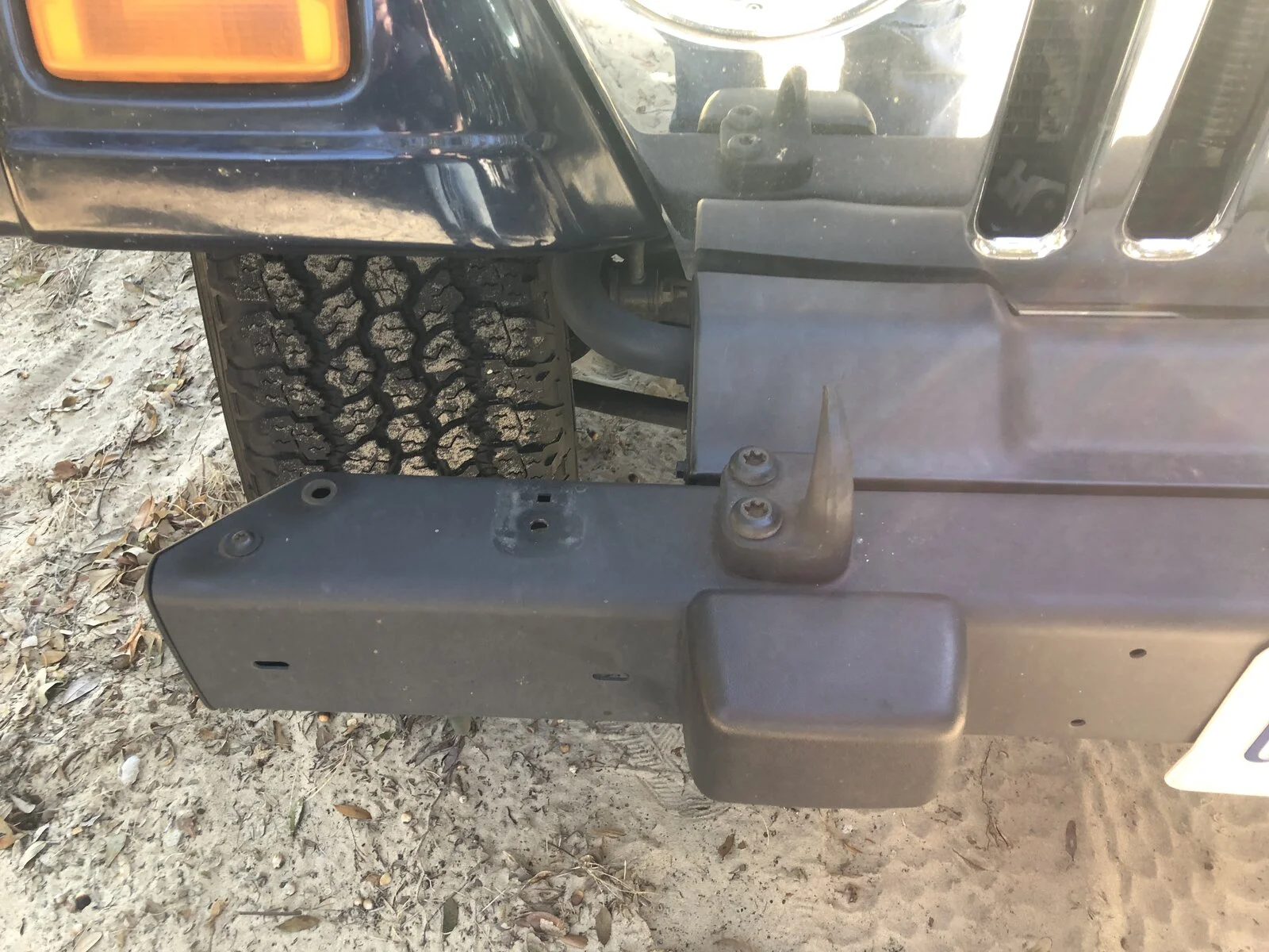

Hello, I seemed to have stripped the threads while removing the FRONT BUMPER HOOKS from a 2006 LJ to install a winch plate. Need to purchase a TAP. What is the thread size? (I know it's 1/2") but not sure what the pitch is.... Thanks!

Where do the tow hooks mount? I’ve wanted some but I have an aftermarket bumper so I’m not sure if they’d fit.

The same two pairs of 1/2x13 bolts on top of the bumper that secure it to the frame will be used to hold the new tow hook(s). You need replacement bolts that are 1" longer than what is in there now to hold the hooks and they need to have a Grade 8 rating. The factory bolts were Grade 5.
