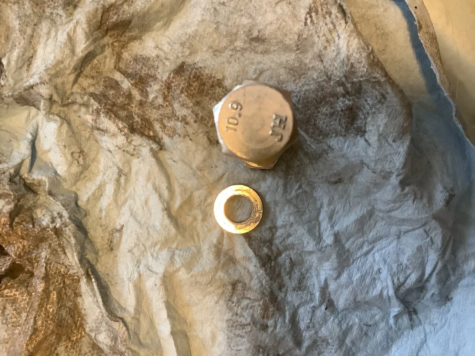

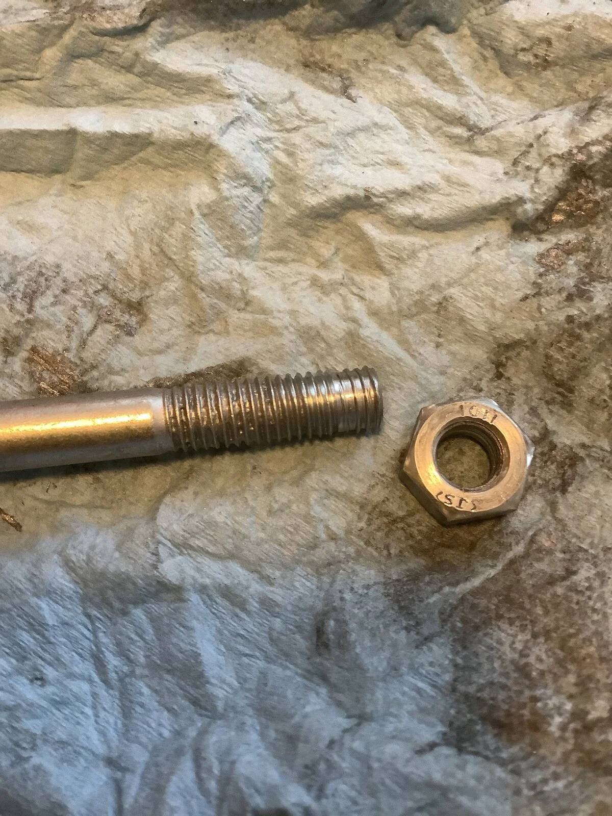

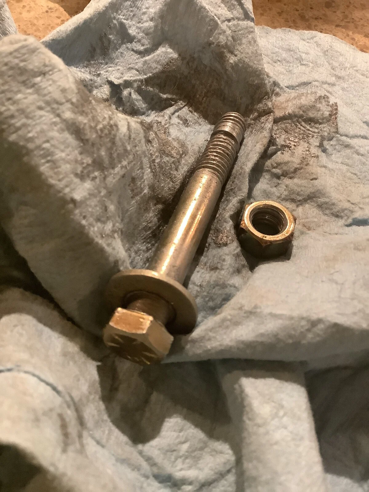

I've had two 10mm nuts/bolts strip out at 40ft-lbs on me.
I've had one 8mm bolt snap off at 20 ft-lbs.
Getting frustrated. Not sure what to do. Menards and TSC have 10.9 bolts but they are black oxide so no good for corrosion/outdoors. Does anyone have good experiences with online? Bolt Depot?

So with the chart I linked showing 39.9 with a lubed 10mm, and OP using a zinc plated bolt with antiseize would it be unreasonable to think that it could strip at 40 ft lbs, not knowing the condition of his torque wrench, without anything being wrong with the bolt?
So I rigged up a fish scale to my torque wrench. Calculated it out to be clicking at about 45 ft lb when set at 39ft lbs.
Seems like that could be significant especially if combined with using k17 instead of k15
Not likely since the highest torque value is typically 75% of proof which is when the fastener should fail.
No, that was a crap fastener, nothing more.
