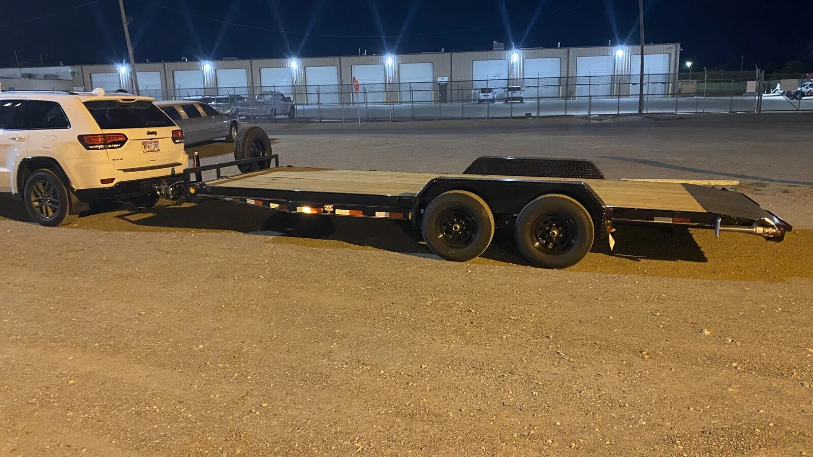

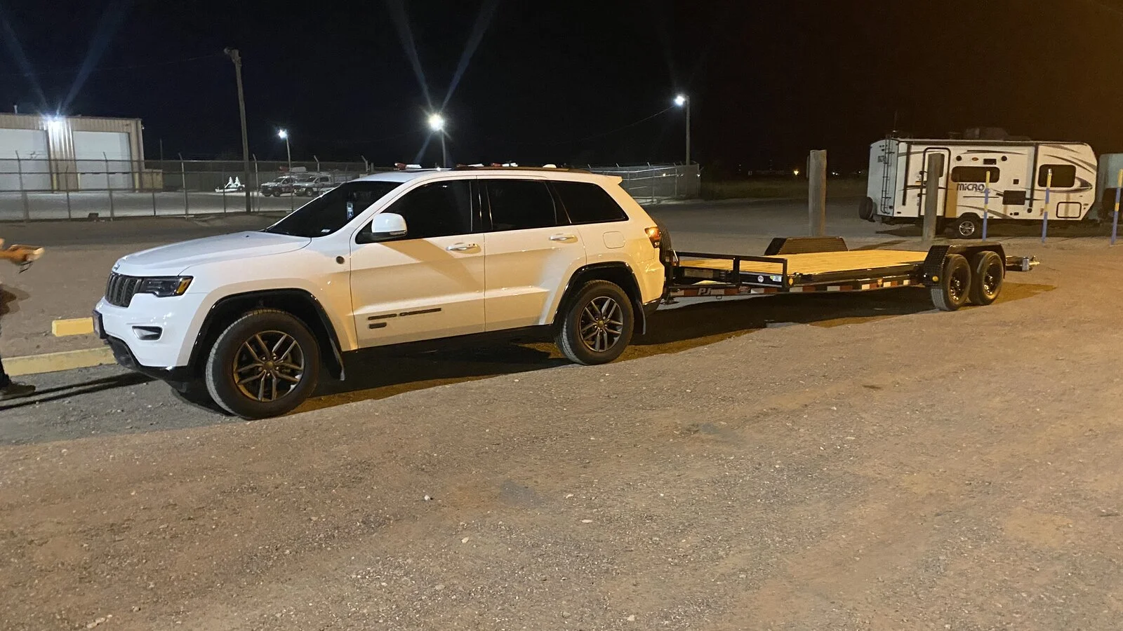

This one was $3800 with the upgrades I added. It’s a 20’ so 18’deck and 2’ dovetail rated for 10400#. I got brakes on both axles, a total of 8 d rings welded on and another 4 movable d-ring mounts that go into stake pockets, rub rails, rear stabilizer jacks for loading, rear pull out ramps, removable fenders, and a spare tire and mount and a winch mount. Then I added a front storage box when I got it home. I drove to TX to pick it up and saved myself about 1500 over what they wanted for the same trailer here in CO. Plus I was going to have to wait 8 weeks for them to get one. That’s why it’s hooked to the Jeep in the picture. Much better mileage than my truck. I averaged 21mpg pulling that empty trailer with the Grand Cherokee from Amarillo to Colorado Springs.

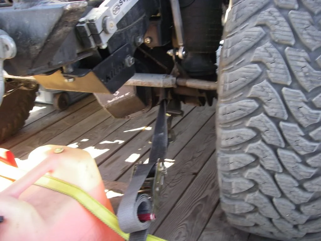

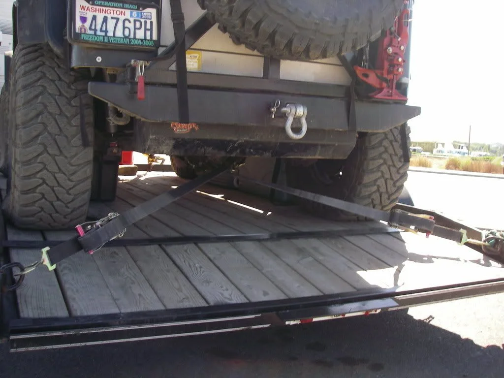

I've got a set like this one from Poly Performance and the straps work great and I've been using them since 2006. Just now thinking about getting a new set.
Poly Performance 12' Ratcheting Tie Down w/ Integrated Axle Strap Kit | POLY PERFORMANCE
Do you like having the integrated axle loop in the strap? At first I thought I’d like it but then thought it might make the straps not as versatile for use on other things.
