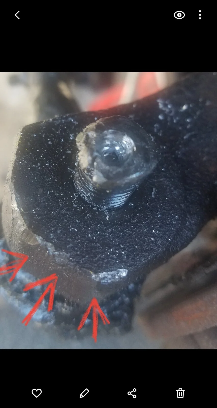

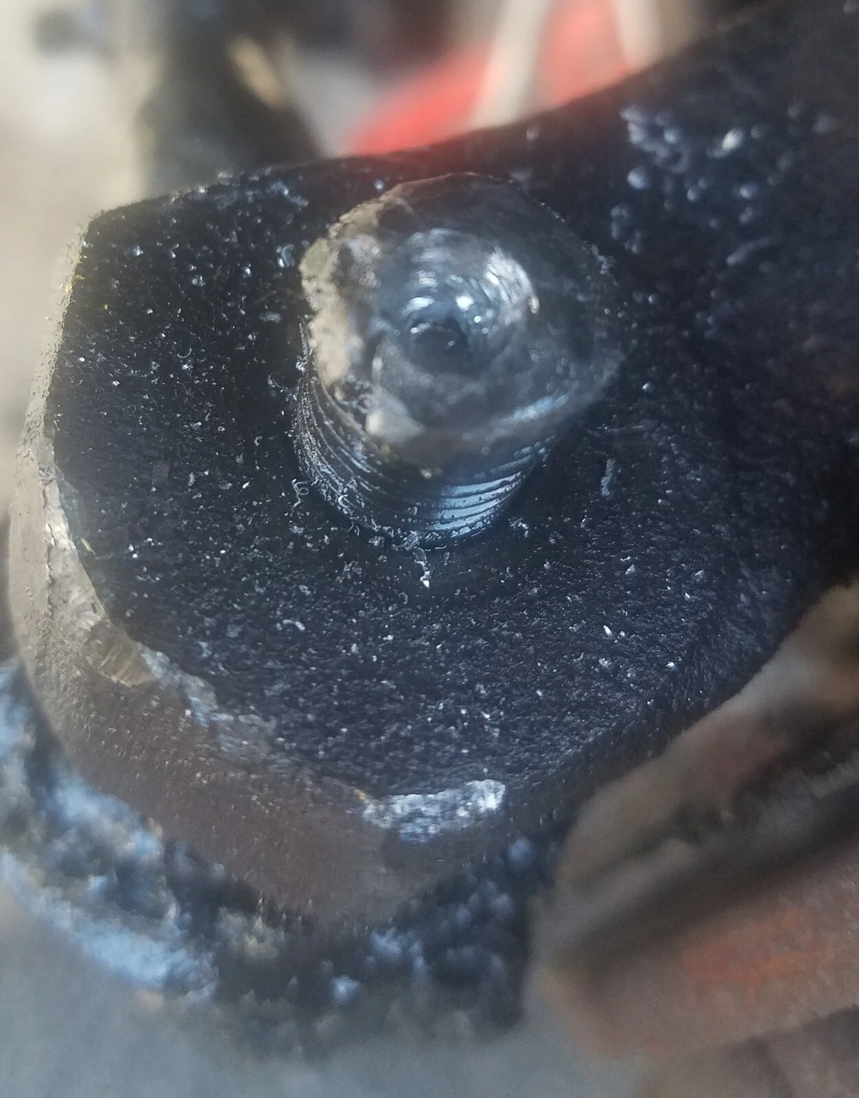

My left tie rod end is really, really stuck. I banged on the knuckle with a hammer, tried to pry it apart with a pickle fork, heated it with a torch, and used a tie rod puller (which in this use is actually a pusher). Along the way I applied plenty of penetrating oil. Nothing had any effect except for the puller which completely destroyed the top of the bolt due to the extreme amount of pressure I was putting on it. The right side, by the way, came out quite easily as did the pitman arm.
So I've spent an entire weekend on this and I am lost as to what to try next. Anyone ever seen one of these stuck this badly??? Any ideas???
The attached photo shows the damage done by the tie rod puller. You can imagine how much pressure was applied to do that much damage. BTW, the hole in the center started as a tiny indent to center the puller bolt.
