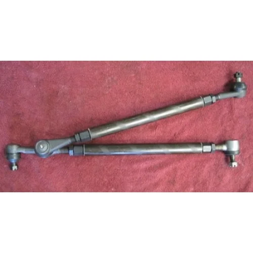

I went with the Currie Currectlync over the ZJ steering. I was having a debate about which one I wanted, and which one I truly needed.
The Currectlync is overkill for me, but I tend to like to go the 'overkill' route.
I'm REALLY glad I went with the Currectlync. The pictures don't do it justice. When you take off your stock steering and compare it side-by-side with the Currectlync, it's astonishing how much beefier the Currie system is. It makes your stock steering look puny.
One look at the Currectlync and you'll see that it's pretty much indestructible unless you're the most hardcore of hardcore wheelers.
For me, I only use my TJ for occasional wheeling, it's not a dedicated crawler by any means.
The on road manners are better than stock (honestly) and it really, really tightens up the steering in a good way.
I do not regret this upgrade one bit, it's money well spent.

Ruffstuff 1Ton TJ upgrade (need to ream the knuckles though). Also, ZJ upgrade here no stabilizer , here with stabilizer ( both new 12 month 12K mile warranty).
Currie Correctlync® for $529.00 shipped. PM to order Currie.

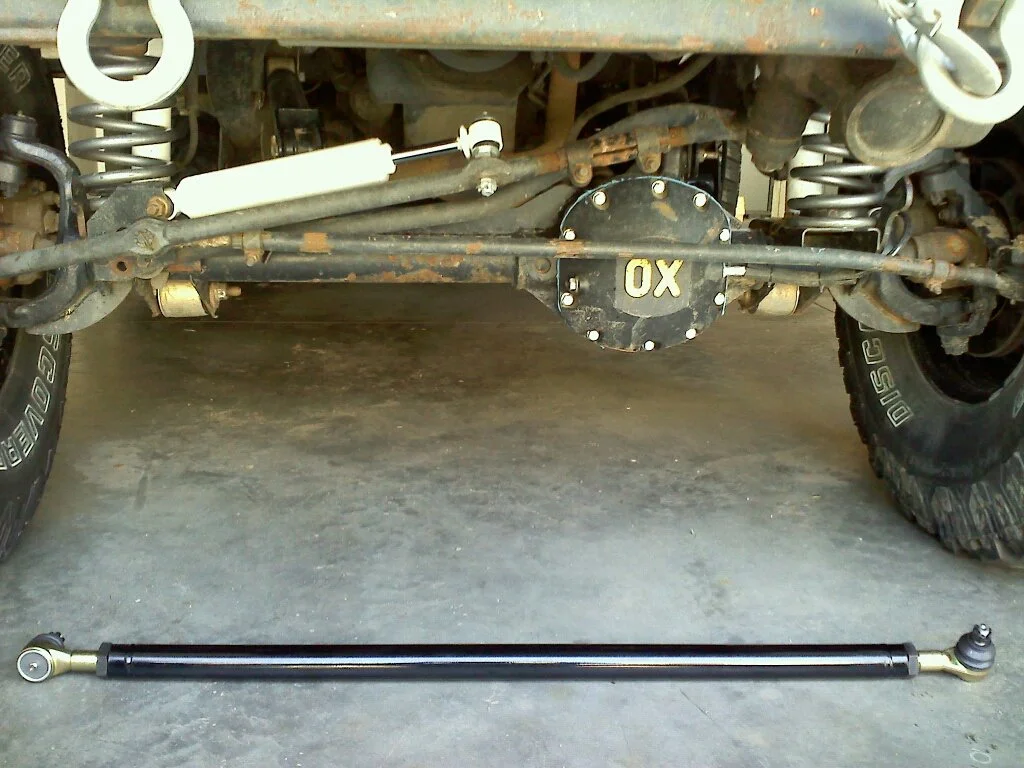

I would hope so. The factory tie rod is like that, Currie's kit is like that, the ZJ tie rod is like that, etc.
Yes but with a hex nut and an adjustable wrench. :)
Reactions: mouth and Chris
I dunno but I don't need a wrench to turn my tie rod or drag link adjustment link. I put a dab of antiseize on the threads when I installed them so they don't seize up and require a wrench. The factory doesn't do that with the OE tie rod and it can be a booger to turn but my Currie doesn't require a wrench to turn them to make any adjustments. I only need a wrench to loosen the clamp nuts.
