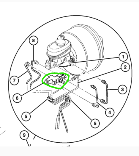

I just ordered the master to booster seal, the two reservoir grommets and a new cap. Those were the only soft parts above the hardlines that I could decipher from the schematic.
So I think I just need soft lines (need to measure mine before I order) and the seals for the rear brakes and anything else in the calipers that needs changing.
Can anyone point out where the o-rings for the Proportioning Valve are? I'd like to order new ones but I can't identify them in the schema.
when you say inside, do you mean where the hard-lines attach? or somewhere deeper inside this manifold?
Hard lines are inverted flare. The o-rings are inside on the shuttle valve, the proportioning valve piston, and inside the prop valve piston cap. If it has a rear port adapter, it also has one between it and the block.
