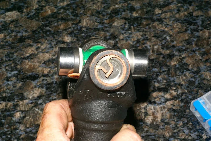

Here's the pix thus far:

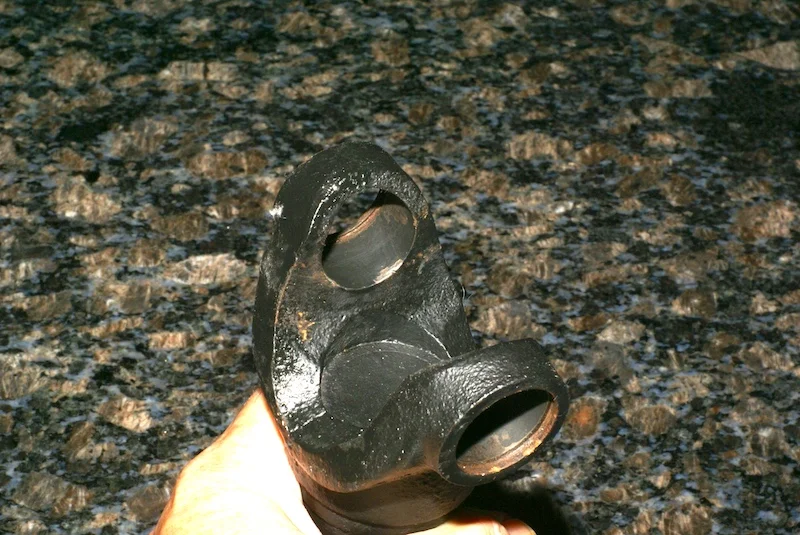

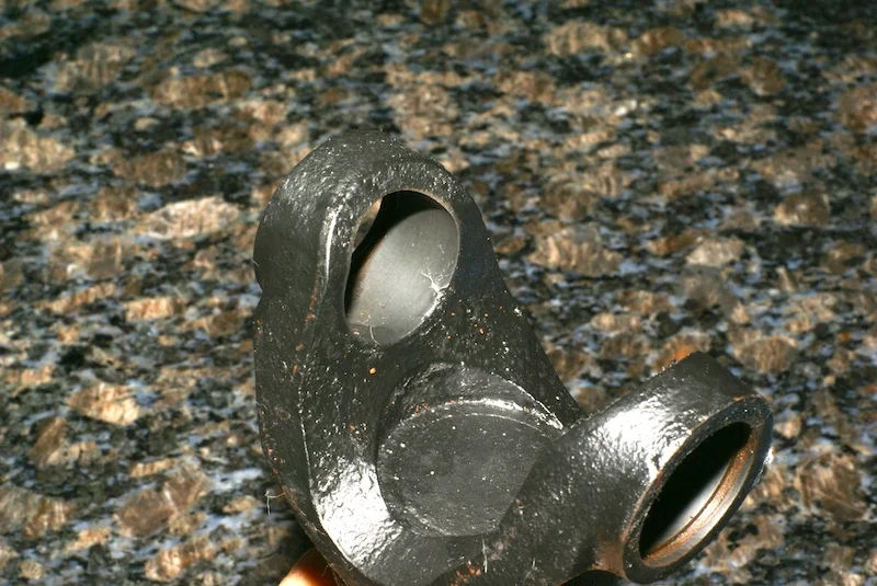

Bunged up from somebody's screwdriver at the 5 and 7 O'Clock positions. Both sides had this problem. Ignore the white that looks like a crack - that's from a cleaning pad. Maybe the old carrier hung up on this when pressing it out and tweaked the ears?
I filed off each bunged section.

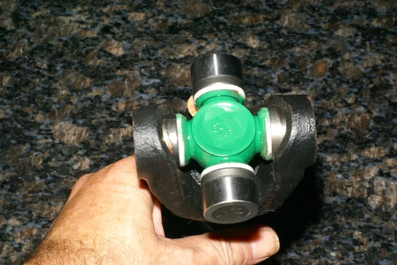

Here it is installed. Yes, that's a plastic end washer from one of the "other two" that fell out when I knocked it off. Its now back in position and all needle bearings are fine.
Snap ring installed.
Anyway, I went out and took it apart again - which was SUPER easy now. All needle bearings are where they belong, all looks well. Should I attempt to re-assemble? Or should I try to beat the ears apart before doing so? Or what...?

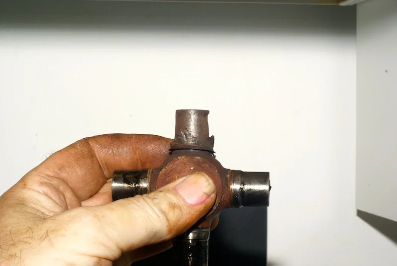

True enough, just like it did this time. I don't know if you saw it or not, but here's the pix of the old joint:
It had managed to slag down the needle bearings, melting them into a kind of metal sleeve!
Its now back together again, and I've convinced myself that it'll be OK. It didn't tighten up until the very last taps to get the 2nd snap ring in place. That tells me that the tightness is coming from the nylon thrust washer in the end of the carrier, not from a misalignment problem. The nylon washer will wear in to where it needs to be.

No sound, just vibration. No grease, just iron oxide dust and that melted into a sleeve bearing assy.
