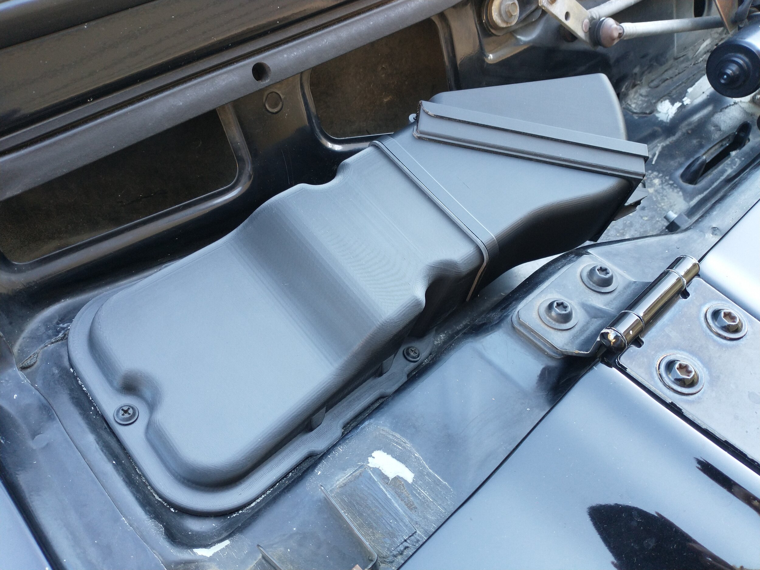

Or just install one. I just picked up one of these, it is local for me. This is great for those dusty conditions, that sometimes leaves you choking.
Install was quick and since the filters come in a 2-pack, I've got the next change already on hand. I did use longer s/s screws though, 1"- #10. The OEM duct did not fit over the top of the filter in mine, it may on yours. But it's not really needed anyways.

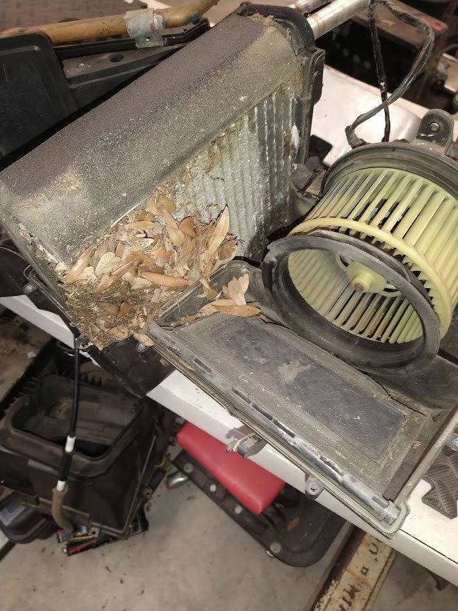

It may not keep the interior clean with the doors off but it probably does a decent job at keeping dust out of the ductwork, HVAC box, heater core and evaporator, which isn't a bad thing. I recently changed the one in my pickup and was appalled at all the junk that fell out and would otherwise just be trapped in tbere forever. I even got a noticeable boost in the air output because of how many leaves were in there.

Not to take anything away from his design, but I'd be a bit careful when washing your Jeep, especially with a pressure washer. I'd bet the filter will get wet, at the least, if you hit the windshield and cowl area much. Might suggest some thin foam tape between it and the cowl panel for a better seal.
While more complicated, there is a reason I designed mine the way I did.
I figured I'd try to retrofit the factory shroud over this one but if it doesn't work out I'm only into it $25. I'm open to superior alternatives.

I might be biased, but would take exception to that, both sealing and usefulness. While only a few months installed, I've had evidence of neither water or dirt leaking. Some people might use their HVAC regularly, Jeep purpose and use varies greatly.
