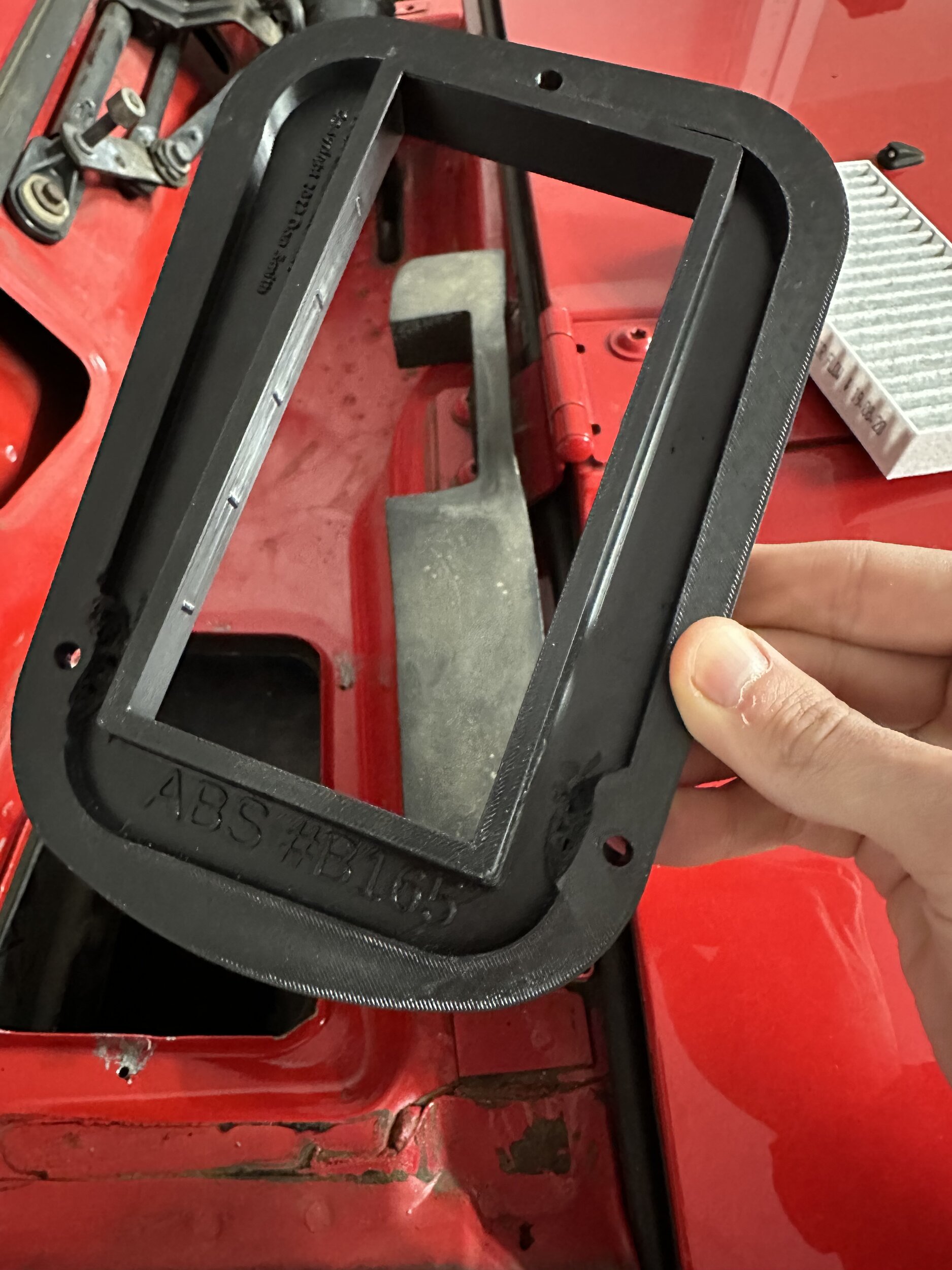

Shameless plug: I put up a guide on how to roll your own cabin filter together with the later intake setup here.

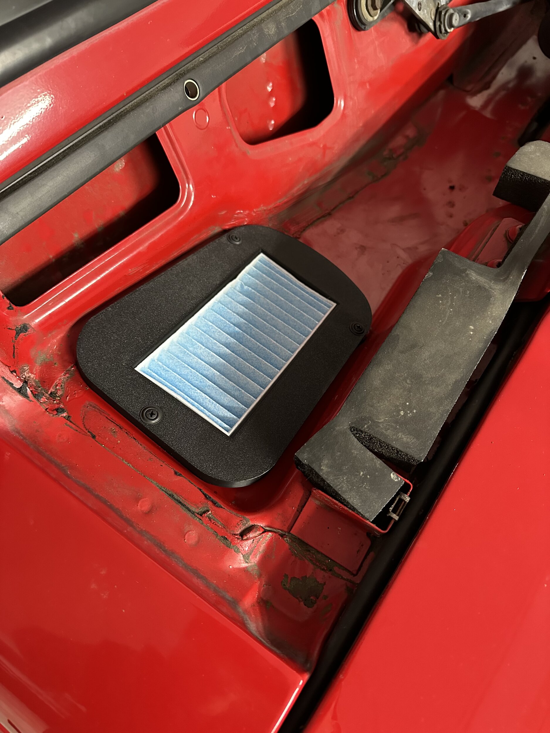

I was able to adapt the kit being sold on eBay for 2002+ TJs to fit my 1999. I took a dremel to some of the additional molding around the screw holes in order to get it to fit relatively flush with the vent opening. @chili_pepper I like your design quite a bit in that it certainly seems much more water resistant. Let us know if you ever plan on selling a version of it.

If you know someone with a 3D printer capable of printing in ABS, you can download the STL files for free from my domain. Zip password is "WTF". I only have one printer, and while it's pretty quick, I couldn't produce them in any serious quantities for sale.
For anyone with an older TJ, I'd be interested in knowing the measurements of the hole in the sub-cowl, relative to the screw holes (assuming they are at the same location as later models, and it would appear from the modification above that they are). I could develop an additional air plenum part design to accommodate earlier TJ models and include it in an updated zip for download.
Did you drill the screw holes or were they there already?
