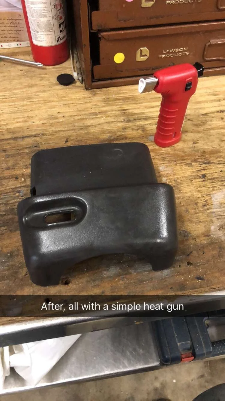

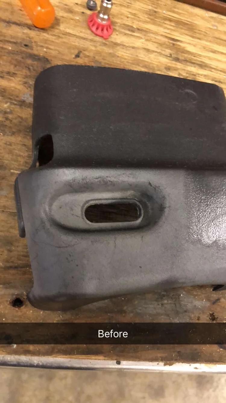

I don’t have a heat gun so I used a little mini torch. I don’t have picture of doing flares but here is the trim around steering column. It’s not perfect but is no longer an eye sore. View attachment 78450
How do you take that off?! I want to do the same thing but it seemed difficult to get off...
