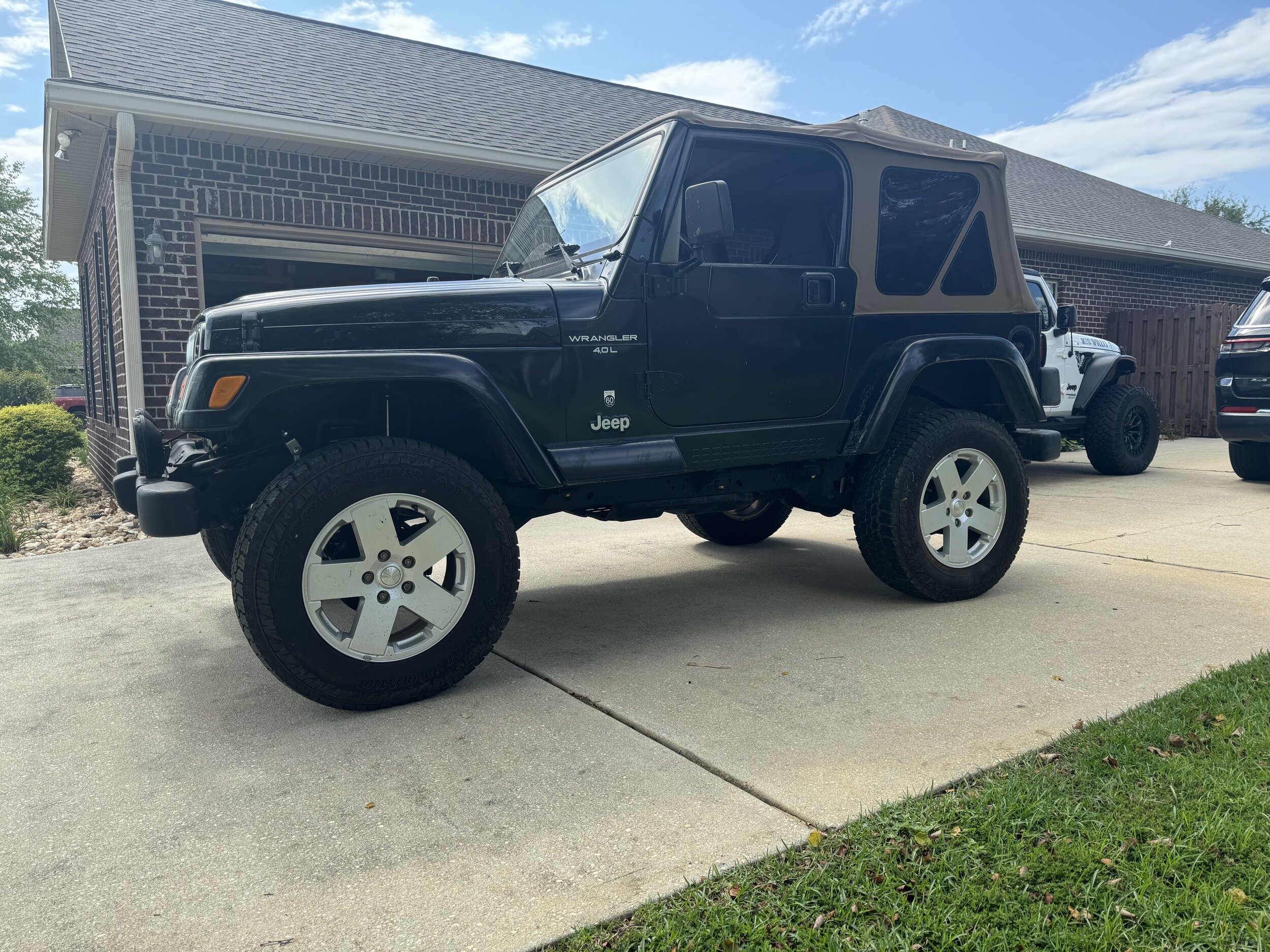

I recently picked up this 2001 TJ Sport for my son who is turning 16 soon, Dana 30/Dana 44 with 3.73 gears, 5 speed, 4.0l. We put a Zone Off-road 4.25” combo lift. The previous owner has these 18” JK wheels with 32x10 basic AT tires. I have a 2022 JL with Nitto Trail Grapplers and my friends and I go wheeling in the NW Florida area. Mostly sand and mud, but the mud can vary between clay, sandy mud, or your typical sticky black mud. I’m trying to decide which route to take with his TJ as far as a Mud Terrain or a new hybrid RT tire. 15” wheels really limit the RT options, but of course going with 17” wheels really opens up the options. I’m not against going with 15x8 and a good 33x12.50 MT, but since it’s of course my son driving, my top concern is on-road safety, but I want him to be able to come out on the trails and not be limited in the mud and end up stuck more often than not. Seeking the advice of this forum. Thank you
