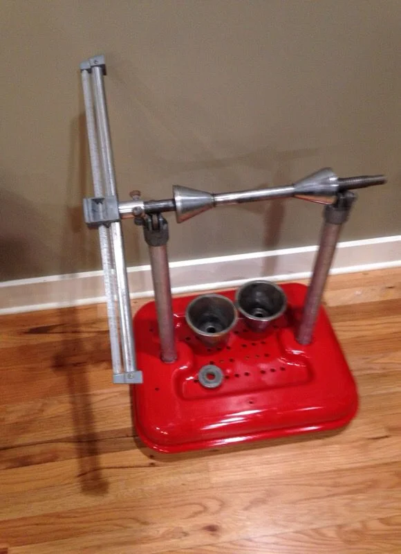

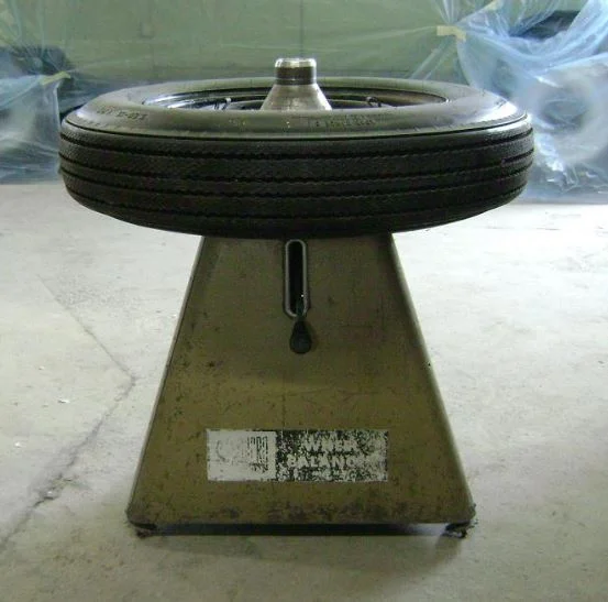

Old thread but interesting. I used to do a lot of wheel balancing back in the late '60s to mid '70s while working at my Dad's garage during high school & college. It was next door to one of the largest British sports car dealerships in the Toronto area and believe it or not they didn't do any wheel & tire work. We did it for them. The best part was that we got to test our work. I drove everything from MG's to Jags and even some Lotus' and Jensens. It was pretty neat for a kid my age.
The equipment was pretty simple and crude compared to today. We went from bubble balancers to beam balancers and eventually roller balancers like @Squatch described. The thinking with the roller balancers was that we were balancing the hubs, drums, discs, etc. too. We thought we were cutting edge. 🤣
Not the ones we had but pics of what they looked like ...
View attachment 207394View attachment 207395View attachment 207396
It's like a trip down memory lane... :)
