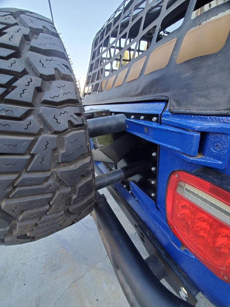

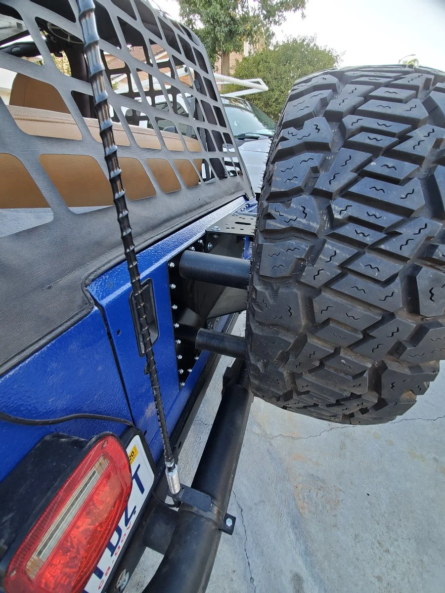

I had an exogate on my 99. Just make sure to space all the rubber stops out to the tire. I did the 2 top ones and the one just above the bumper. No rattles at all.
X4
I just added snubbed extenders and made my own reinforcement plate. Works like a charm with my 33x12.5's
