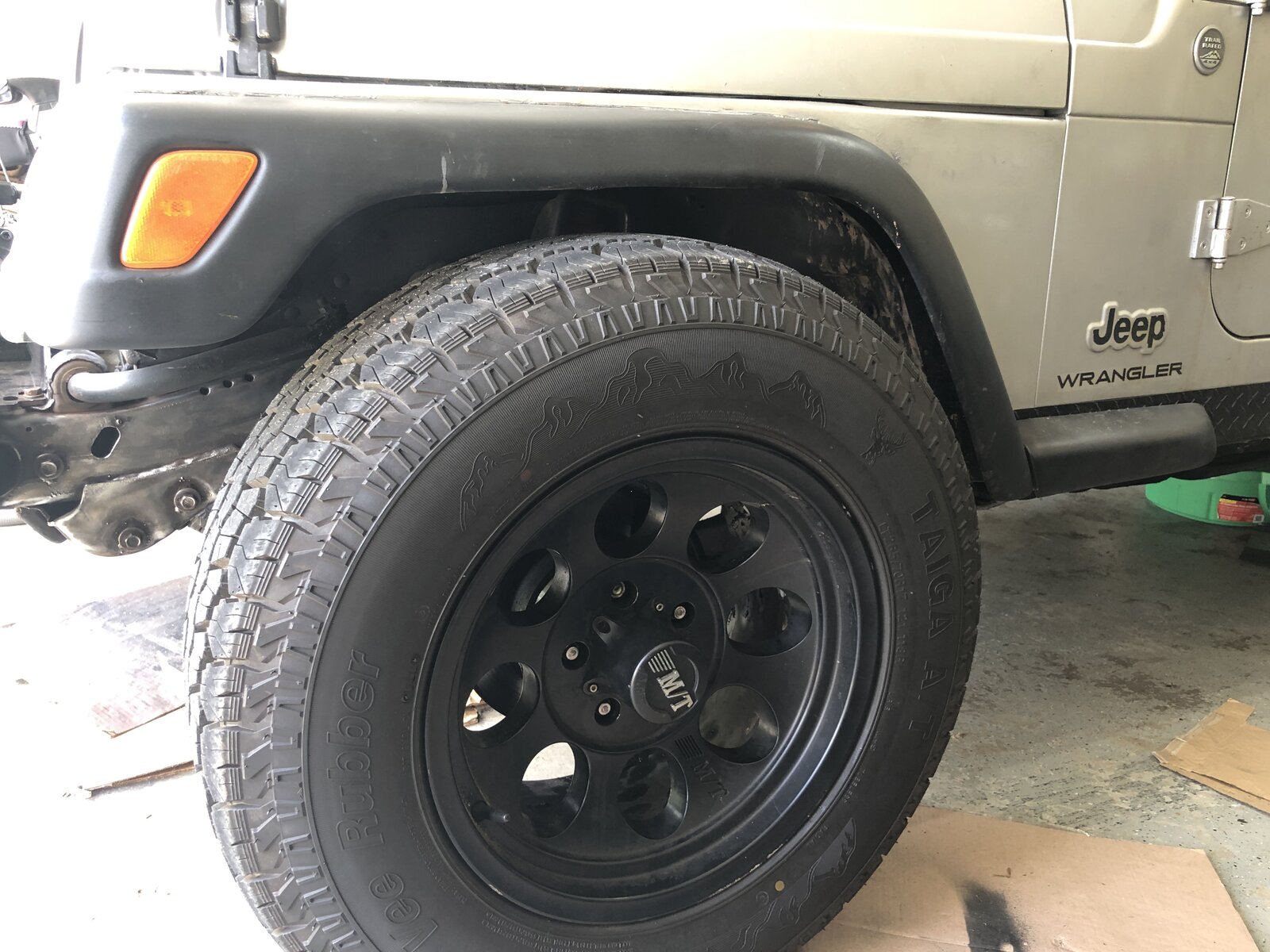

I have recently put 31” tires on my 06 and other than Rancho 5000x shocks, it is stock. I don’t like how close the fenders are to the tires, especially in the front. What are my options other than a full suspension lift? I really don’t want to have to swap out my Rancho shocks either. Thanks.

Your stock springs must really be sagging if those are only 31s. This is stock with 33s and has the same clearance.

How would I know if my springs are bad and are sagging too much? The Jeep has 244,000 miles on it and as far as I know the springs are stock.
Front springs measure 12" and the rear 8" as the Jeep sits on level ground. Anything less is sag. I'm guessing yours are 11 and 7 or worse.

I just measured and the front is 11" and rear is right around 8". If I'm going to replace the front springs should I just replace the rear as well? How difficult are the springs to replace as "DIY"? Thanks!!
