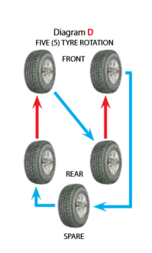

Tire rotation
Since I’m retired & don’t really even have a daily driver I don’t imagine that I would wear out the treads before they “age out” (6 years is my limit for risk tolerance)
Six year limit? You would really hate knowing that I just replaced some '07 date coded tires. They got a little too stiff for my liking. Also, I need you to buy a set of KO2 in 35x12.50x15 and remind me in six years that it’s time for new tires. ;)
On a 4-tire fronts cross back to rears and rears straight to fronts.
