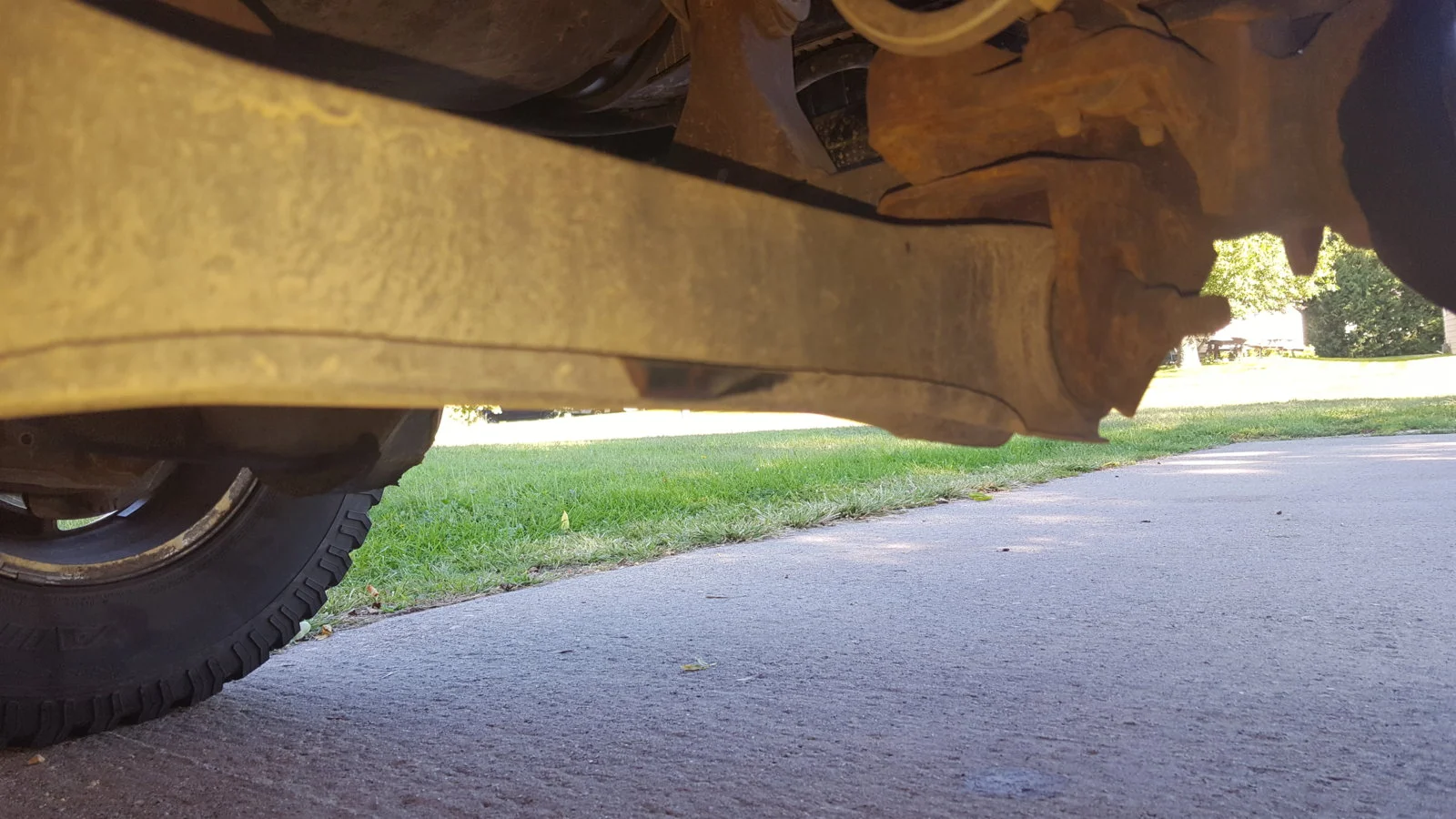

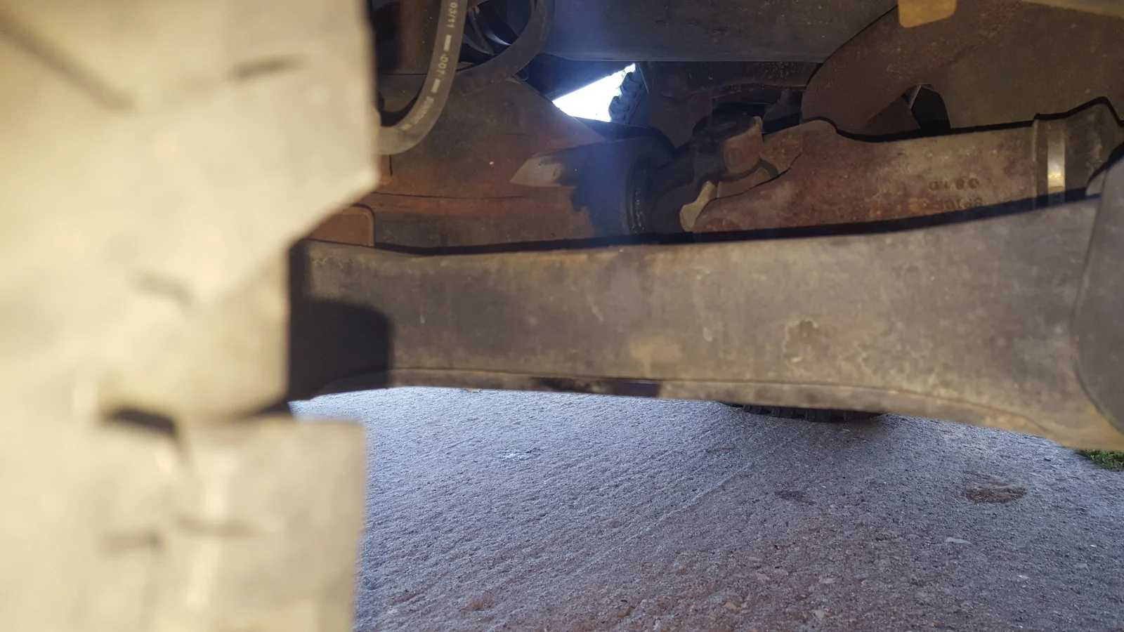

I was looking around under my Jeep today. I noticed a something that I can't figure out. I have, what I think is a tire rub mark on each side. The spot is in the same exact spot on each side, but I didn't see any marks on the tires themselves. I had my son turn the wheel to full lock, while in park. The tires were not touching anything and it seems there is plenty of room in there. Sometimes when I am in motion, and turn the wheel near or full lock, I hear a rubbing type sound & the steering wheel shakes. This does not happen all the time however. Would there be marks on the tires if they were rubbing? The marks on the arm (sorry I don't know what it's called), are fairly deep, I can feel a definite gouge in the steel. I have 31"x10.50" tires on stock Canyon wheels. I have read that other Jeeper's with the same size tires have experienced tire rub, which spurred me to check my situation. Is this bad for the tires? I can't imagine them rubbing on steel would be good.

That is a super common rub spot when running larger than stock tires and not enough back spacing. You can add wheel spacers, get new wheels with different back spacing, or ad some washers to your turn stops like @StG58 did.

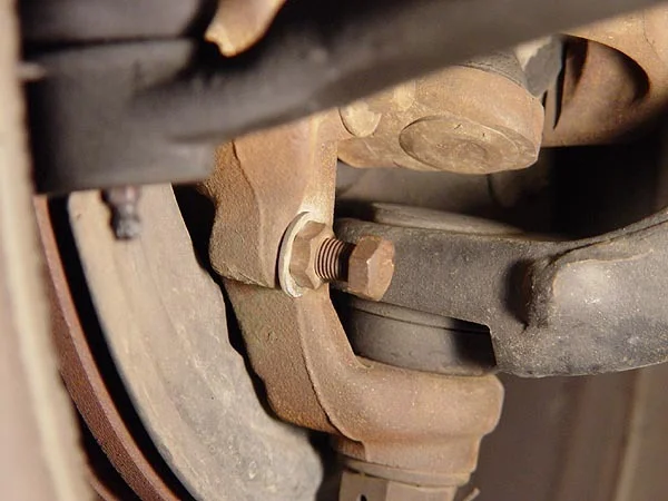

Here's where the steering stops are.
The adjustable part is a bolt with a nut welded to it. Put a wrench on the NUT to loosen and remove. Use lots of penatrant and give it time to work.

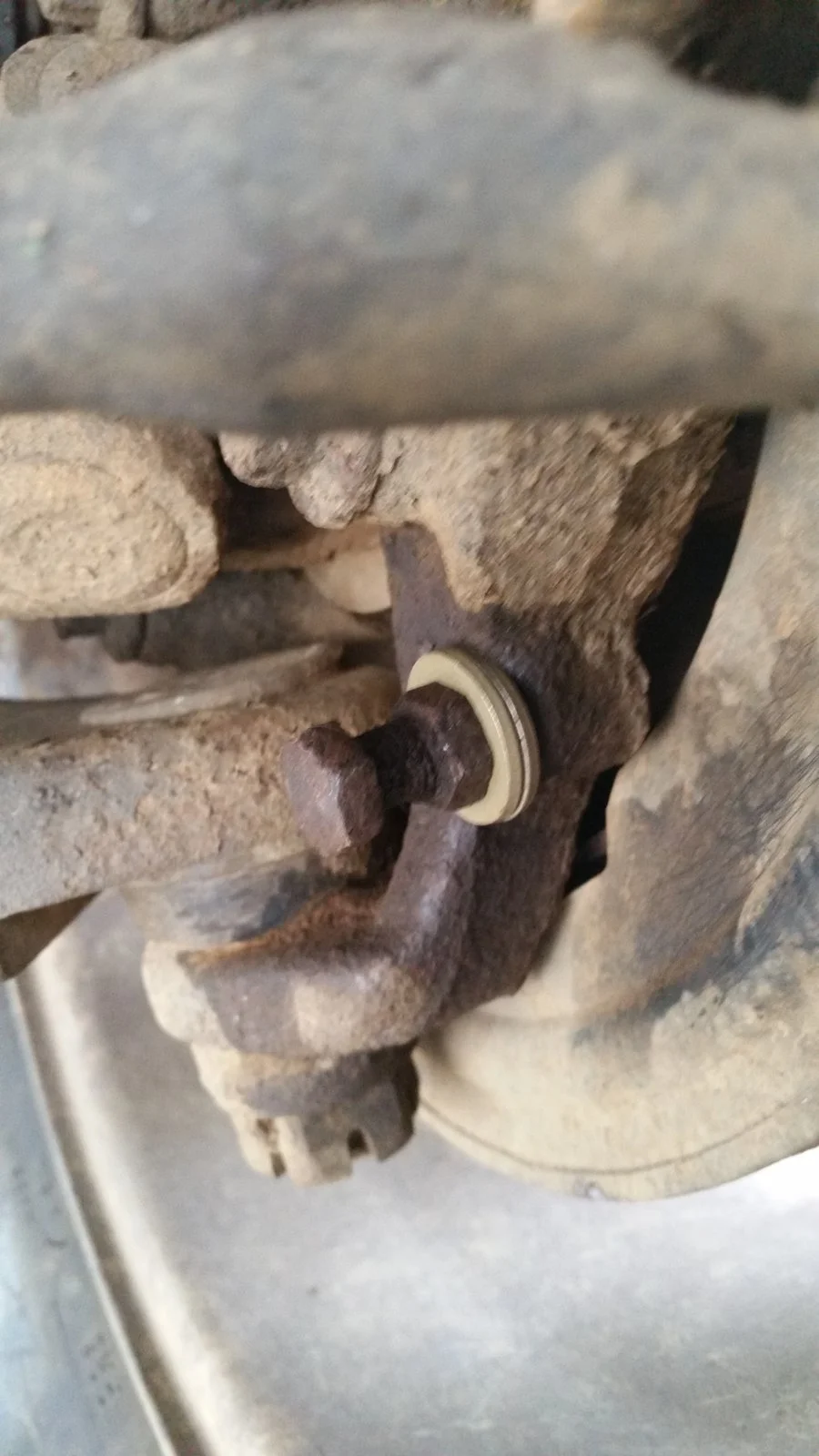

This is one of mine with two washers under it. I have Grizzly wheels and 31x10.50's. Depending on the amount of "slop" in your front end, you may still rub a slight amount at full lock in reverse or in forward. After crawling around under my stock TJ and playing with the stops, it's apparent that the best fix is new wheels with proper backspacing. A lift isn't going to appreciably change clearance between the tire and the LCA.
Another item to note: putting a taller tire on changes the scrub radius. The center of the contact patch is moved in from center of the "kingpin angle" on the pavement. You can hear your tires scrub on the pavement in a tight turn. That may or may not be a major issue leading to increased tire wear. Again, correct wheel back spacing would help.

That welding is just where the factory welded the nut onto the bolt which is normal. The steering stop bolt still unscrews so a washer or two can be added underneath the nut like shown below to stop tire rub when the steering wheel is turned all the way left or right.
You can't see the factory weld on this photo, it's on the back side of the bolt.

That welding is just where the factory welded the nut onto the bolt which is normal. The steering stop bolt still unscrews so more washers can be added underneath like shown below to stop tire rub when the steering wheel is turned all the way left or right.
