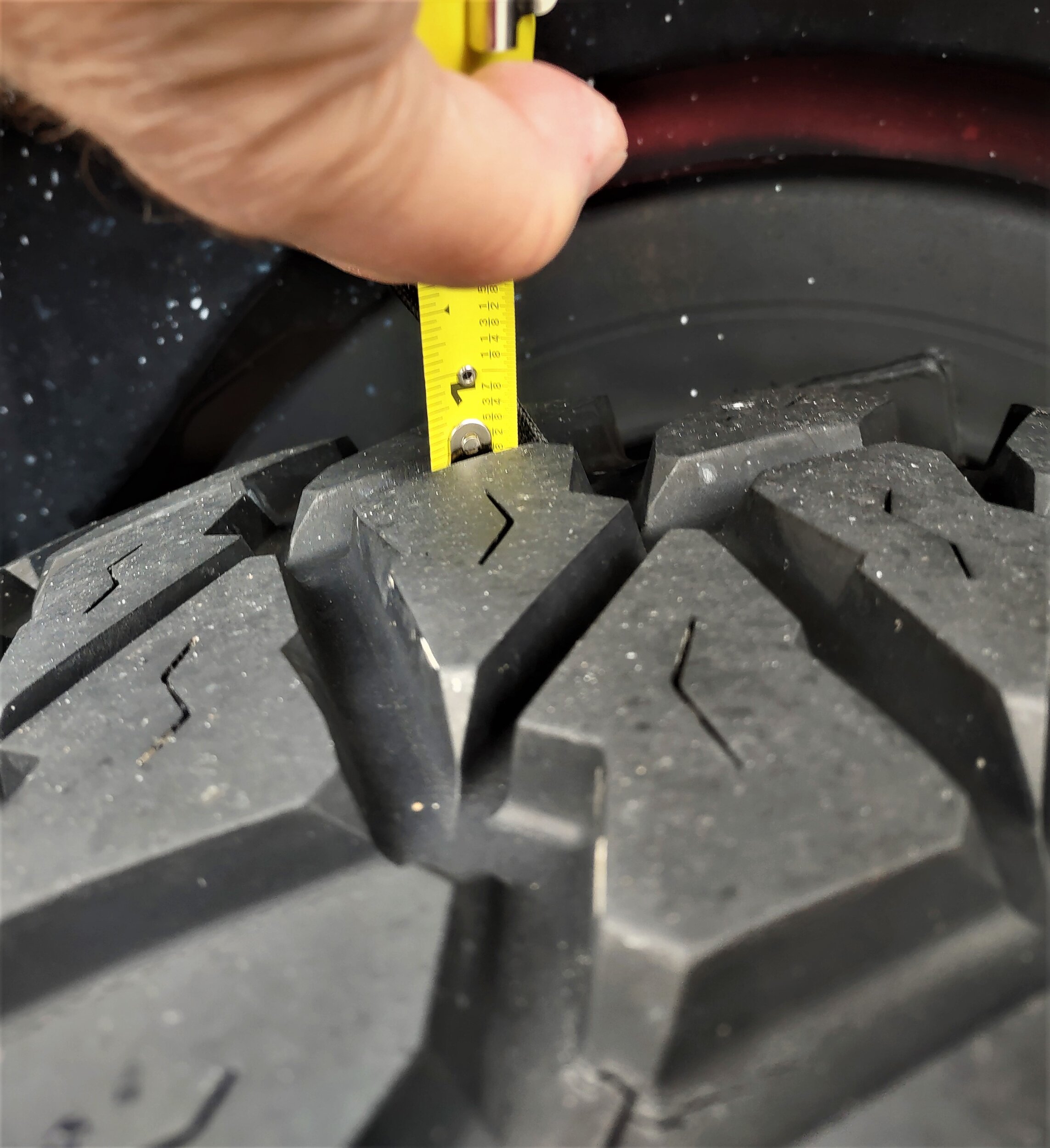

I've had an issue lately where I get fairly bad wheel vibrations, tire scalloping on the front, and shimmy at 75/80 kmh (used to be full dw but I replaced the lower track bar bushing). I tried taking off the front wheel weights and putting 10oz of balance beads in the front tires as I know m/ts don't hold their balance too great (cooper stt pro 35x12.50r15).
The vibes seem to come and go every 15 second or so and you can feel almost a hump at 35kmh. Is it just tire balance, or would bad shocks or alignment cause this?

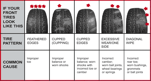

Sounds like a balance issue. What tire pressure are you running? I did a DIY alignment 7 years ago and haven't touched it until I recently replaced my tie rod/drag link. Tires were Road Force balanced when I installed them 7 years ago. 30,000 miles on them now. Perfectly even tire wear, but small cracks from age (10 years old). I run 25 psi.

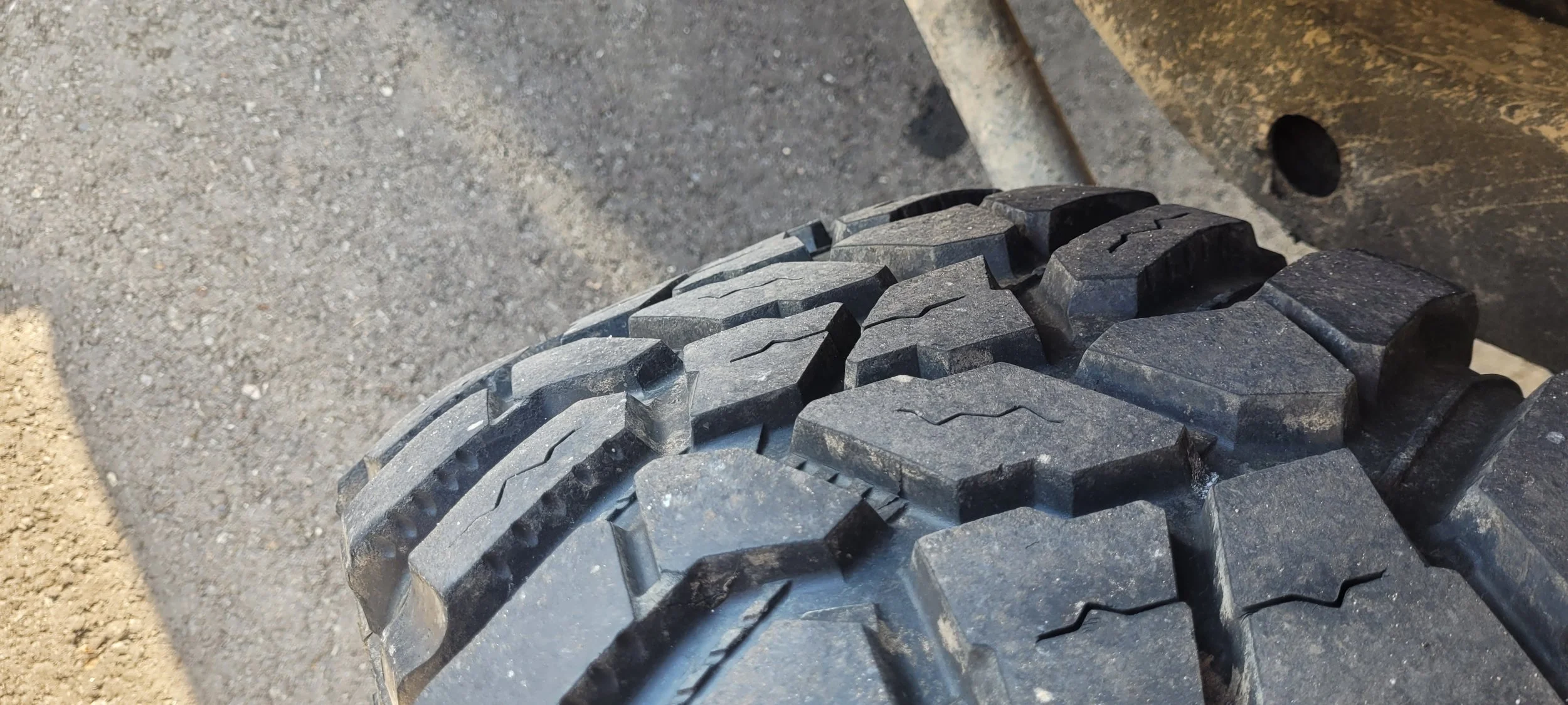

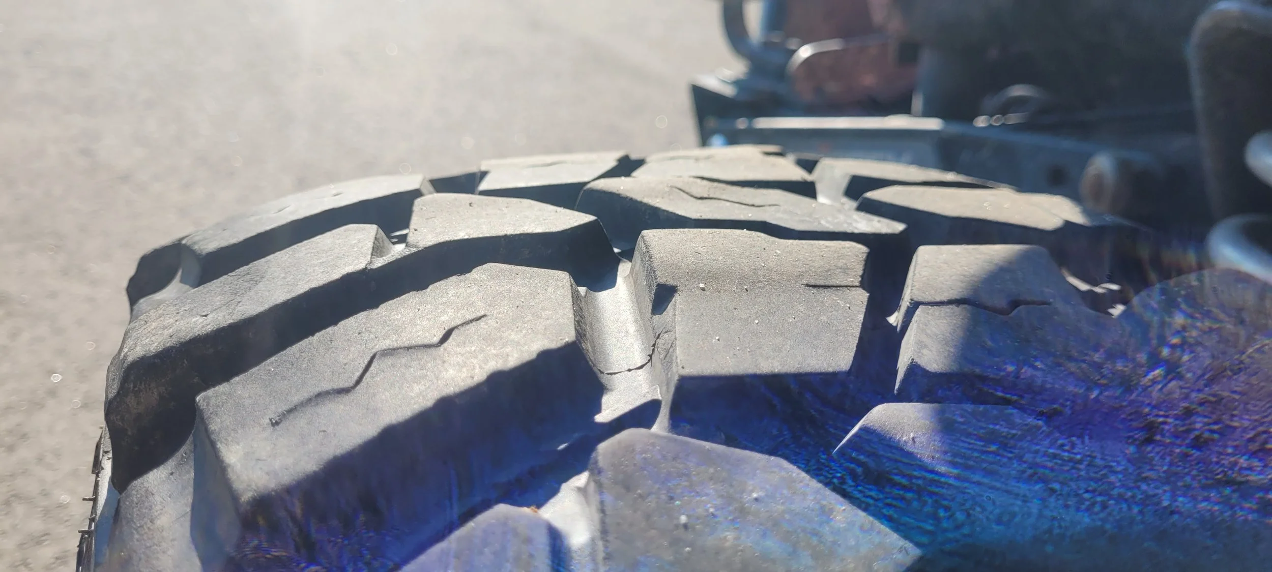

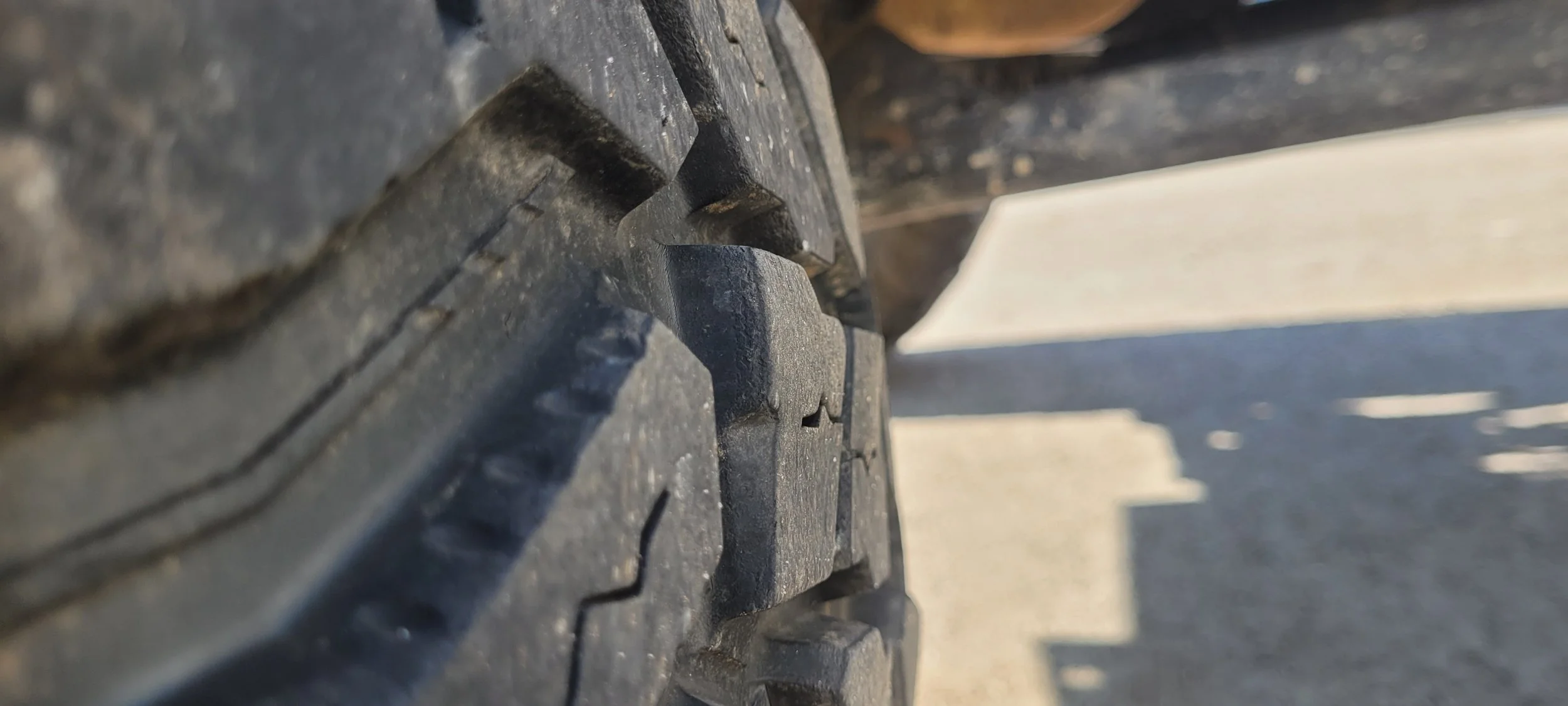

The cupping is weird...the front of the tread blocks are way higher than the back as you can see in these pics

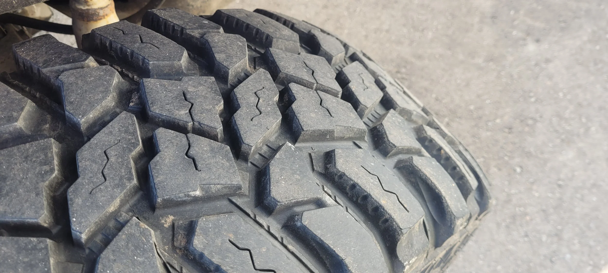

Compared to the rear which has even wear
Do your dry steering checks, have balance checked, check ball joints, check your 'alignment', and check shocks.

The tires aren't going to fix themselves and start rolling better.
At some point you will have to put the rear (good) tires in the front and hope that you've fixed the problem.
