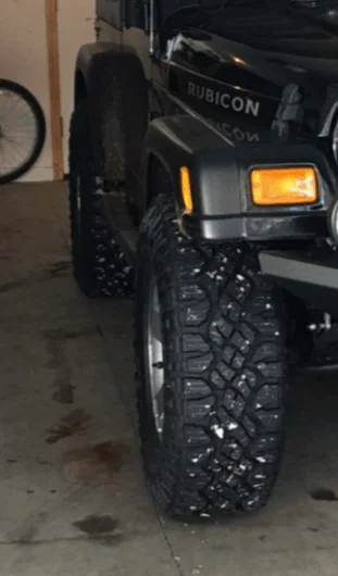

So based on this pic of Chris' old rubicon (285/75R16 with 16" Moab's, 5" BS):

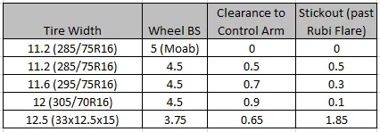

I came up with the following table (also used that fact that he said this combo just barely touched the front control arms at full lock):
Based on this, we are leaning towards 16" wheels and tire, even though they are D&E rated, so that they are tucked better... Unless someone can point me to some 15" wheel options with 4.5" BS and maybe some 11.5-12" tire options in 15"...
If anyone sees any problems with my math, please let me know.

The only real problem I see with your math is that the numbers are largely hypothetical because tire width varies from tire model to tire model, the particular tire pressure used, and a myriad of other factors which renders it unlikely that a chart calculated to 0.01" or even .1" would translate to the real world.
I think you need to focus on which wheel/tire attribute is most important to you: (1) escaping negative scrutiny by Massachusetts state vehicle inspectors or law enforcement personnel because your tires aren't fully covered by your fender flares (which can be easily solved with wider flares that are removed and replaced with your stock flares after the inspection if you choose), or (2) tires you like that fit on the wheels you like that don't rub where you don't want them to rub.
