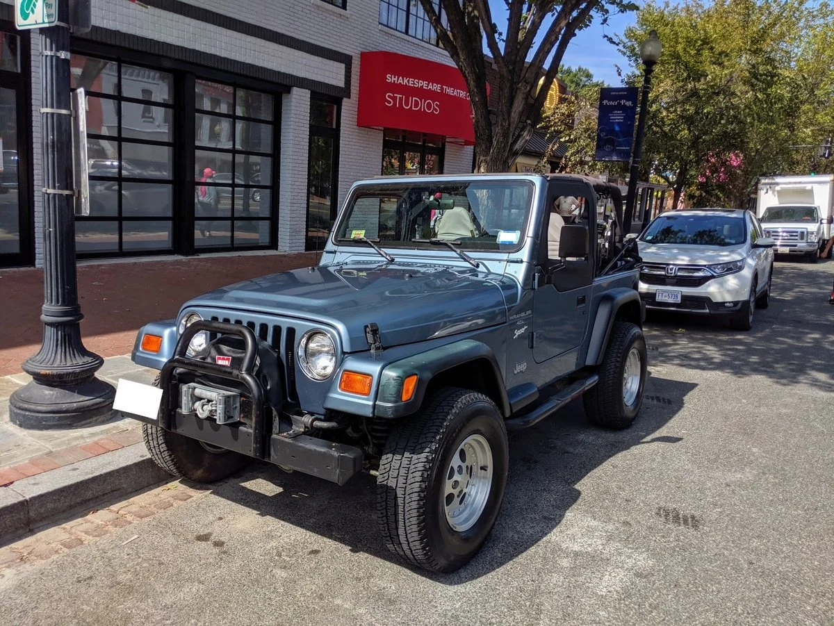

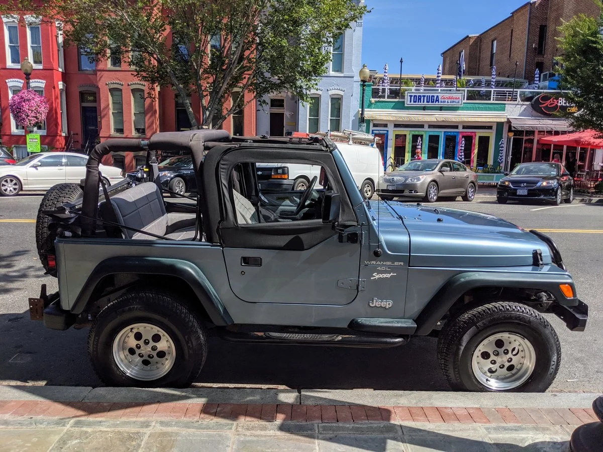

Hello!
I have a (convoluted) problem similar to this thread on narrow tires. Please let me know if you can help me figure out my options!
My '97 TJ has:
- a 2" suspension lift
- OEM gambler wheels (15x8; 5.25" backspacing; +19mm offset)
- 31x10.50 R15 LTX A/T Michelin tires
- 1.5" thick Synergy hubcentric wheel spacers
My problem is that:
1. I would like to remove the wheel spacers
2. But I would like to keep the original wheels (if possible)
3. And I would like to keep tires at least 30" (31" if possible)
My off-road mechanic at first thought the spacers could come off without issue, but found that the wheels were hitting the inside of the lower control arms when the spacers are off. When I discussed options with the mechanic, they advised that I switch to wheels with different backspacing (no specific recommendations on what backspacing would work though).
I know that the spacers aren't necessarily harmful, but I prefer the look without them anyway. I'd also love to keep the original wheels, but not if it means having awkwardly small tires with my 2" lift.
Would narrower tires be an option? Or dropping to a 30" (again, would rather not drop tire size)?
If I really do have to replace my wheels, how do I know what backspacing to look for?
Photos attached - I appreciate any advice!

If it was me, I would see if you could mount some 9.5inch wide tires on it and see how they perform.
I wouldn't think you can see the spacers; and offset wheels are going to look the same as current wheels with spacers. Am I missing something?
Or...
You could try a smaller 1" spacer and see if you that gives you enough clearance, (and look the look you want}.
Thank you for the feedback everyone.
So it seems like the trade-off is:
- add washers to steering stops, reducing turn radius (is it really reduced enough to noticeably degrade performance on the trail?)
- spacers off and stop turning when I hear rubbing (isn't that also basically reducing my turn radius? so there's really no damage that could result from this?)
- or narrower tires - what would be the performance drawback there? (besides cost of new tires)
@LONGJP2 I'm probably the one missing something - If you mean that removing spacers but changing wheels would achieve the same effect - that's my understanding too, except that more people recommend that to me over spacer "risks." I love the oem wheels anyway, so that's why I'd rather use a narrower tire if that would work...unless 31x9.5 inch tires are bad idea for reasons I'm ignorant of.
