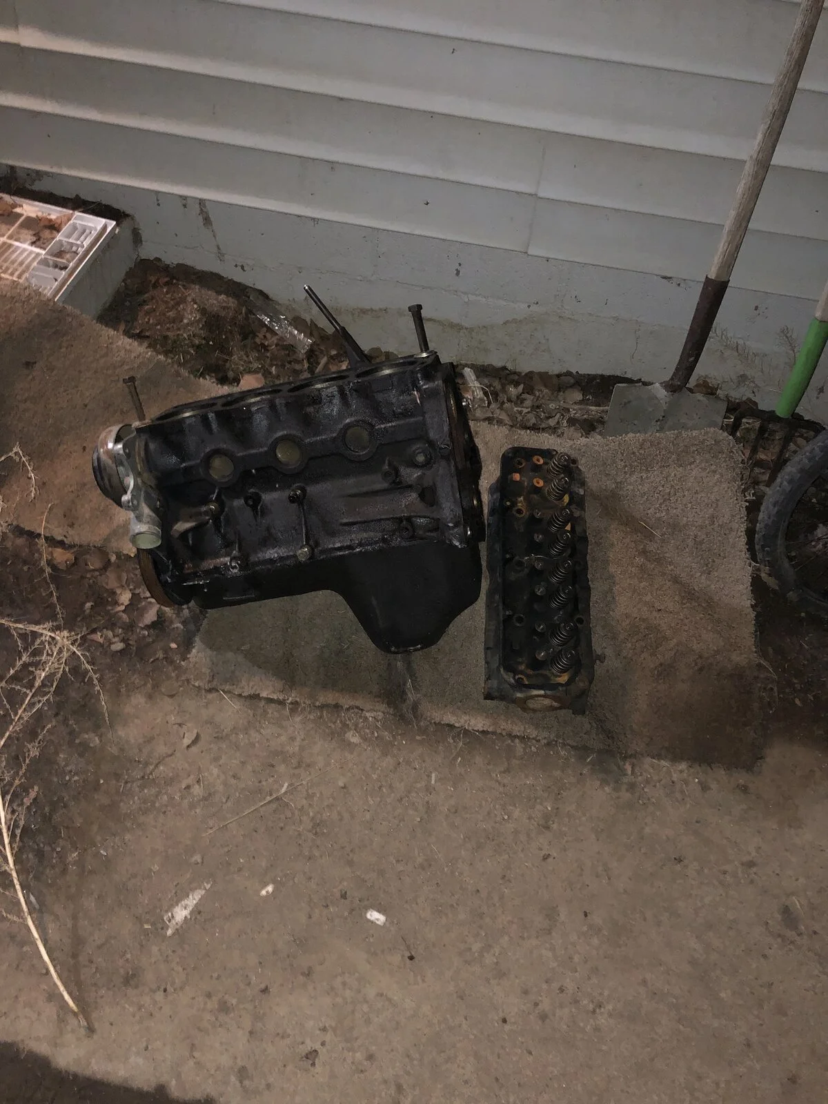

Welp, i took the first step to getting a new engine in my jeep. Just picked up a greasy old thing to turn in as a core. My plan is to basically just replace my engine, with a “brand new” remanufactured engine from NAPA know how. I will be adding to this with every step i take

Welp, i took the first step to getting a new engine in my jeep. Just picked up a greasy old thing to turn in as a core. My plan is to basically just replace my engine, with a “brand new” remanufactured engine from NAPA know how. I will be adding to this with every step i takeView attachment 223389
