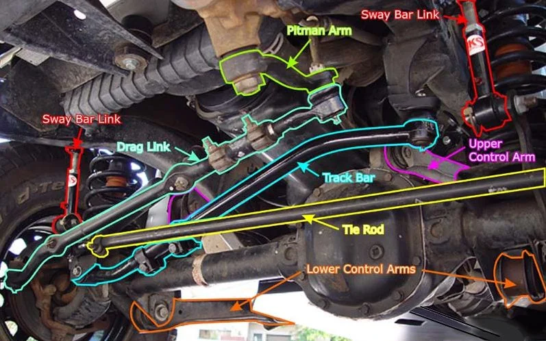

Take some photos of the front underside of it. Try to get a good photo like this where we can see all the components:

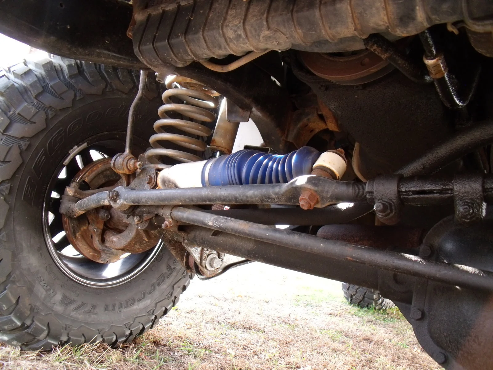

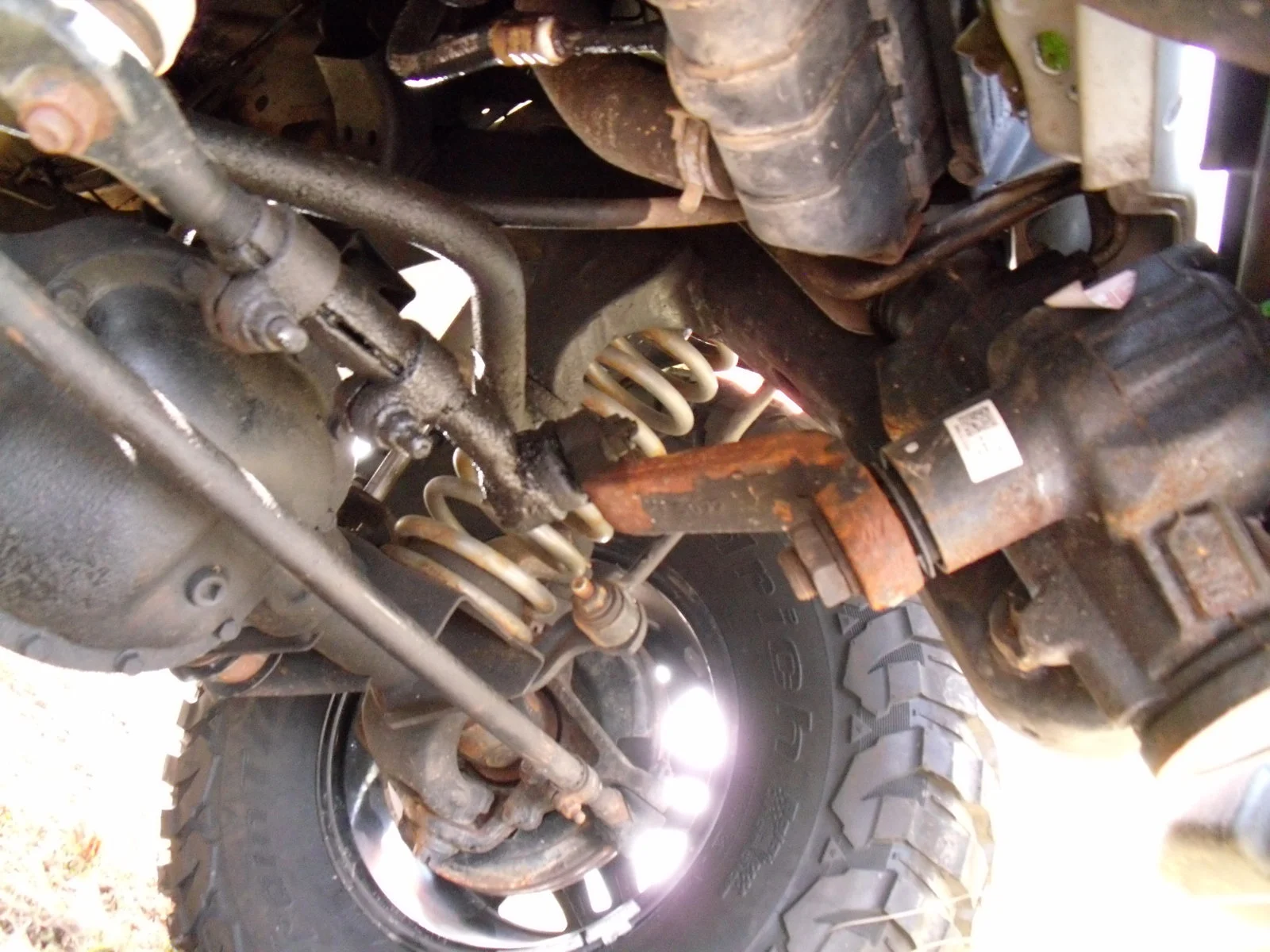

Okay, there is two issues going on there I see.
First off, someone has added a second steering stabilizer that is attached to the tie rod. That needs to be removed completely as it shouldn't be there to begin with and is doing no good.
The second thing is that you have a drop pitman arm which is more than likely the culprit as to why your steering is wandering (this is a known issue with dropped pitman arms).
You'll need to put a stock pitman arm back in place of it.
Thanks guys I’m new to the Jeep world so I was kind of lost on where to begin. And I will remove the second stabilizer. I also didn’t see the point on why that was added
Wow, how did I miss that? Must be my mind was actually on work, which is what I should be doing now instead on browsing here - shhh, don't tell on me!
I bet the previous owner added it because they thought (incorrectly) that it would help with the wandering.
When you remove one of those steering dampers, make sure it's the lower one. After you remove that and the drop pitman I would get a buddy and do a dry steering test. You can search the forum for more info on that test.
